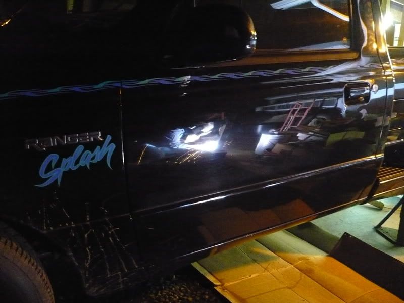

I spent the last 2 days under my truck getting a trailer hitch put on, and with a rollpan, it was no bolt-on affair. I had to cut and reposition the centersection on the brackets, cut and bend the brackets, drill the frame, cut my rollpan, and figure out how to hide a huge 7-way light connector because every trailer we own has one. I'm still working on getting the license plate set up to work with it. It will be mounted on a receiver plug to hide the hitch when not in use.
I've been working on the idea for a while, and this week I got some motivation to get it done. I'm going riding several hours away (east of Bend, 4 corners for anyone who knows) tomorrow, and I needed a way bring someone with me. Instead of paying the huge gas bill to drive a fullsize van and big flatbed trailer, I can now take our small trailer and my truck.
Oh, and I had to take the sawzall to my exhaust to get the hitch on....Its dumped right out the muffler now, and its quite a bit louder in the cab. Lightning-style side-exit is coming next.

welding that close to that new paint....:annoyed:
just messin. top-notch work as usual. one point of criticism, is the gap larger on the drivers side or is that just the angle of the pic?

If you mean the tape marks, yes its crooked in the pic. I found it and fixed it right after that. All worked out. I could show pics of "stealth mode" but it looks exactly the same as before I put the hitch on.
