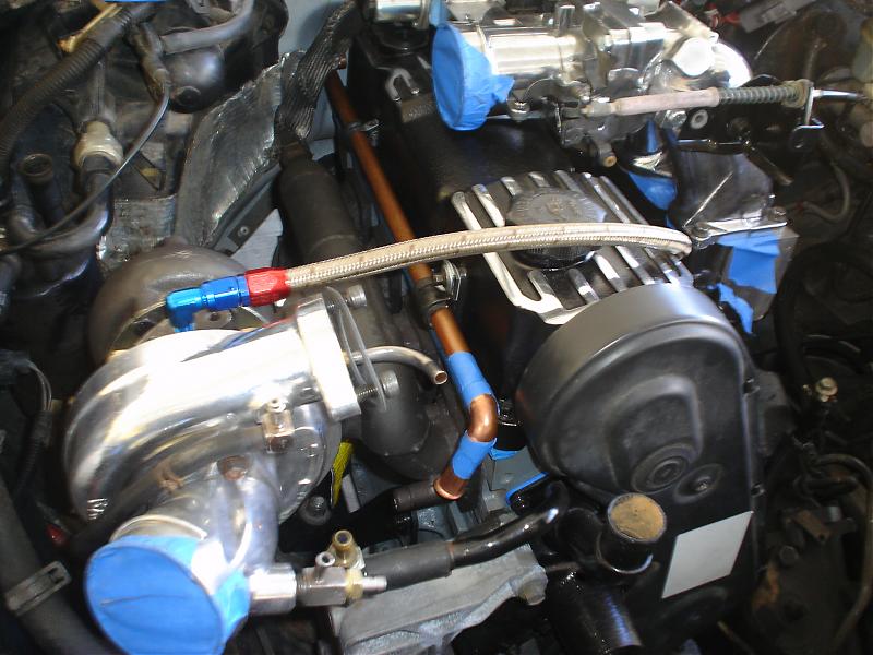

Scott,
Here is a quick picture of my work so far. I'm still working on the water lines and thinking about going to steel braided lines for the water, not sure yet.
Maybe I'll get it finished by the end of the month. It doesn't need much.

I'm using the DIS and moving the coil packs being that I'm using a flipped manifold. It's too damn hot in AZ not to have AC. The engine I have was built by DaveR. It is a dual plug motor with a added in oil drain hole, it has Weisco pistons, the Ranger Roller and the head has been ported and polished. It also has a 60mm throtle body and a worked over intake (1 of 2 by Dave). I'm going non-intercooled being that I'm keeping the boost at 7psi (for now). I'm using a modded MAF with 19lbs injectors. That about covers the basics.
yeah, you're putting the turbo where I mounted my coil pack, I modified one of the stock brackets they used in '89 to push it out a bit over an inch to avoid the coolant lines, still took some tweaking of them...
