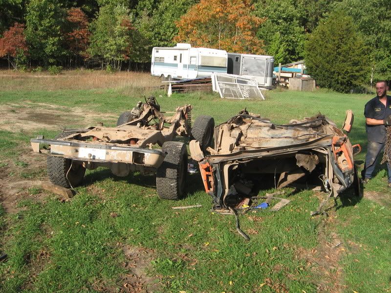

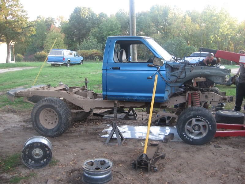

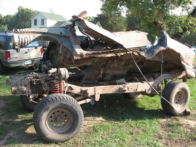

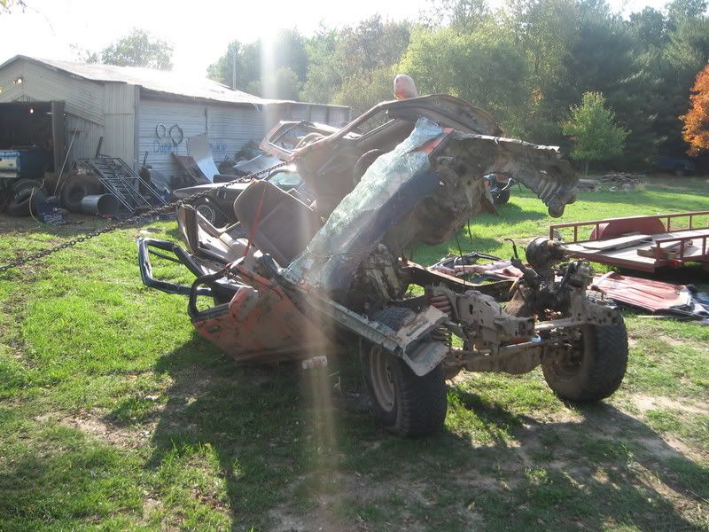

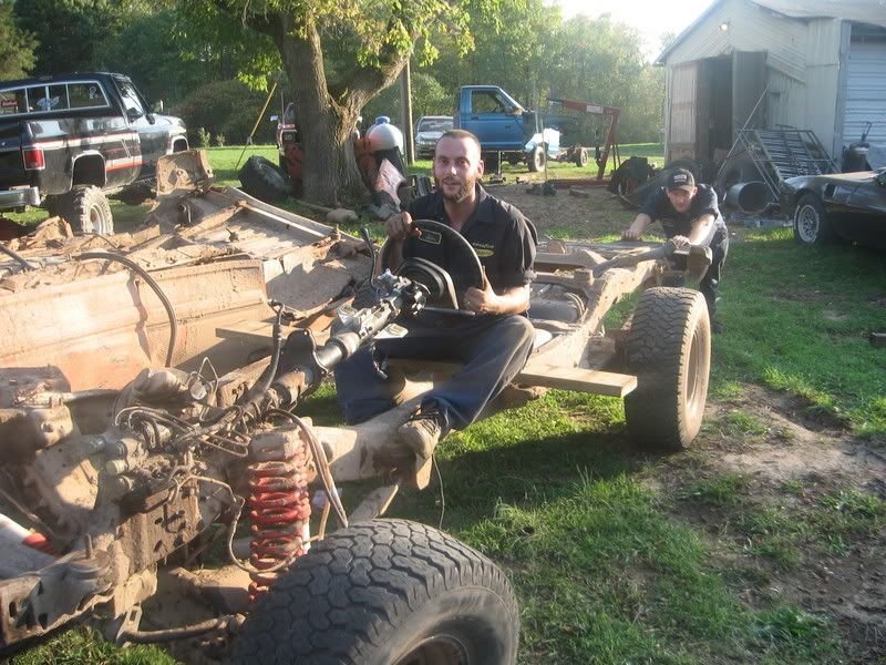

Friday night ran into the problem of the engine/TTB crossmember. So instead of swapping every thing into the ranger i decided to take another route.
The pics kinda tell the route i went.:sonicjay:

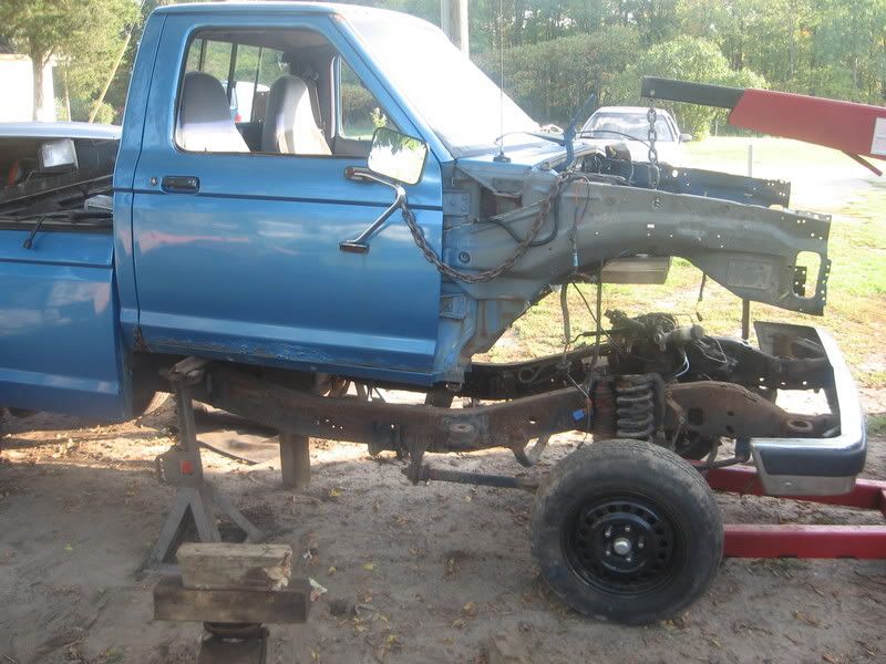

Thats only after two days of work. I have to build new rear cab mount. I still have to get the tranny and T-case in yet. As far as the bed I have to figure out what i'm going to do yet.
ahhh...ttb wont swap into a 2wd truck, i kinda figured you would do a sas once i saw you had a 2wd truck...do you plan on putting the bed on the explorer frame?
yes the ranger had a lift kit on it, as far as being rancho, could only assume
i beileve that it is the rancho kit on there.
As far as the bed i'm thinking that i may do like the dezert guys and build a bed cage and then hang bed side off of that.

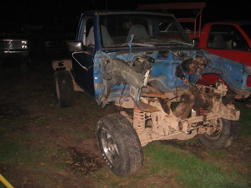

If you decide to make a bedcage, cage the cab at the same time. It would be pretty easy for you to work around the cab cage because you have it all apart at the moment.
Sweet, lookin cool

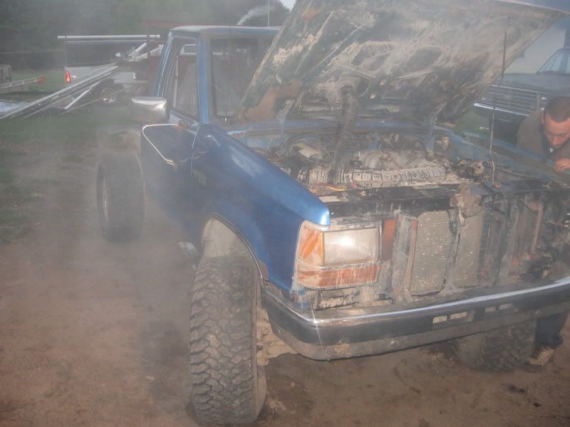

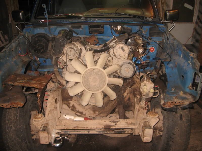

We got it fired up tonight, and backed it out of the garage. Man it smoked bad. I have to replace the spark plugs cus they are probley fouled. All that left to do is the front drive shaft, make rear cab mounts, and wire up some tail lights. I'm planning on having it at the last Bear Swamp.
All the smoke form firing it up
yep, they like to smoke once they have been on their lid. will probably need an o2 sensor too. was there something wrong with the blue hood or are you just trying to keep chester alive?
chesters hood had the hood scoop and i didn't feel like cutting the rangers hood.
Chester Lives!!!! Just looks a little different. I would have done it a little different but, that is me. It looks goood and it runs, that is what matters.
