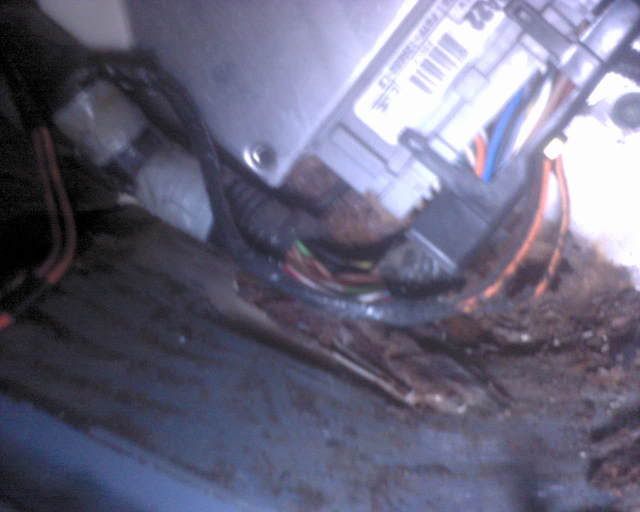

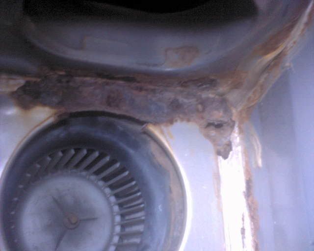

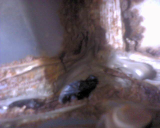

possibly this...
Which is some major work to fix.. trust me, a lil over a year later and im still working on it!
