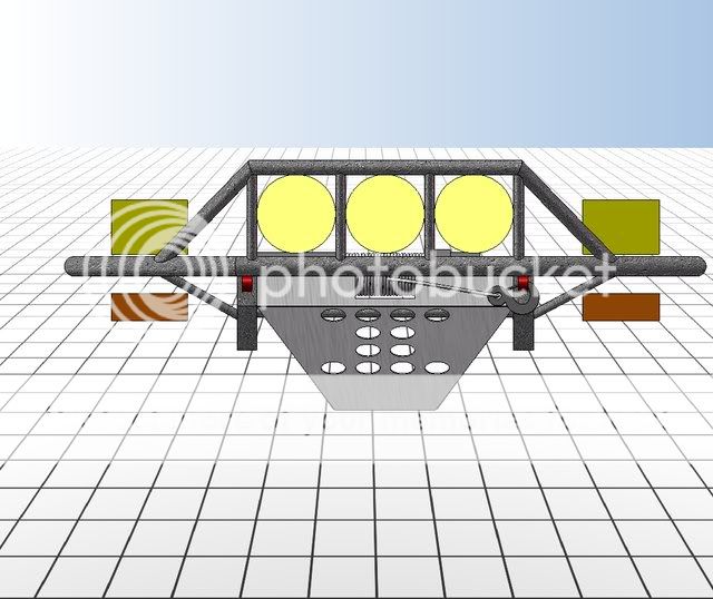

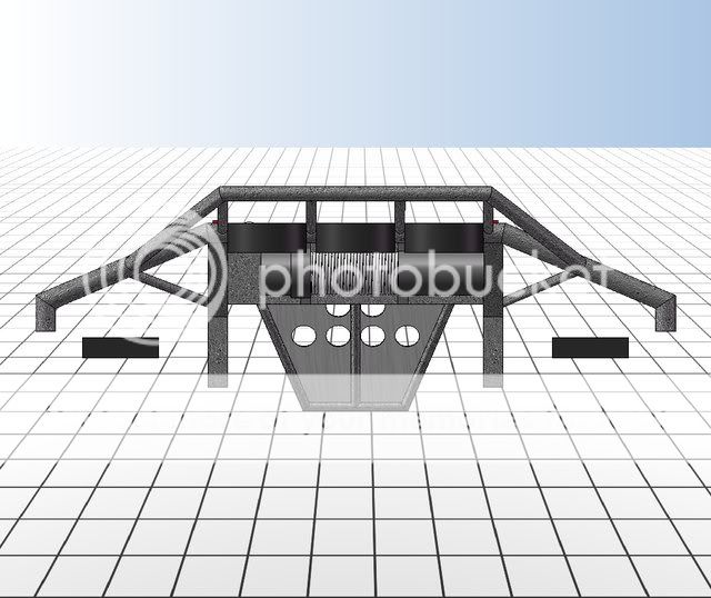

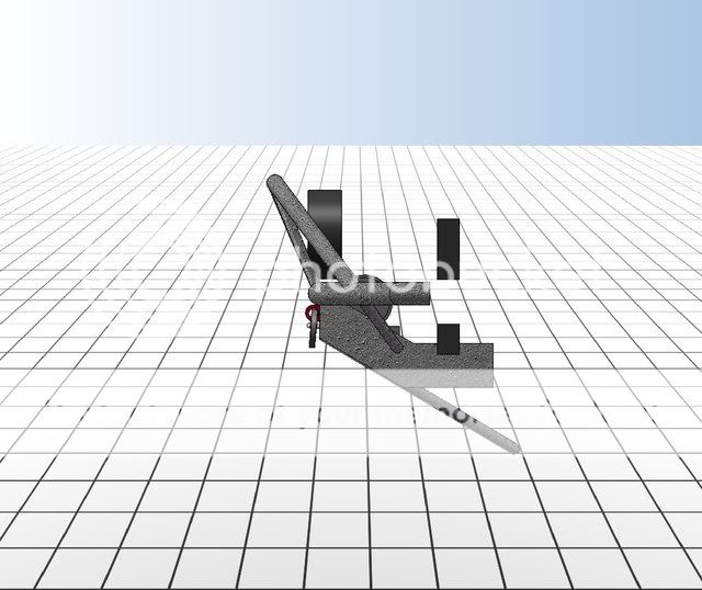

Here is the design for my prerunner bumper.

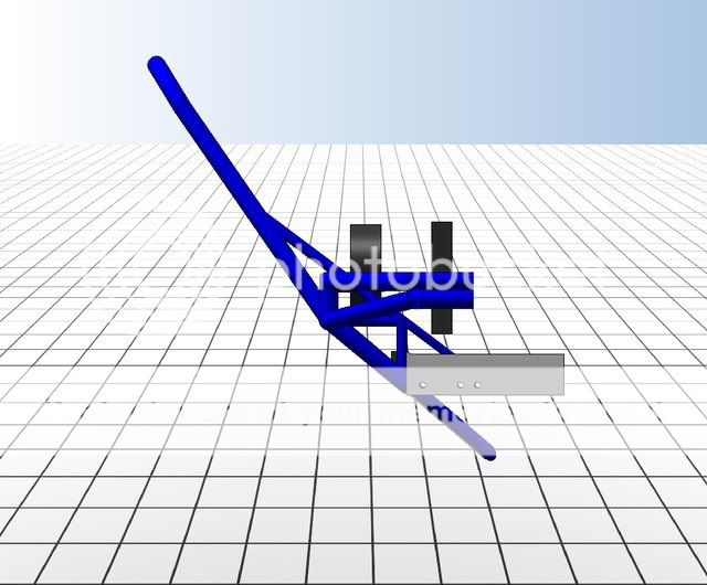

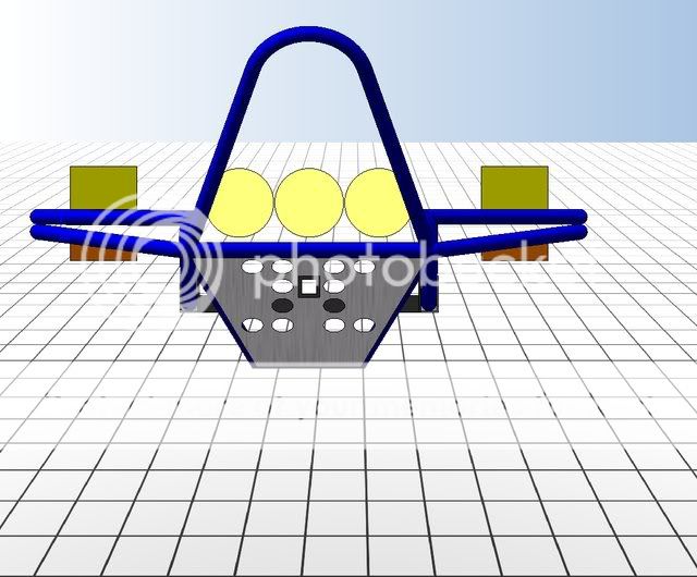

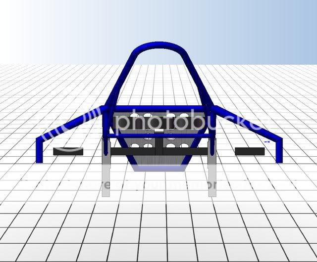

And here is my design for my stinger bumper.
The yellow squares are the head lights and the orange squares are the turn signals. They are there to show how the bumper would sit in relation to the front of the truck. And the grey tubes on the stinger represent the frame rails.
Designs are far from final, but its the basic shape.
What do you think?

The stinger bumper actually has a receiver built into it, I dont know if you can tell from the pictures. I plan on using a cradle type winch such as, http://www.warn.com/truck/winches/src/xd9i_multimount.shtml, with the rock crawler. But I pretty much scrapped the stinger bumper today when I started to design my exocage. My plans were to have a receiver on both the front and rear and then one on each side of the truck. That way with a cradle winch you can winch from any direction.
