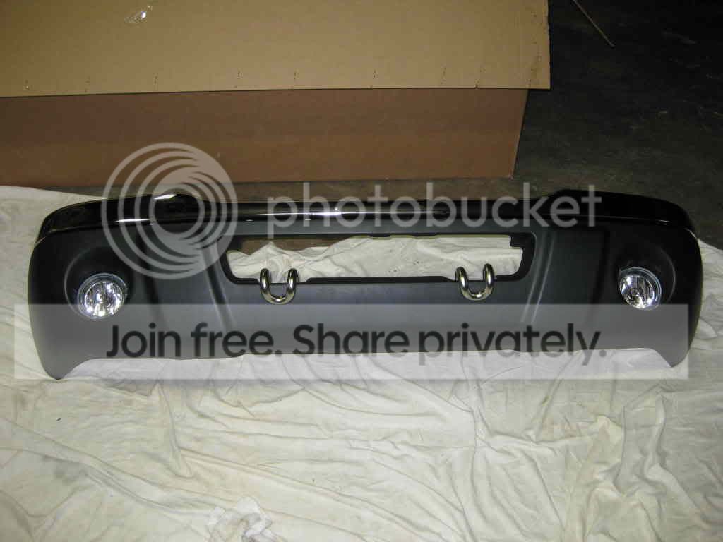

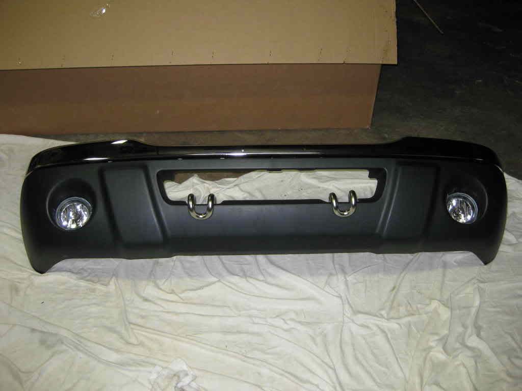

...or you could switch to the XLT/FX4 (or Edge if you want it painted) valance like I purchased:
Lots of choices.

Default
I think you'll be happy w/ the Hella's if they are anything like the ones I have. I honestly drug my feet for a year or so getting the FX4 front valance because I know the oem fogs won't be anywhere near as bright as the smaller Hella's in the Ford accessory kit. I can see better on low beam (when the fogs are on) than on high beam by far. Amazing lights.
Are you going to use a hole saw and install them in the "fog light" spot in the valance, or in the center opening?
Quote:
Originally Posted by the.hatter View Post
wow that valance is awesome looking!
Ford is extremely proud of those Level II tow hooks. Sheesh.
