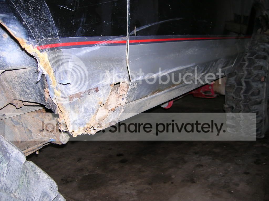

the tree won

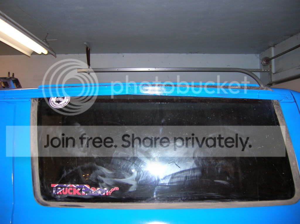

window sliders to save those big vonerable windows (they do work!)

Cool. I like that window guard idea. Got any better pics of that?
build thread
thats all i have as of right now. those were actually given to me by another member on here. i am sure if they want to be known for it they will chime in.
