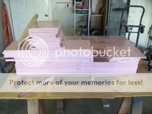

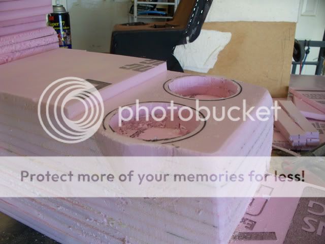

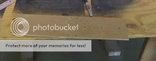

So today I went to Home Depot and got some sheets of the pink foam. When I got it home I began cutting strips to build up my base. I also fabbed a circle jig and cut a ring for my speaker with the router.
So here are a few pics - this is my first from scratch project to it looks rough now, but I will work out the kinks and make it nice.

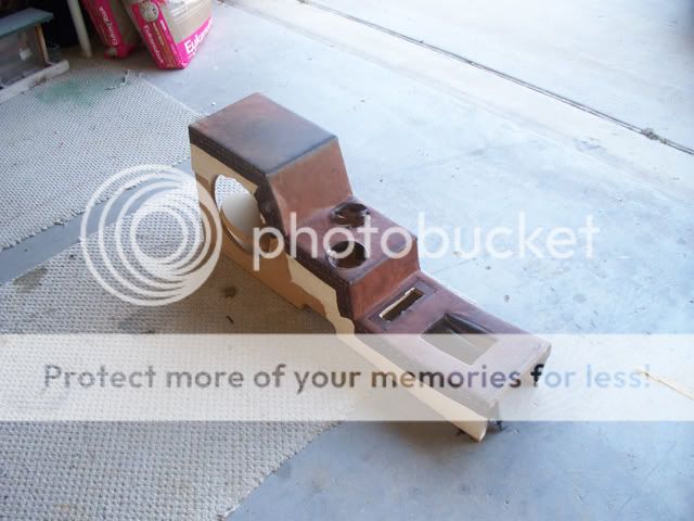

Old Console - MDF and Walmart fabric . . .

Base built up and ready for trimming
Center Console Build
Circle Jig

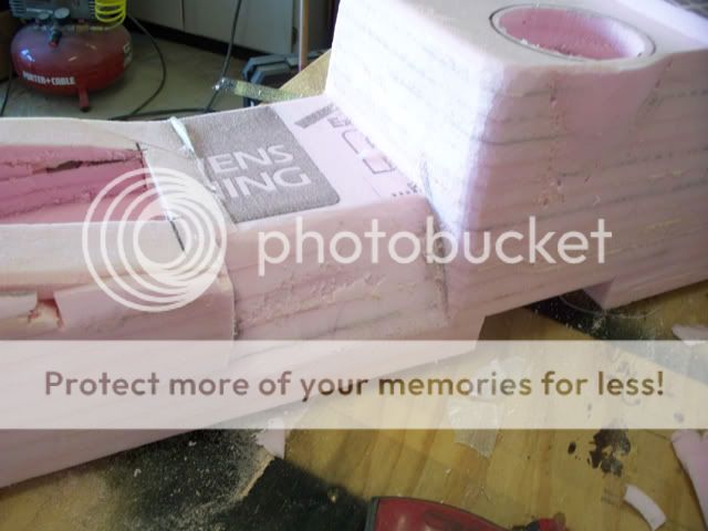

Rough Shape

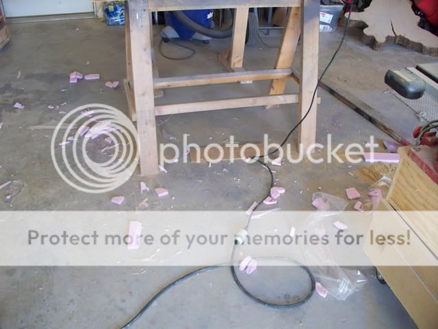

Debris - Hahahaha

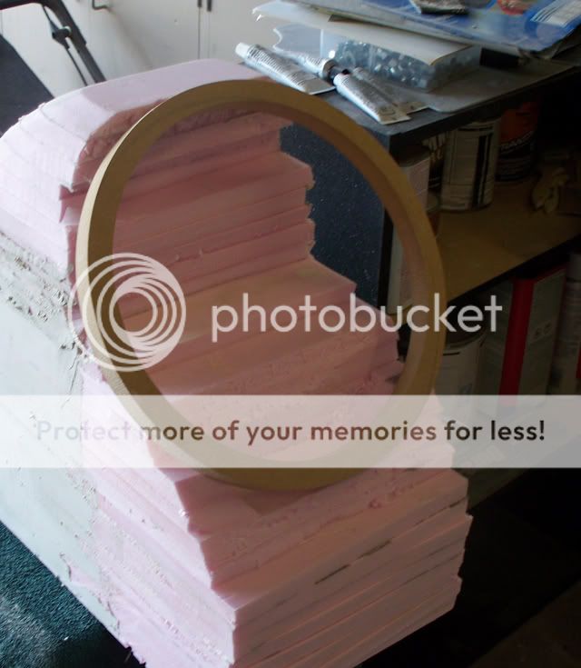

My first ever router cut ring - woot woot

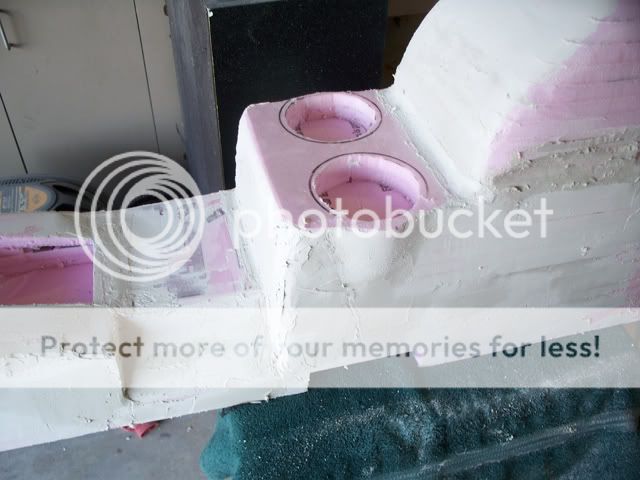

My shapely cup holders - I like how they look

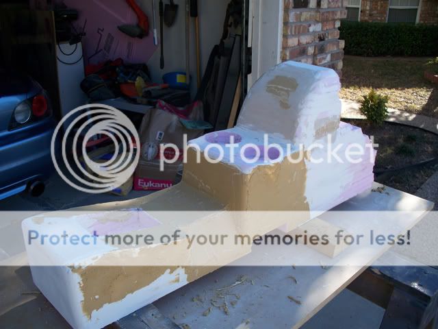

Applied a coat of sheet rock mud - cheap and easy to sand/shape
The angled cut out on the drivers side is for 3 switches. The speaker ring will be temp fixed in place, fleeced to the main section and glassed into the console. I don't have enough room for a trim ring, so the speaker will sit on-top of the enclosure.
Components are BASIC and CHEAP - so please no flaming - I cannot afford something top end, besides I had a competition system before and just don't feel the need for a system at that level. I am using a Pioneer 10" sub and a walmart amp that is see through - looks cool but is probably a POS.

I am using the pink foam because it is light, easy to handle, easy to shape and will make a perfect base for me to fiberglass over. I am laying down drywall mud as a base layer on the foam and then body filler over that to shape and smooth. I will then fiberglass over the filler to make the final shape. The foam, mud and body filler will be pulled out and discarded when done. Then I will have to build up the bottom and enclose the speaker section. Stay tuned, I will post more when I make some progress.
I used almost one sheet of the foam to build up the base, I just cut it into strips and used spray glue to glue them together. The foam and a 2X4 section of 3/4 MDF cost me $44 at HD.

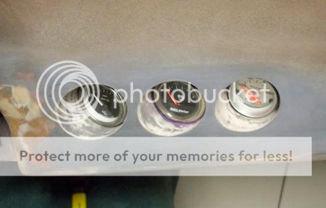

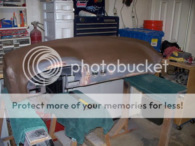

Also this project is taking place at the same time as my resurrection of a 92 Nissan 240SX - I made a custom FG dash for it with inset gauges. Here is a pic of that -
Close up of the gauges

Quick update: Added some more filler yesterday (Sunday), I will try to get it smoothed out and some more filler today . . .
Hopefully my resin will come in this week, then I can begin the glassing . . .

How did you make the ring for the subwoofer? Do you have pics of it?

Yes but I did not want to have to build the mdf subframe to attach the fleece to. The foam is very sensitive to the resin and filler, so I used the drywall mud, then filler to help me shape the basic lines. As soon as my resin comes in I will be glassing . . .
The ring was made with my router, I used a circle jig and cut the outside of the ring then the inside circle and the ring fell off. There is a pic earlier in this thread. The circle jig also.

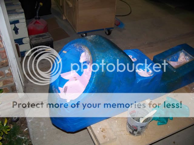

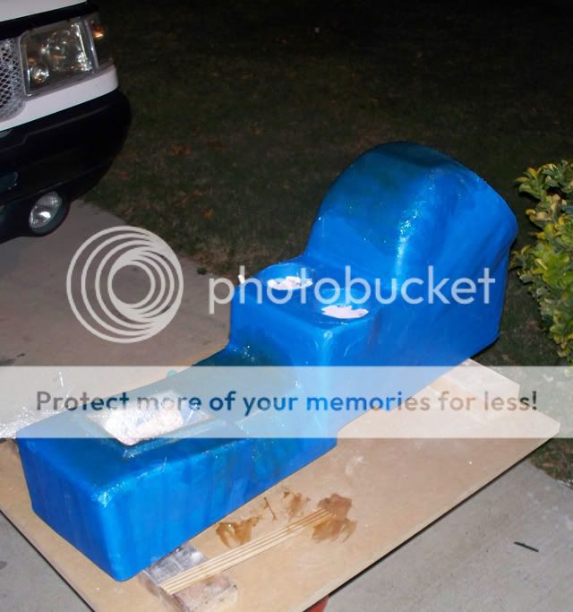

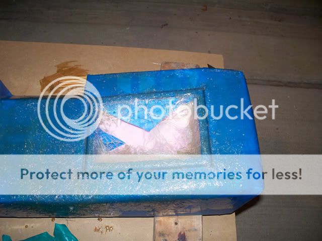

Ok - finally back home and I started back on the console. I put some more filler on and knocked down the rough edges. While it cured I made a jig for my router and cut out a trim ring for the shifter from MDF. I placed the trim ring and sub ring in place and I taped the entire plug making sure the shifter hole and cup holders were left open. I decided to use the tape to get my final shape to the sub ring instead of fleece. Yes I know this means more work for me later, but I can accept that. I then started laying a layer of glass onto the tape with some chop mat. Yes I was trying to use the last of my B***o resin. Well, I set her aside to cure, walked around to the front door and DAMN IT -there was my box from US Composites with a gallon of B-440 - oh well.
Pics:
Shifter Trim Glassed In - needs some refinement.

Overall shape

My plan is to do a single layer over the tape, pull the plug and build it up on the inside adding the cup holders and trim for the shifter and sub. The outer surface will be smoothed and filled as any other project, but I do not want it to get bigger on the outside.
I am going to build a baffle to enclose the sub area separating it from the front portion.
The angled part on the Driver Side will hold 3 switches, I have a metal plate pre-drilled that will be glassed into the console giving the switches a mounting point.
