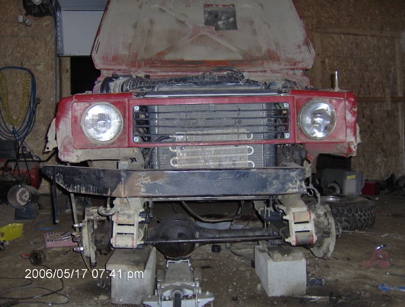

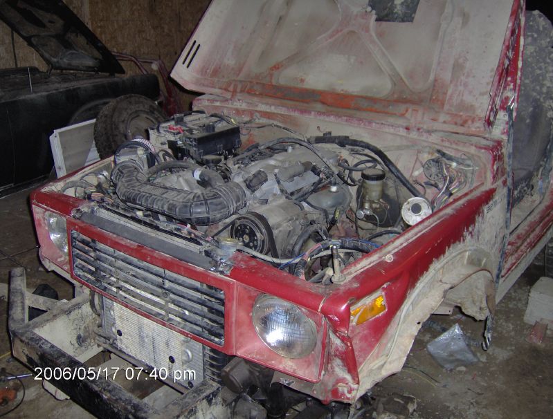

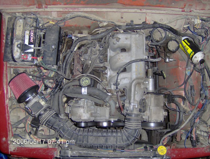

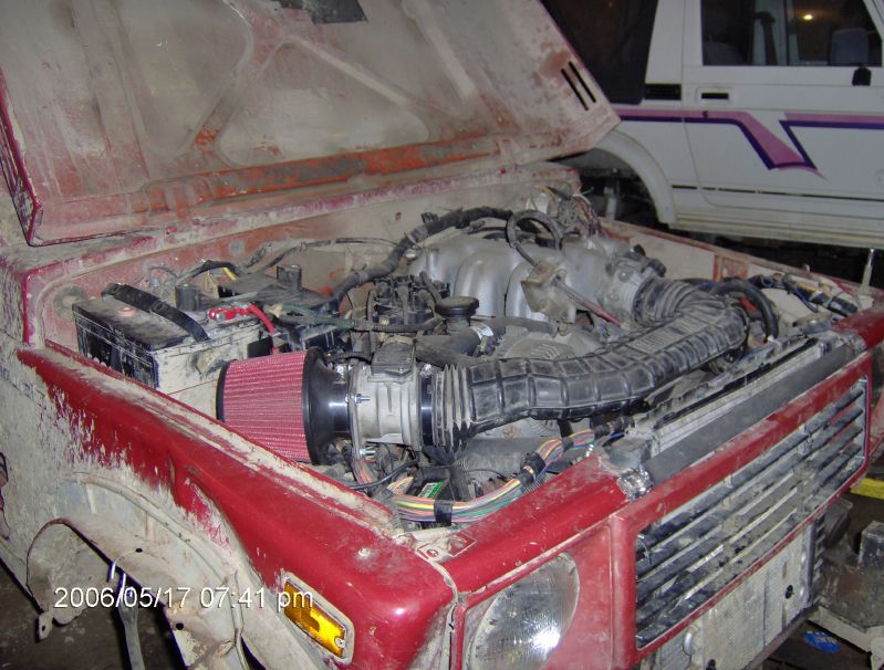

i have posted these pictures before the collapse of the old bbs, but have had a few requests for them again, so here they are. feel free to ask questions. the setup is ford 4.0/c4 auto/ zuki tcase/ stock zuki axles/ 33x12.50 swampers/ toyota power steering/ Sky over the top steering/ ford f150 shock towers/ geo tracker brake lines(they are longer)/ dodge neon seats/ lots of mud and rust and a few other things i forgot to mention. oh yea, a 4.0 v6 hauls ass in a light little zuki with low gearing!

when you think you have seen it all...... comes complete with brake fluid back up bottle.....
are you useing the stock inserment cluster?...a member here well from hte old bored mcderry has a 2.8 in his zuk....i need to see that thing
yes, i am using the instrument cluster from the explorer. complete with zip ties to hold it in place.

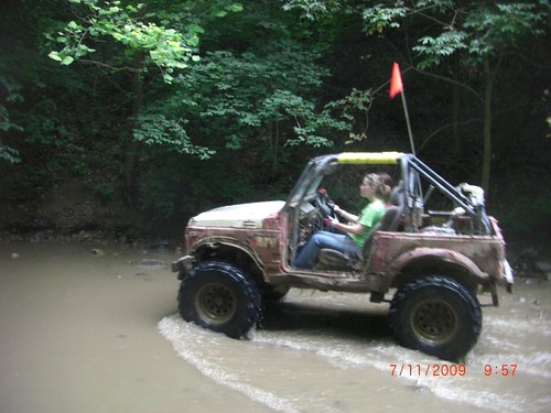

this is how it looks now: new additions - roll cage, and moved the radiator to the back.

That thing is sweet! How are those sami axles holding up to the 4.0? Those things will fit in the back of a super duty hey, i know!
no problem with the rear axles. i do pop a birfield every now and then. i installed trail tough's double tough axles last feburary, and have not broken any since. i do not have a front locker installed yet though. i will install a locker, then we will see if they contiune to hold up. i have hope that they will.
