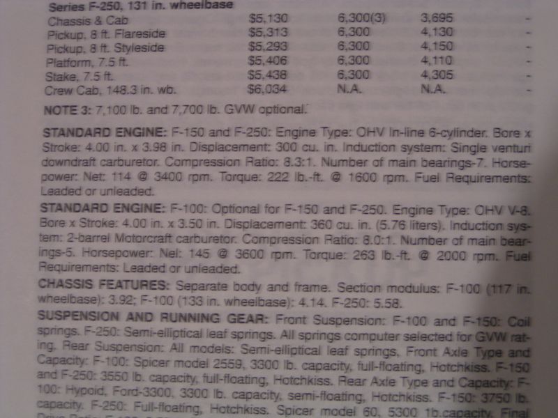

I am sure a 300 with a single barrel carb is on everyones wish list too. That one is pretty sad, only makes 4 more hp than my 2.8 :rolleyes: On the plus side that 222 is at 1500 rpm, which is pretty low.

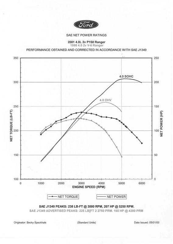

Yeah and it makes it's 222ft# only 400rpm lower than the 4.0 does--1,600 vs. 2,000--and then goes into the toilet. The 300 is making 175ft# at 3,400 and the pushrod 4.0 is making 220ft# still and the SOHC is doing about 235ft#.
300-6 is pretty good for idling around the barnyard but it won't accelerate a load very well. It gives you a decent goose when you push the pedal, then it falls on it's ass. Either 4.0 keeps the torque going to the end of the powerband so you can actually accelerate onto the highway decently while pulling a trailer.

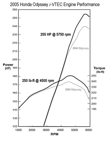

And because it annoys people, I'll post my favorite Honda 3.5 VTEC curve. Little aluminum no torque high rever piece of shit makes 90% of what the torque monster 300-6 makes at it's torque peak and at it's hp peak when the 300-6 is at 175, it's pulling 240ft#. Then it keeps pulling for another few thousand rpm with the torque peaking at 250ft# and then falling all the way down to 220ft# at the limiter.
It's a good motor, but it belongs in town. A 100hp full-size pickup isn't really useful to me.
