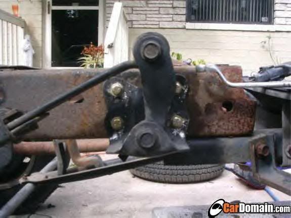

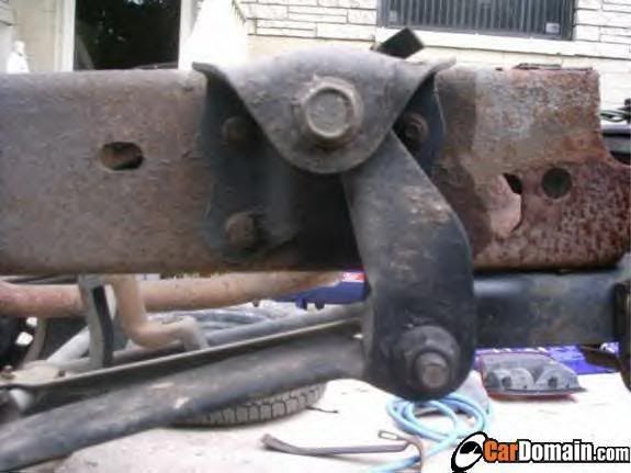

How exactly do you do a shackle flip?? And how does it lower the truck?
CLICK
EDIT: note that the before and after pics are the same on that page. if you look under your truck right now, you'll notice the shackle is on top of the spring. a flip moves the spring above the shackle.
