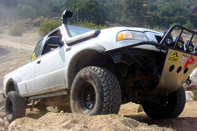

K well thanks for the help and it is not a manual its auto. but could any body possibly post up some pictures of there 4x4 with a 3" body lift. Btw does anyone know how much taller a 4x4 is then a 4x2?
Here is my truck with a body lift 03
Body Lift Questions
and here is a friend of mine with a body lift, his is a 99 too.
Body Lift Questions

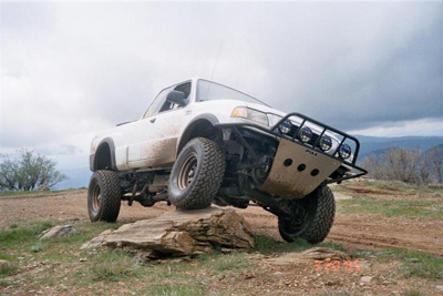

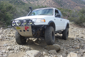

heres my 99 mazda B-3000 4x4 on 33's
  • Body Lift Questions
