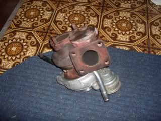

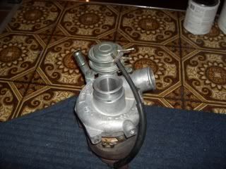

OK so i cant wait to get some pics up... Here are a few of the turbo:

hmm a lil 13b off a mitsu should work pretty good I guess.....you might have been better off going with a bigger turbo and just keep the boost turned down. Do you know where you are goin to mount the turbo yet? Are you going to run and intercooler? What will you be useing for fuel management and all that. I would also suggest looking into a meth injection kit to keep you intake temps down
Oh and if you want to twin turbo it I have another turbo just like your sitting here collecting dust

Yeah a bigger turbo would have been better, but i got a steal of a deal on the turbo. 20 bones... cuz the guy had it sitting for a similar project and just wanted it gone. I only plan on running 5 PSI daily and 10 when I feel i need to whip up on some ricers.
The 4.0 already has a forged lower end so im good there. the pistons from what i know should hold up to 20 psi before breaking parts.
I am mounting the turbo at the Y Pipe down low. I have to get me a scavenge pump and I might make a separate oil reservoir so i can run synthetic oil.
No intercooler as of now... I might find me a small VW intercooler later on if i feel it needs it at that low PSI
As for fuel management, the only thing i plan on doing is upgrading to 30# injectors or 5.0L injectors (i don't know if they will fit)
And thanks I'll look into the meth injection

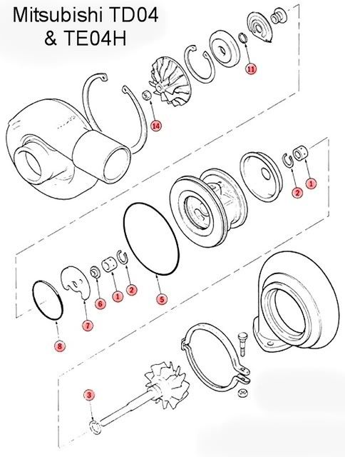

Update for today....
I got the turbo taken apart
Thanks to the help from this
The components look like they are in decent shape, but I am glad to be rebuilding it just in case...
