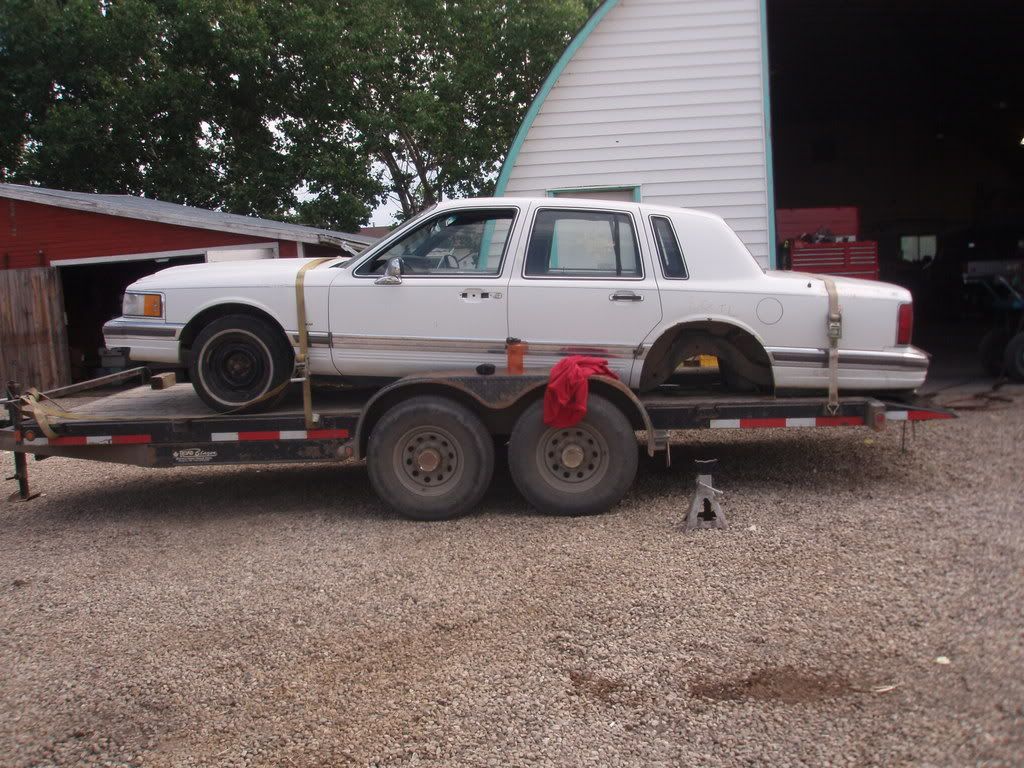

So, I finally got around to loading up the donor car from my V8 swap. My 90' Lincoln TownCar. I called the junk yard and asked if I could trade them it for a rear axle out of a 95' or newer Explorer. They said no, and that the axle would be $300. I laughed at them and hung up, i mean, i'm bringing them metal (which is at INSANE prices right now) and I'm giving them a axle to replace the one I'm takeing.
Wait a minute.
I have an axle under the car!! So, I picked up the back end of the car with the tractor, threw some jack stands under there and crawled under with the torch and went crazy.
So now they can have the car, with no: engine, transmission, interior, rear axle, seats, radiator, dash. etc.

pics
NEVER take whole cars to junkyards, always to a scrap yard, i know around me im gettin on average 12.50 USD per hundred .......
Damn, that's good money. Around here we MIGHT get $8-$10/hundred and that's only if it still has the cat on it. Without the cat it's about $7.

When I first met this car it was in a U-pull yard and the entire interior had been pulled. No seats, no carpet, no door panels. I needed the driveline, so I took it. Unfortunately for me, the previous driver didn't believe in maintenance, or not overheating things. I rebuilt the engine and had to re'clutch the transmission.
