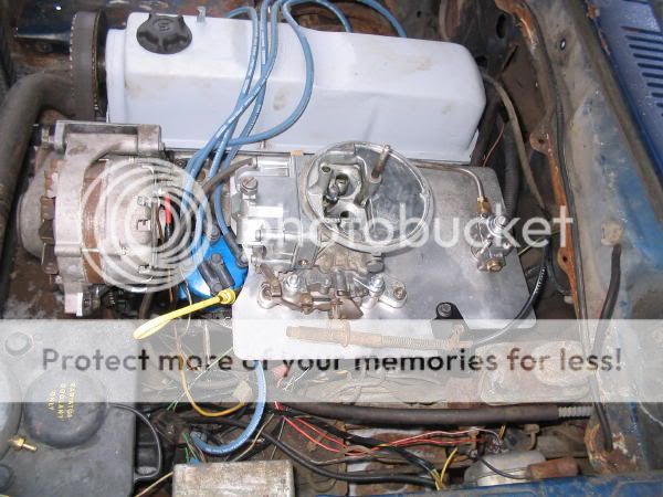

My Pinto has a 2.0 head. I searched the archives for an intake that would work. I've tried every intake ever made. The only intake that will work on the 2.0 head is a 2.0 intake. I ended up fabbing my own intake. It is made from mandrel bends and a piece of 3/8" plate. This head and intake combo out performs anything I've tried. I'll make an educated guesstimate at 150 hp with a stock (non roller) cam.

I would say that the Cannon intake would be better than any other intake that you could get for the 2.0 head.
With the Weber 38 or a Holley 5200 you will gain a small amount of HP/TQ. Very little difference between the 2. Weber was the original designer and Holley built them under licence. The 2300 Holley will give you a bunch more power.
