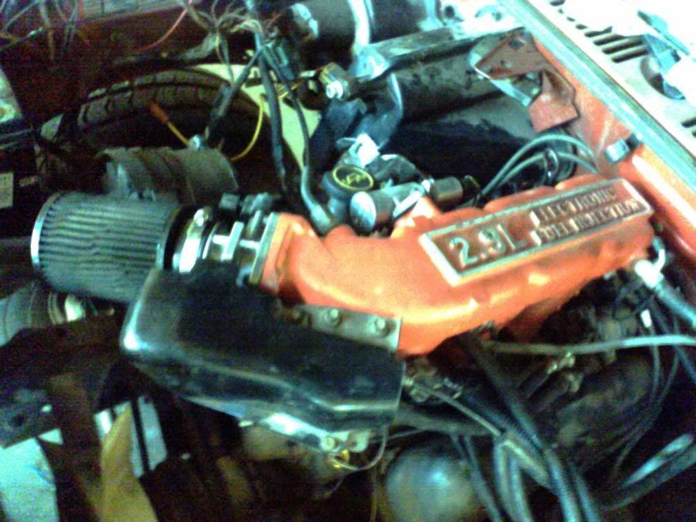

My two projects my 87 stx soch and my 01 dd(Lots Of Pic beware of slow internet)
the Old 2.9 still running strong in my nephews truck with out a tick even. I think the secret to the tick is he romps the shit out of the motor.

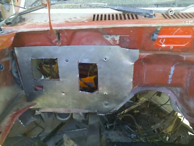

I planed on taking the HAVC and Dash out of the 04 to plac in the 87. So IO had to cut large hole in the fire wall for the blower motor. SO here is my patch plate.

nice looking trucks. what all did it invalve to get the 4.0 in the older ranger? im looking at possibly doing the same swap but dont have a way to do any welding on my rig. what else do you have in the works for the 87?
It was not all that hard after cutting the big ass holes in the firewall it went pretty easy, Just swap the motor mount plates from the 2.9l and that will line up all the trans. holes and then I placed the ECU in a box in teh firewall.
