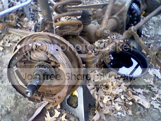

Just look what I did to the D28 in my old B2

The first pic is an example of previous carnage, I believe

The D28 with the pinion blown off was from my old 89 B2, Just another example of how TTBs hate me.

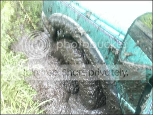

This is the mud I was in when it broke
