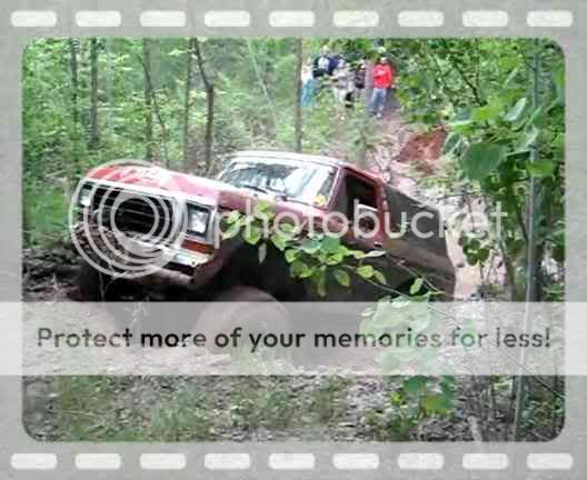

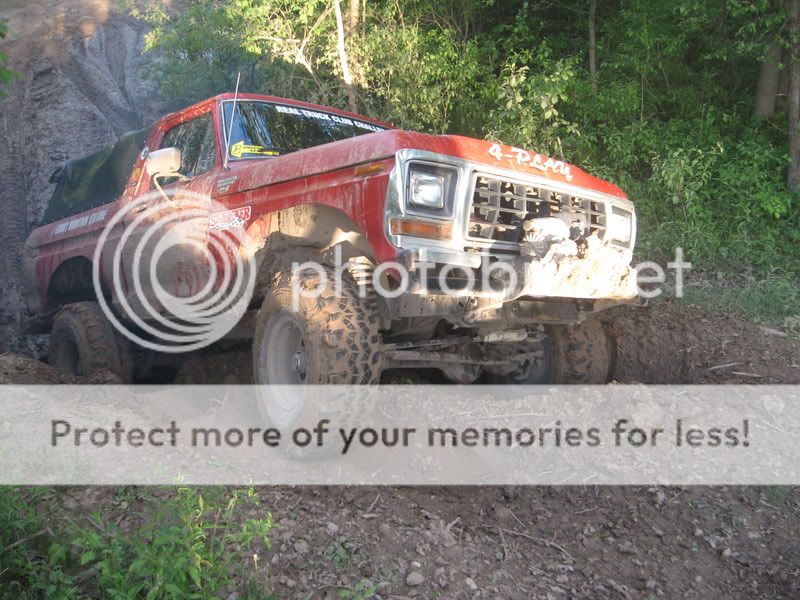

i rode in a 78 bronco and the owner was runnig 38s on his. hes running a mildly built 460 too. he's running yukon axles and he said that its been 7 year since he broke an axle.
heres a pic and vid of it
Largest tire on a D44 and Ford 9" suggestions
that thing's a beast!
its been in the four wheeler mag real truck challage. he bent the front axle tube cuz he jumped it down the comp.
damn!
