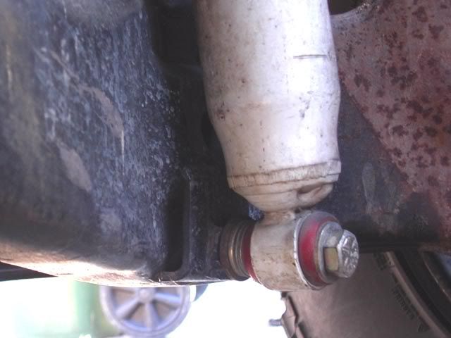

My lower front shock mounts are extended downward, yes (instead of mounted in the center of the arm like stock).
(some better pics)
If you do this, just make sure you space the shock away from the arm enough so the shock body doesn't hit the arm on droop.
I moved my front axle as far forward as I could (via the radius arms) before it would hit the bracket I mentioned above. This will give about 1 - 1.5" more wheelbase over where it was stock.
