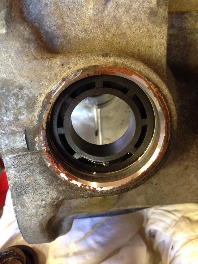

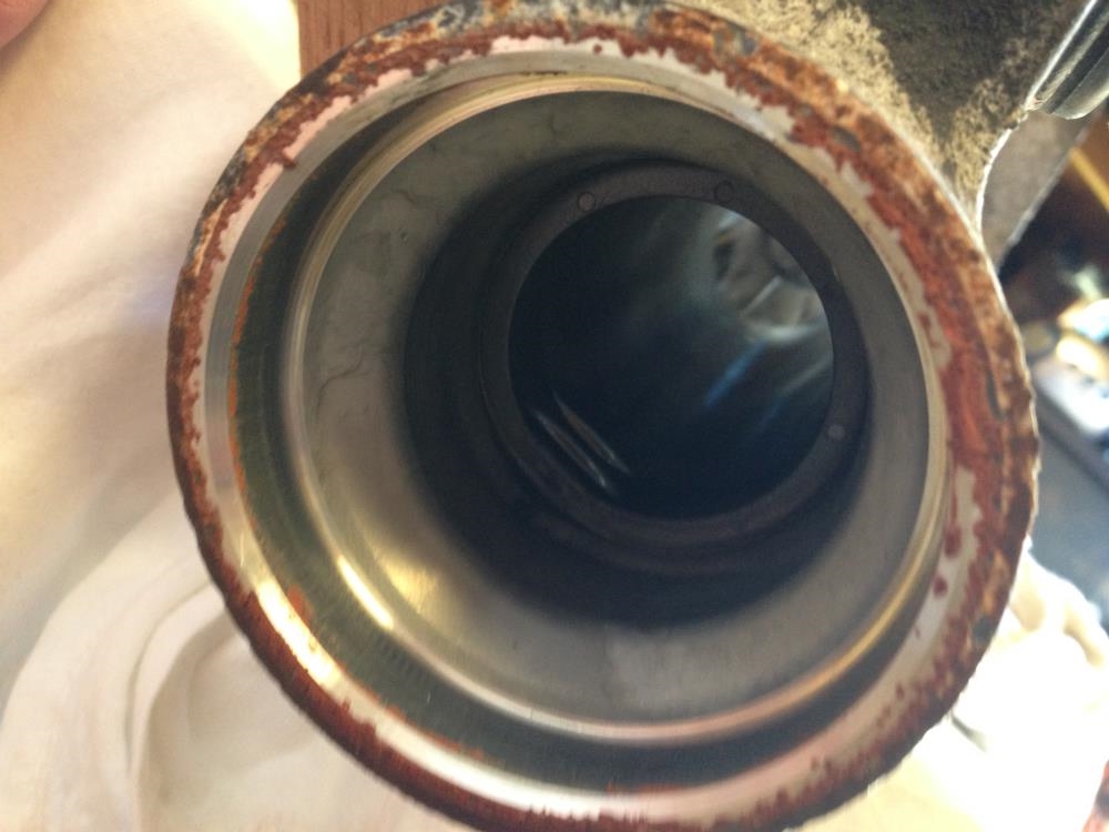

So when I opened it up and took the seals off this is what I found. It looks like Ford changed things at some point. Fortunately everything looked good.
very interesting? :icon_confused:
is the ring gear still only 8 bolts?
Yep, still 8 ring gear bolts, pretty much everything else seems the same too. The torsen went in fine and should finish it up this week. That's all that matters.
Sooooo there isn't any kind of bearing behind the seal on the passenger side?
You may be able to see it in the first picture, it is similar to the black plastic one in the second picture.
