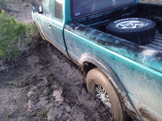

We've gotten stuck a couple times...

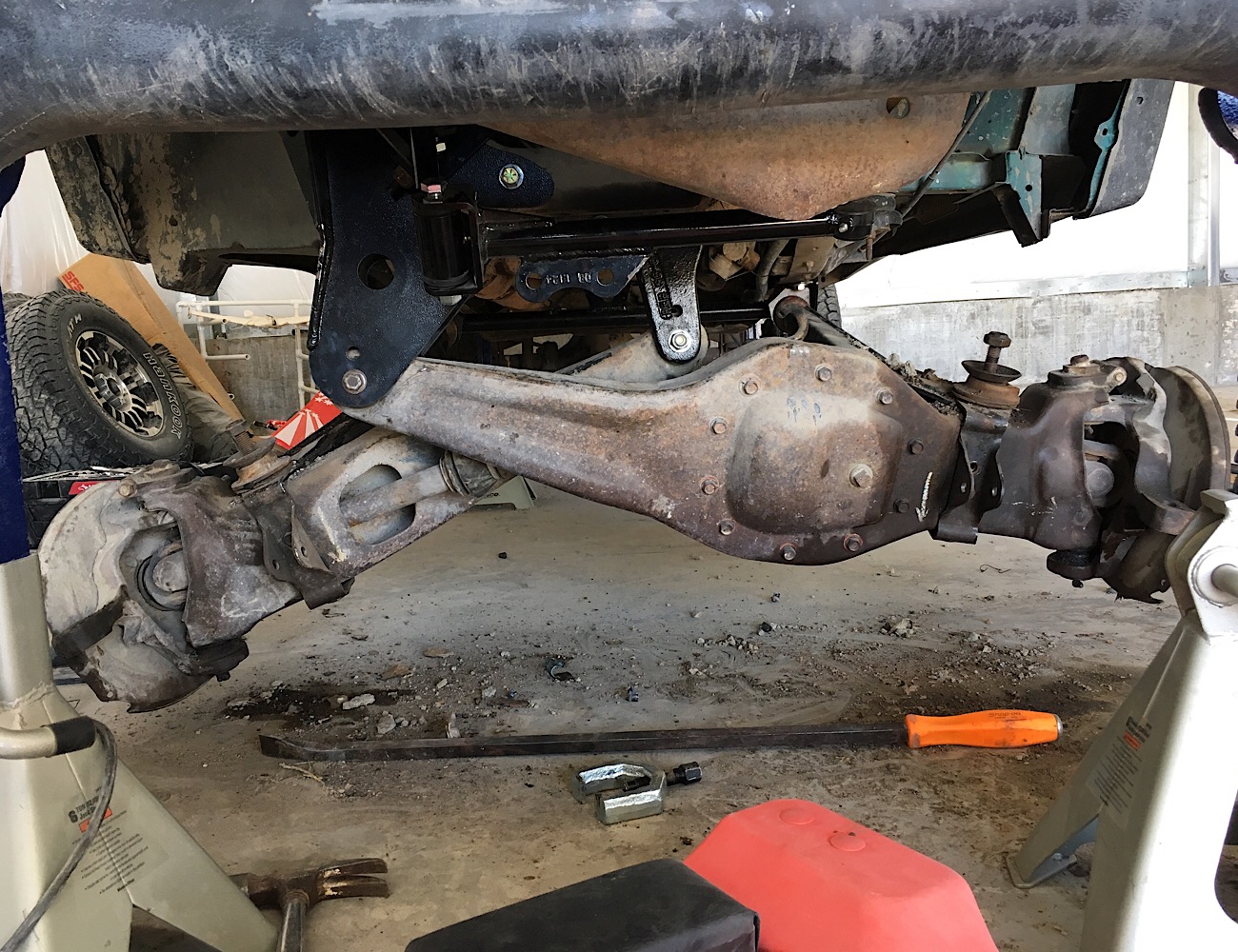

Alright guys, this thing has finally gotten some attention. Busy schedule so it's hard to find time for her some days. Anyways, this tear down ended up being a little more than just a lift kit (shocker, right?:shok:). I bought a superrunner steering kit knowing that the angles would be all out of whack, and I do plan on modifying the center link to drop it down to the correct angle:icon_thumby:. I also got some f250 shock mounts, figured I might as well do this right the first time :dunno:. Here's some pics for you guys:D

Fab work

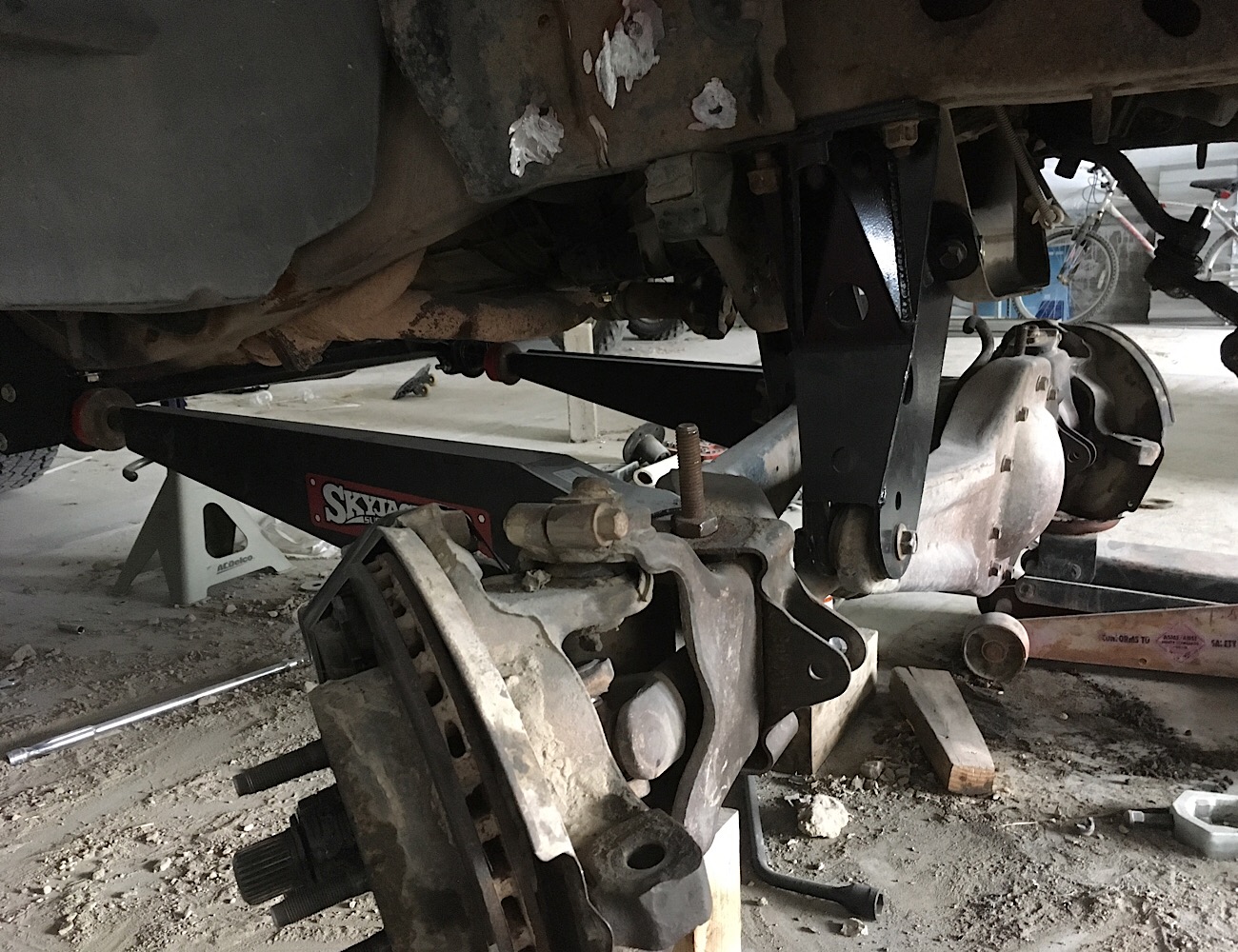

Small update: the f250 shock towers are mounted, and the middle link of the superrunner steering has been lowered by 4". :icon_welder:

Looking good champ. You should get some good flex with those coils and radius arms.
Let me know how the steering works out; I am thinking about going the same route after I put my 6" coils in.

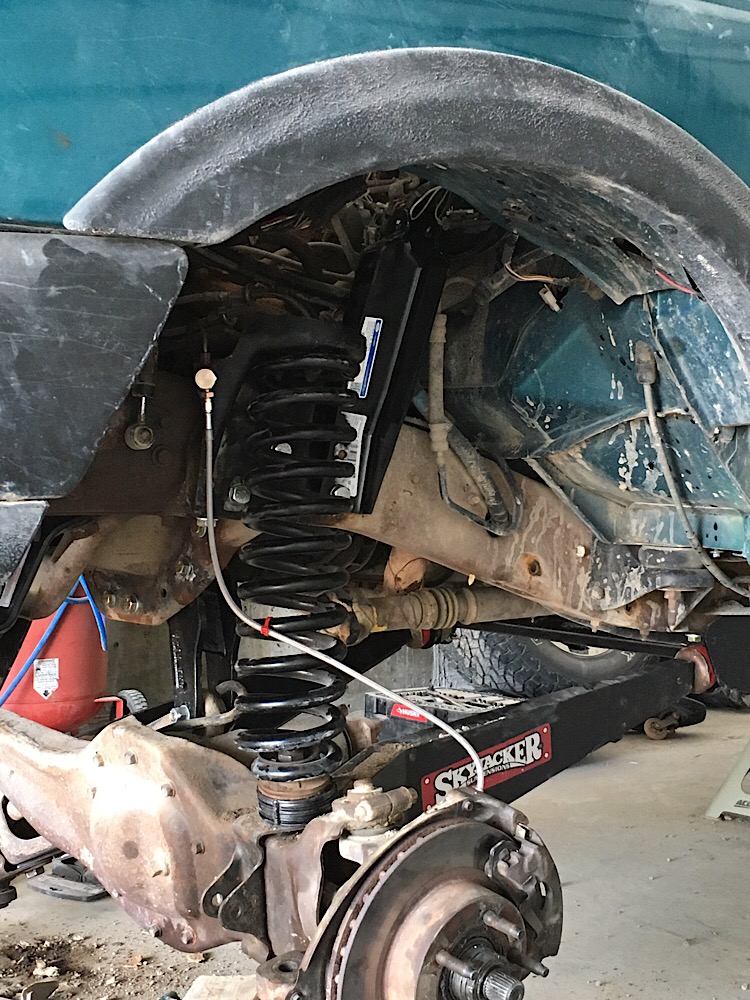

Almost there!
The ol' gal is back on her feet! I'm currently waiting for shocks and wheels, then she'll be cruising!
As for the steering: the angles look pretty good, but I welded the tab on backwards so I had to mount the steering arms from the front, instead of the back... rookie mistake I suppose :annoyed:
