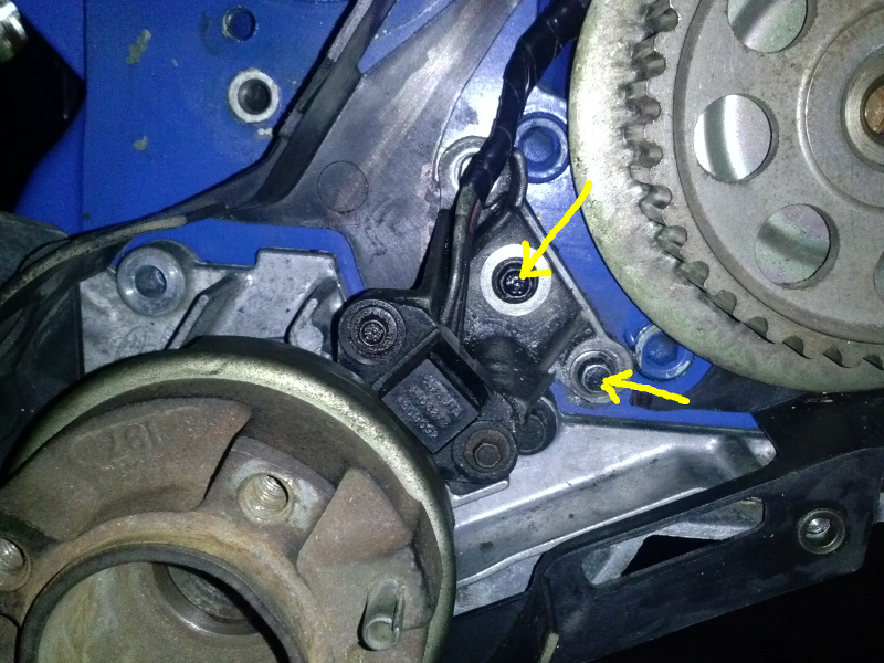

I know it's been covered many times however most of the articles I have found pertain to 95 and up OBD-2 swaps.
In my case I would like to drop a 98 OBD-2 2.5 Lima into a 93 2.3 ranger. Clearly we would need to use the intake manifold and exhaust manifold off of the early 2.3 however this will not resolve the crank sensor issue.
My question: is it possible to use the older 2.3 front engine cover on the 2.5. I am sure all the sensors would also need to be used off the original 2.3 out of the ranger to include the older style crank sensor, oil pressure sending unit, and temp sensor.
I know the latter 95 and up 2.5 swaps are very strait forward but would like to get more details if it's possible on the pre 95s. Also this truck is a 8 spark plug coil ignition. Clearly the 2.5s don't have a hole for the distributor so this would be impossible on a 2.3 with a dizzy.
I'm not 100% certain about the method, but this has come up before. Not just with the 2.5 swap but with swapping any of the 2.0/2.3/2.5 engines...
There is a way to do it but it requires drilling the block to install the crank position sensor...
I would search for you but don't have time...can do it later if nobody else responds...but you can search on something like "crank position sensor"...or similar...
That would definitely be helpful. I have been searching but have not found a clear answer or DIY thread.
If all that is required is simply drilling and taping two holes to mount the sensor that doesn't sound to bad.
OK...I found a thread on TRS but you might want to consider this before going ahead.
http://therangerstation.com/forums/showthread.php?t=142043
As an afterthought the original post by Tinman was followed up in another thread and he didn't think it was such a great idea after all the work he had to do...read the last post in this thread for more information.
http://www.therangerstation.com/forums/showthread.php?t=167318&highlight=crank+position+sensor+2.5
I bought a 96 Ranger from a TRS member who had swapped a 98 2.5 in and his thread is on here also...he ran into a few problems but managed to work them out. He put on 50,000 km and when I purchased it from him it still ran great. Smooth as anything with plenty of power, but he used the 96 fuel injection parts.
Anyway...it can be done...hope this helps.

Sorry the pics on that old thread are gone. I did some digging and found some of them, particularly some pics of the crank sensor. The first shows the herb lid that I used to determine the position the sensor should be. I just used a Sharpie on it and marked the locations of the key way and the sensor. (Not shown in the pic but I think you get the idea.) Then I moved the lid over to the 2.5 and lined it up. I lined the sensor to the lid and marked where new holes should be. Note that the upper hole fell dead in the middle of an oil galley so I drilled a new hole in the middle of the bracket.
WARNING: be careful where you drill the holes. There are oil galleys along the front of the engine. That lower bolt ended up being crazy close to one of them. If you drill into one you will have one heck of a paper weight.
It has been on the road like this since late 2013 with no issues to date. Feel free to contact me if you have any questions, there were a lot of other knick-knacky things I had to do to make it work.
