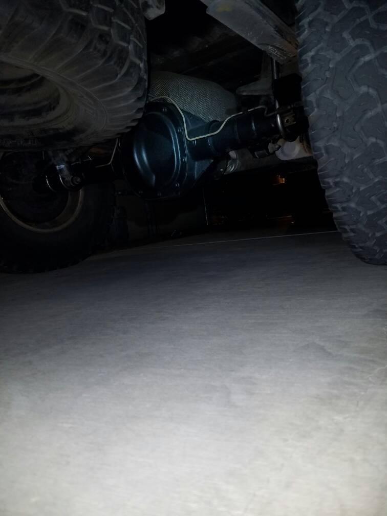

Hey guys just wanted say thanks. I know it's a little bit delayed but I finished up the swap tonight and drove it and no problems so far! I went with 4.56 gears and I definitely like it
