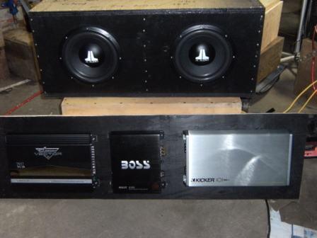

this is the start of the next addition to this monster.... will keep this thread going as we build it up.... cheers... got the subs and sub amp figured out today... also found a crossover... have a real nice clarion head unit for this build....

the JL's are boxed, mounted the 3 main amps onto the plywood. this isn't going to be as easy as I thought it would be..... Have all the equipment that is needed for this project cheers

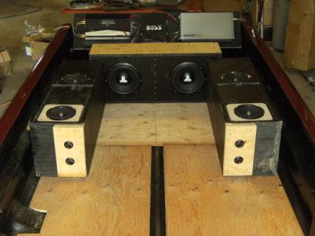

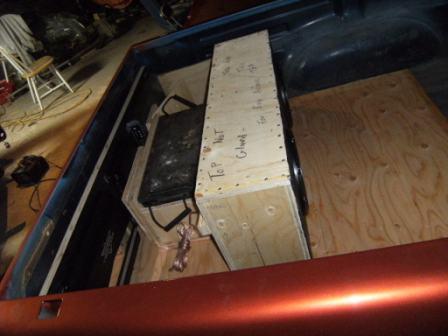

here is how i have mounted the 3 main power amps that will drive the 10's the 8's and the 5.5 mids. the amps are on 1 inch plywood standing up at the very front of the box. Then the battery box is tucked under and the 10's up front.
the head unit and eq with x-over is all accessible when the tonnau cover is lifted and there are separate switches wired in to turn all units on. the bass amps if nor needed can be remoted to not be on if not wanted.

been slowly working on this idea. had an old set of kef speakers that were ready for the junk heap. tore them down and used them as the frame work for the speaker boxes.
this is how it lays down. they will be covered in cloths and rugs yet. will need to be torn apart to go on the frame.

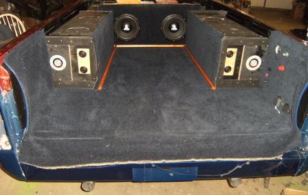

just about finished the box. Building the covers now. :)

hi 91, thanks for the comments.... tilt bed huh... lol naa thats ok... with the hard tonnaue cover up and angled it redirects the mids nicely... its not built to make ears bleed... just to sound nice... but has the potential to crank if needed.
break down is 2 @ 10 inch bass... then 2 sets of mid paired tweets then a set of super high tweets... driven by 3 seperate amps with full 1/3 eq and 3 way xover... works very nice :)
