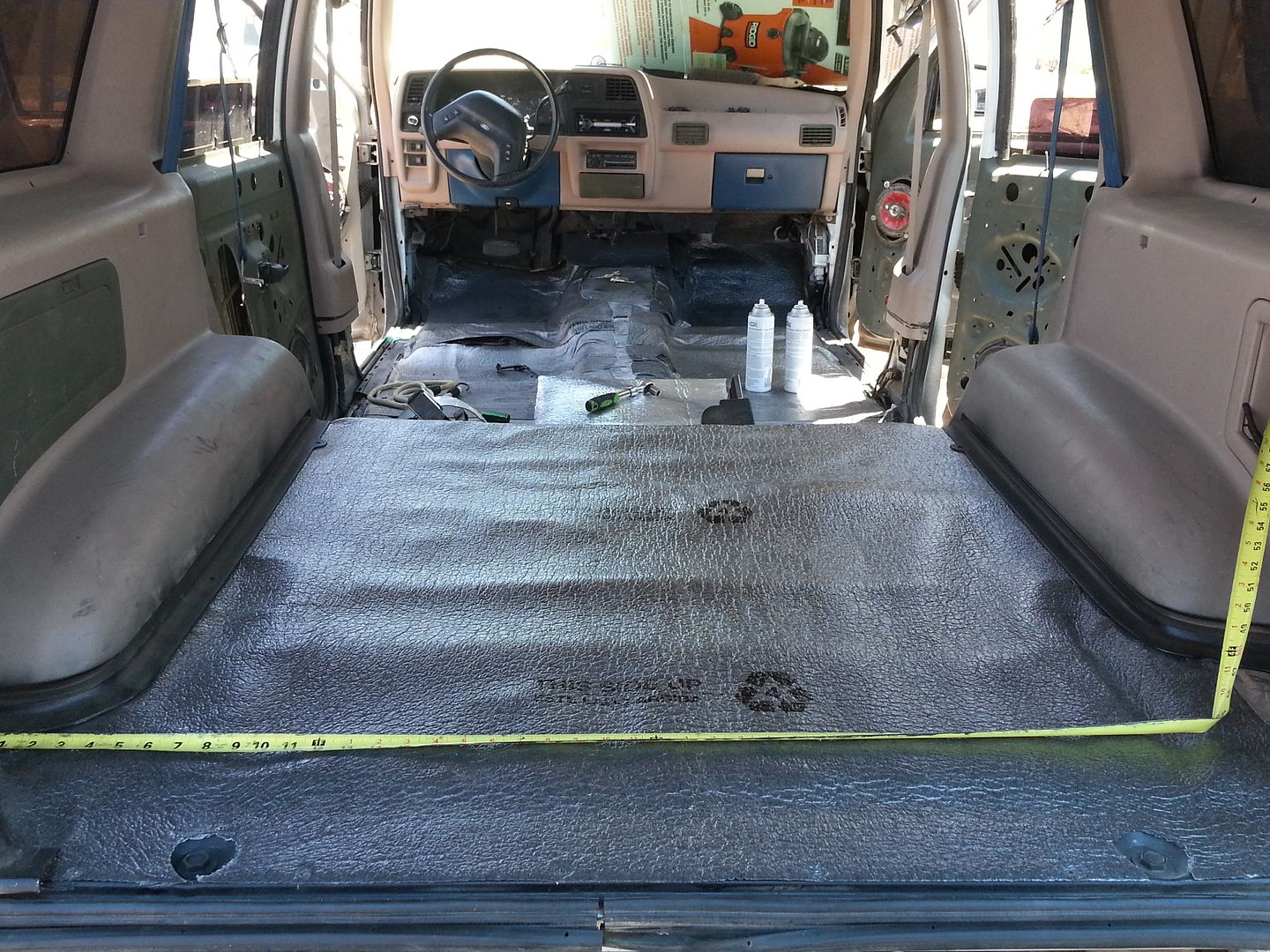

Day I hought it
Had to fill 75 7/8 holes in the floor.
URL=http://s902.photobucket.com/user/madzukr/media/Mobile%20Uploads/VZM.IMG_20160506_182023_zpskyg7kgna.jpg.html]
[/URL]

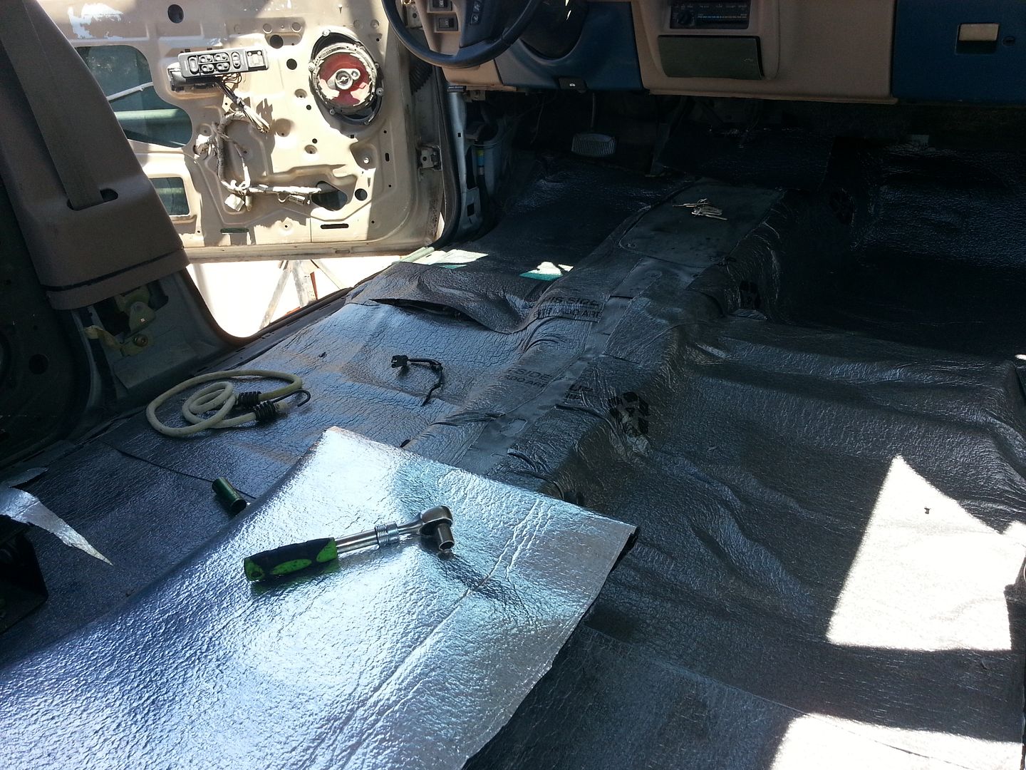

Reinsulate and cover the floor

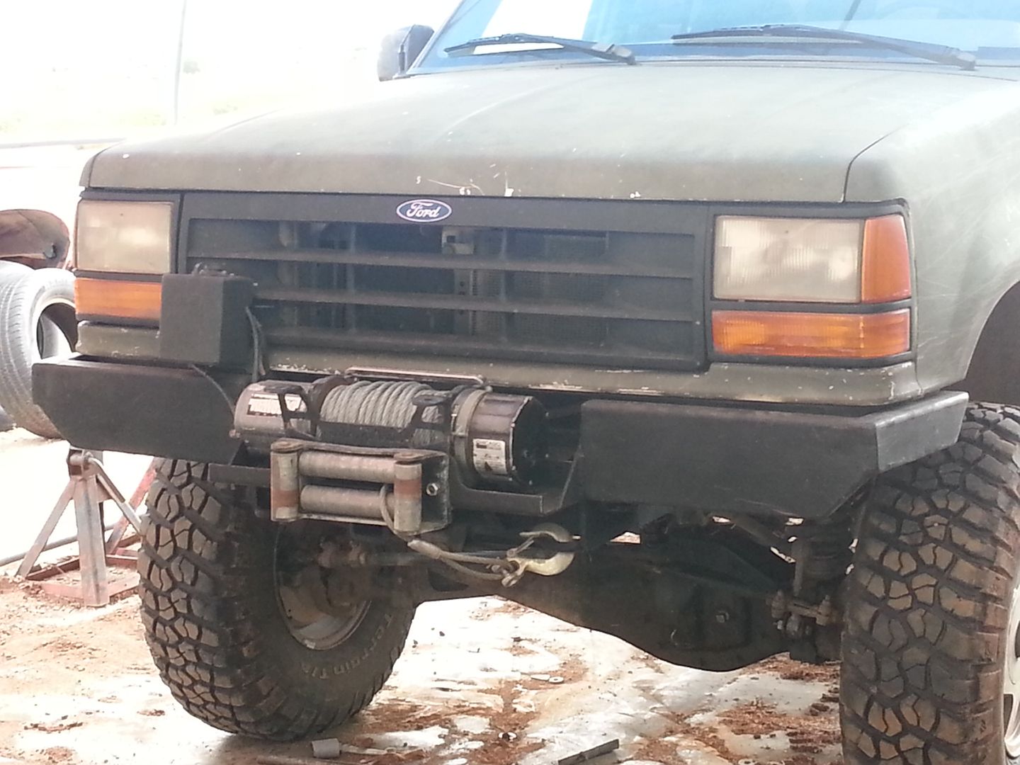

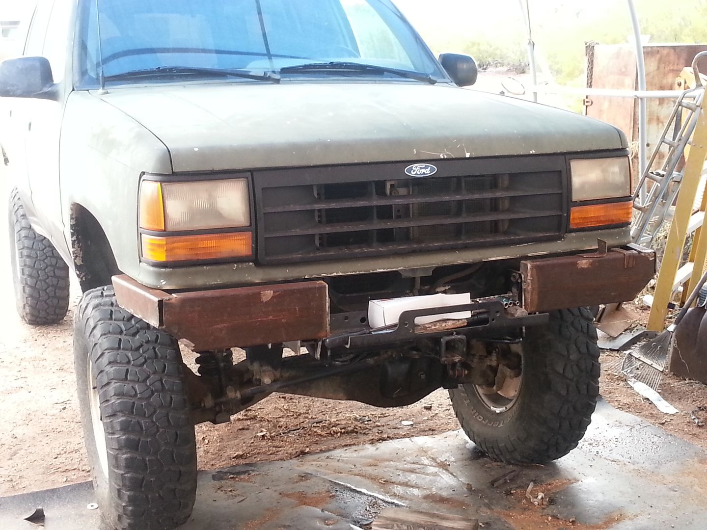

Built front bumper.

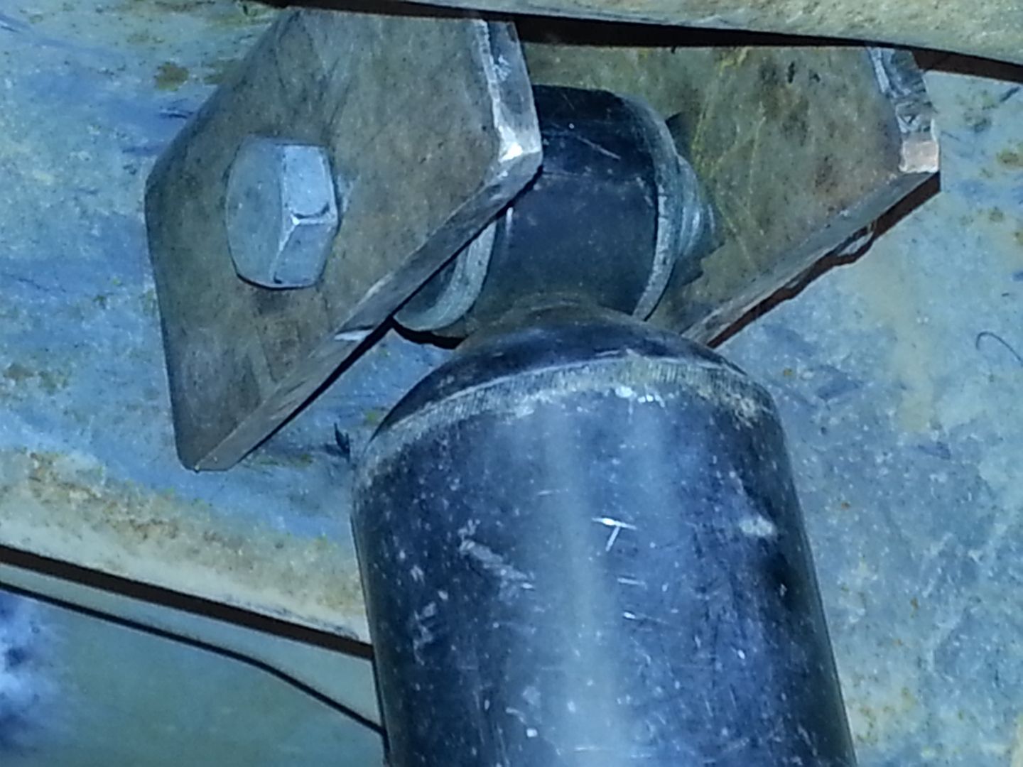

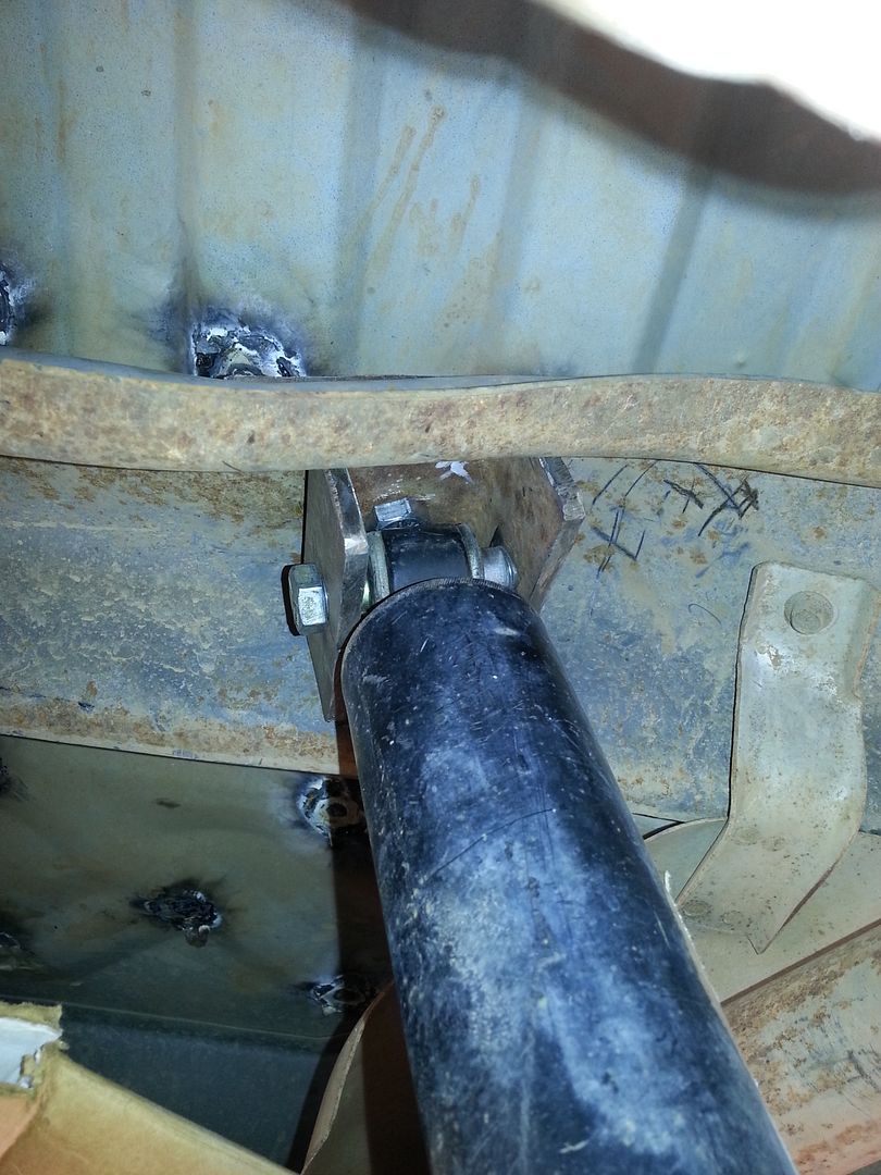

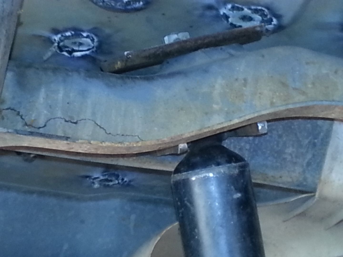

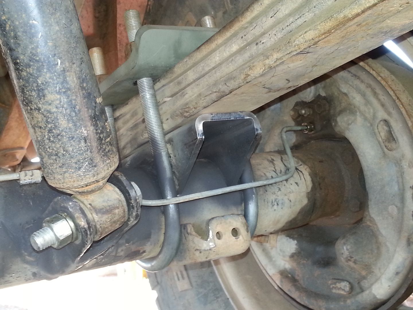

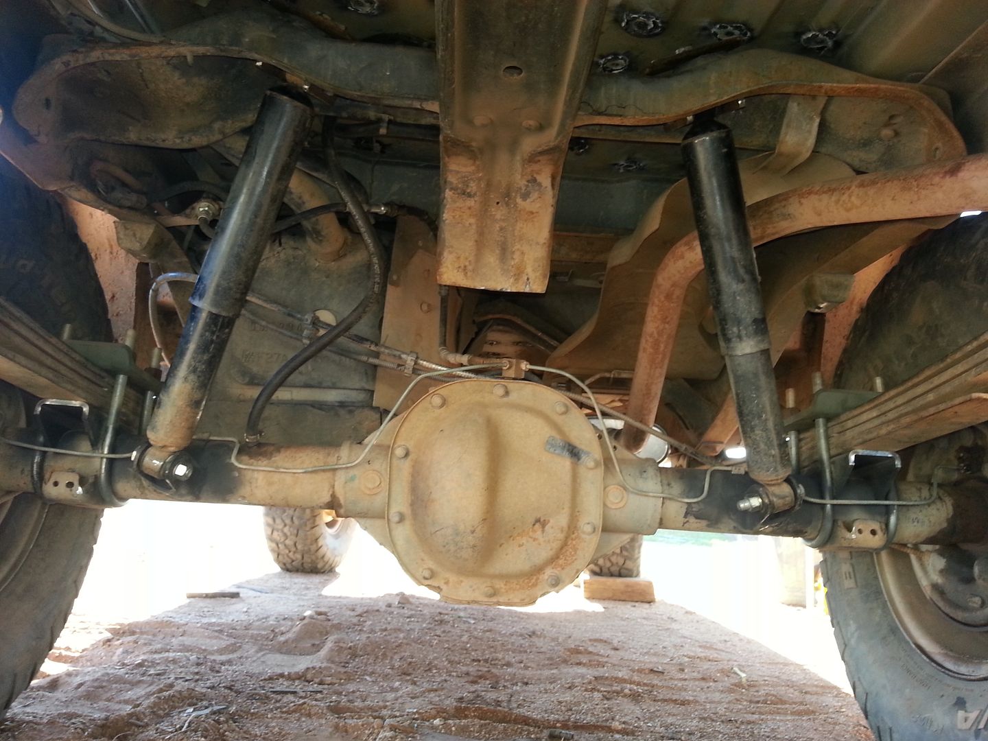

Wondering what you all are doing for rear shock mounts?
The axle has been sprung over.I'm waiting for new perches and doing a U bolt swap..doing so I'm loosing the lower mount. When I try to get a idea where the lower mount should be I can feel the upper factory mount bind.
So I'm looking for ideas.pics of your setups would help.
I'm on a time crunch.I need to drive it out of town for work in little over a week
U bolt flip and upper/lower shock mounts.
URL=http://s902.photobucket.com/user/madzukr/media/Mobile%20Uploads/20160905_074350_zpsn5jvvkau.jpg.html]
[/URL]
got out to do some testing.
The bolted in uppers seem to be working for now.
