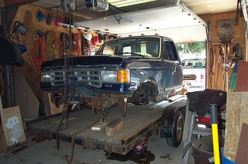

Ok, a BIG update.....plans have kinda changed.....

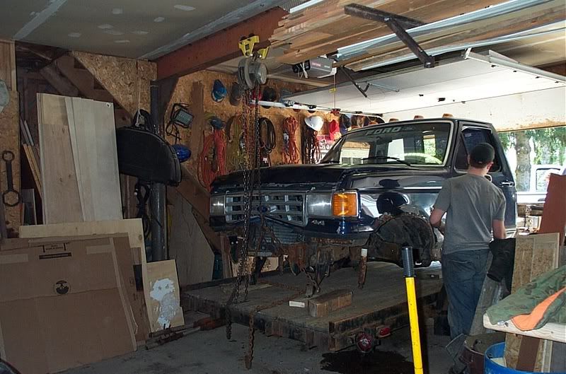

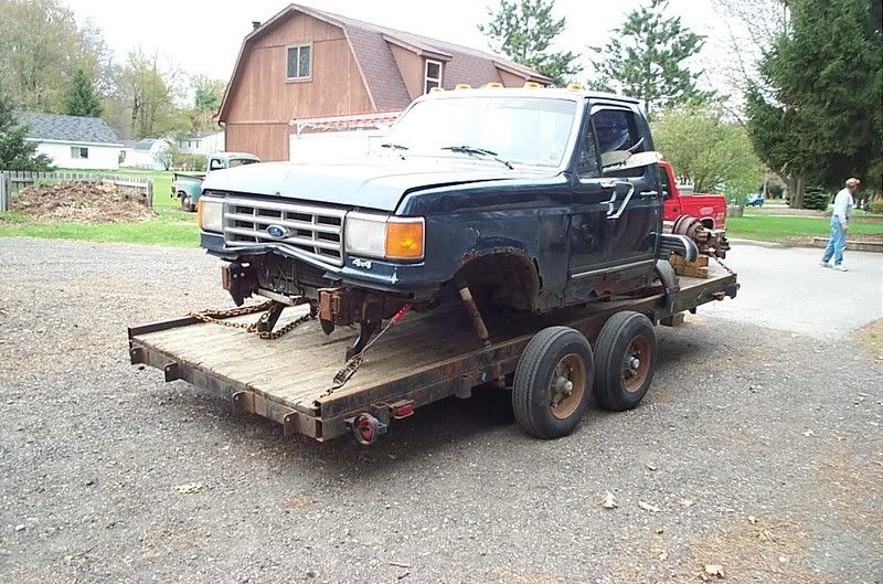

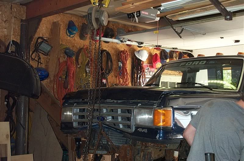

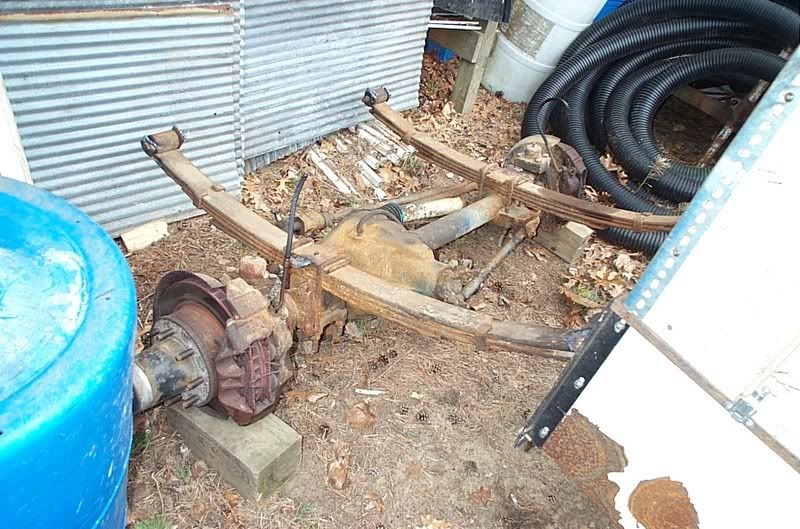

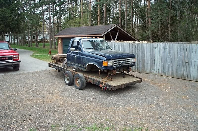

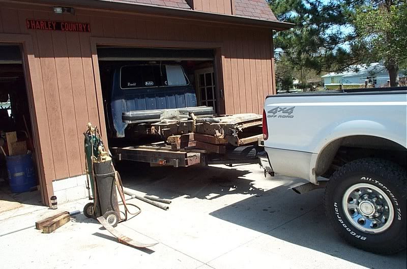

About a month ago, I picked up an 87 F350 witha 351 Windsor, C6 Transmission, BW 1356 T Case, Dana 60 High Pinion Kingpin front axle and a blown up Sterling 10.25 rear axle. I got the truck home and last weekend, set to work tearin it apart for the drivetrain. The truck ran but it ran really weak and leaked a lot of oil and the transmission slips real bad. The T-case won't go in low range easily and if it will it won't stay there. For these reasons and others, I decided not to use the drivetrain. I did however steal the Dana 60 High Pinion kingpin axle from it along with the 6" lift that was on the truck. I made ALL of the $1100 I spent on the truck back when I sold the flatbed, rims and tires for $725. I scrapped out the rest of the truck and got back $400. Here are some pics of the teardown....

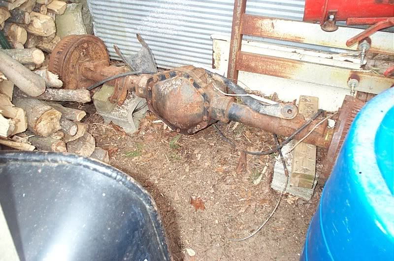

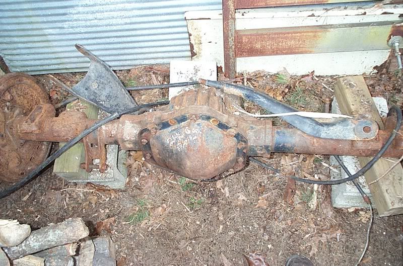

I also threw in a couple pics of my 14 bolt I got.
Now I know most of you prolly hate me since I just scored a Dana 60 for free basically.....but that isn't even the worse part.....Now you see, the auto trans...(A4LD) in my truck is friend and only 1st gear works. Well instead of rebuilding this trans. for a 4th time, I started looking into doing a manual trans. swap. I had planned on using an NP 435, but have now decided to use the stock 5 speed manual that came in my era of Ranger behind the 4.0 v-6 I have....which is the Mazda M5OD R-1......This is the trans I plan on swapping in. Well I know the easiest way to do this is find a RBV vehicle of the same body style with the same engine and with the manual you want and do the swap......Well as most people know.....this is easier said than done............

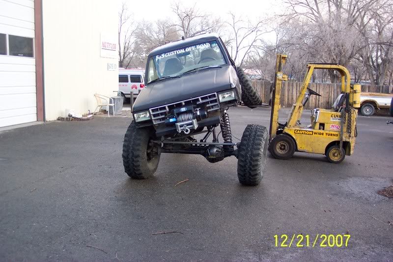

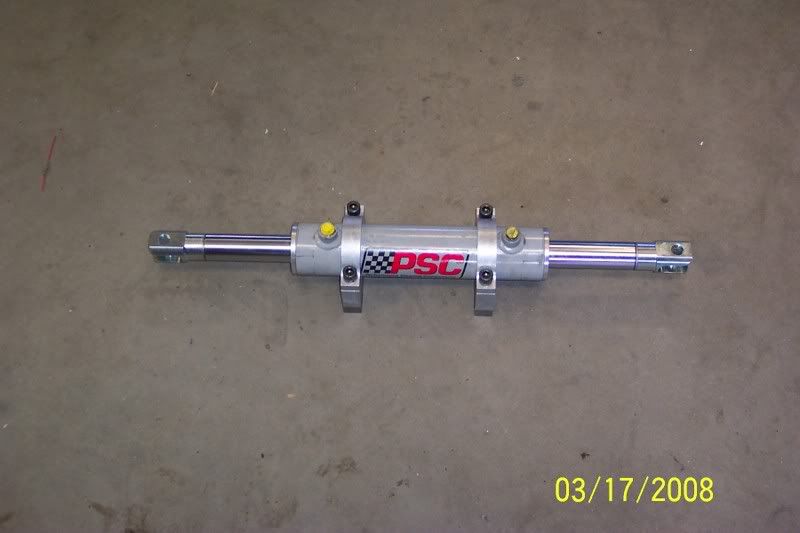

Here are a couple. The steering is hi steer with the box in the stock location. I am doing hydro right now because the stock box just plain sucks.
Underpowered, Overbuilt Ranger build....-w- air shocks, 4 linked Dana 60 front & 40s
whats the deal with the winch connecting to the axle, is it a limiter or something when not in use, just curious
