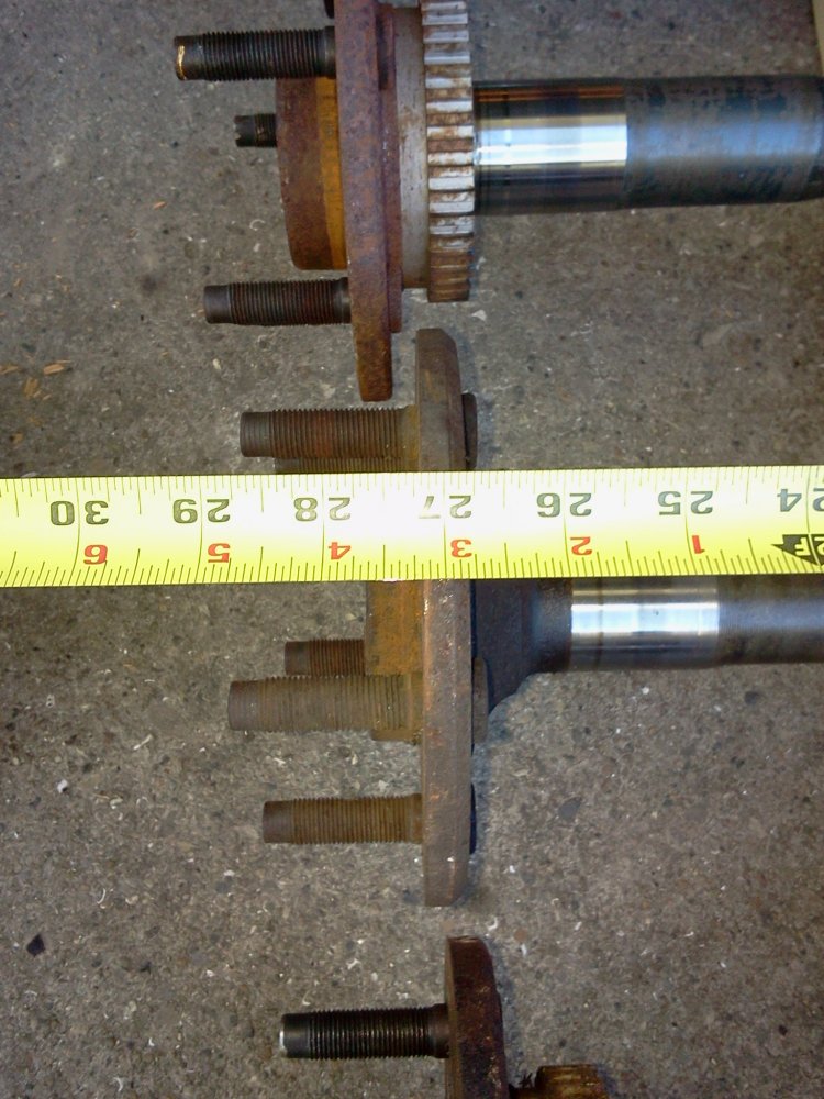

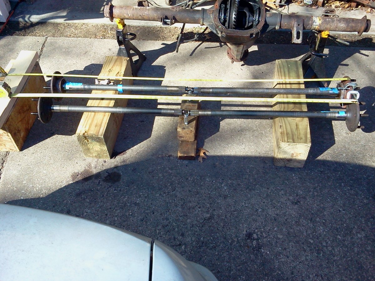

ok, I'm on a roll now, a slow roll though. above is 2004 short shaft at 27-3/16"

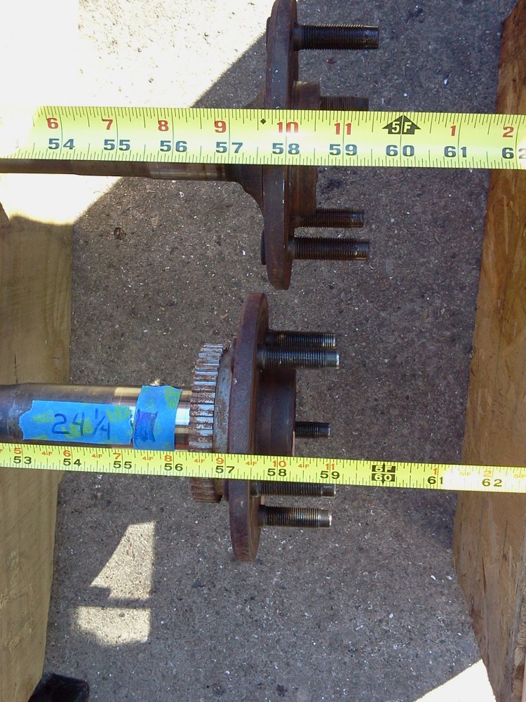

above setting the shafts even to measure total width
above spacers in center to replicate diff pins for total width
above 2004 measures 58", 2010 (with tone ring) measures 57-1/2"
the 2010 is 1/2" narrower than the 2004, that is corrected by the disks.

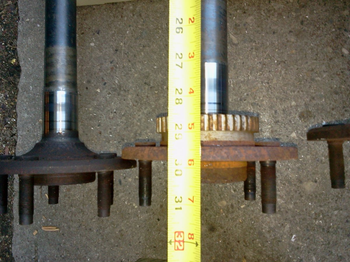

2010 shaft with tone ring, 2004 plain

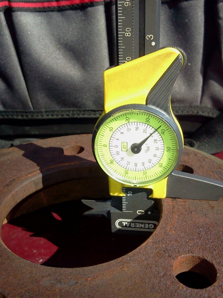

above the center thickness of the disks is freakin' huge at 3/8". they are approx 1/4" thicker than drums.

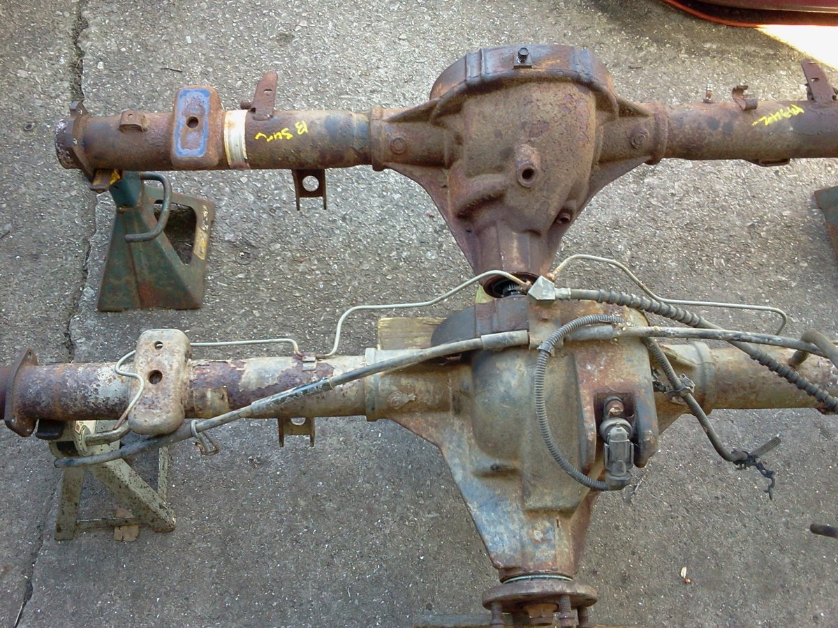

above 2 diffs. 2004 has ABS sensor on diff, 2010 has a tone ring at each wheel. the unused hole
in the 2010 does not line up where a tone ring would be.

above how I measured the shafts

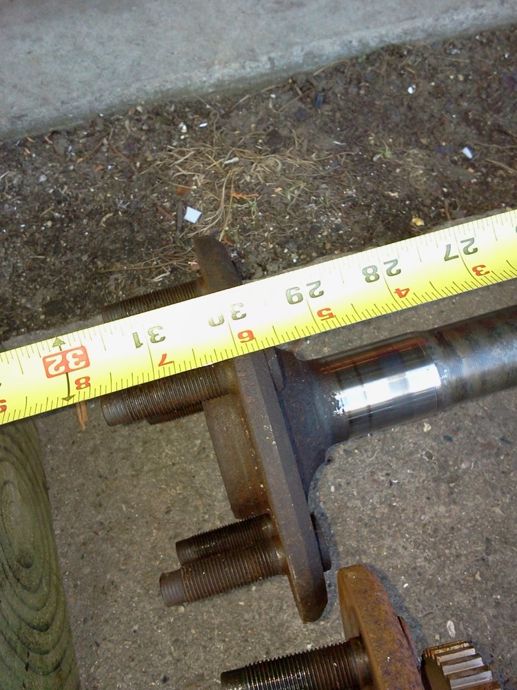

above long shaft 2004 at 30-1/16" its about 1/4" longer than the 2010 at 29-13/16"
above 2004 long shaft
above 2004 again
above ends again
above the most important pic. the blue squares are where the bearings ride, measurements are
from the end of the axle to the bearing.

above shafts

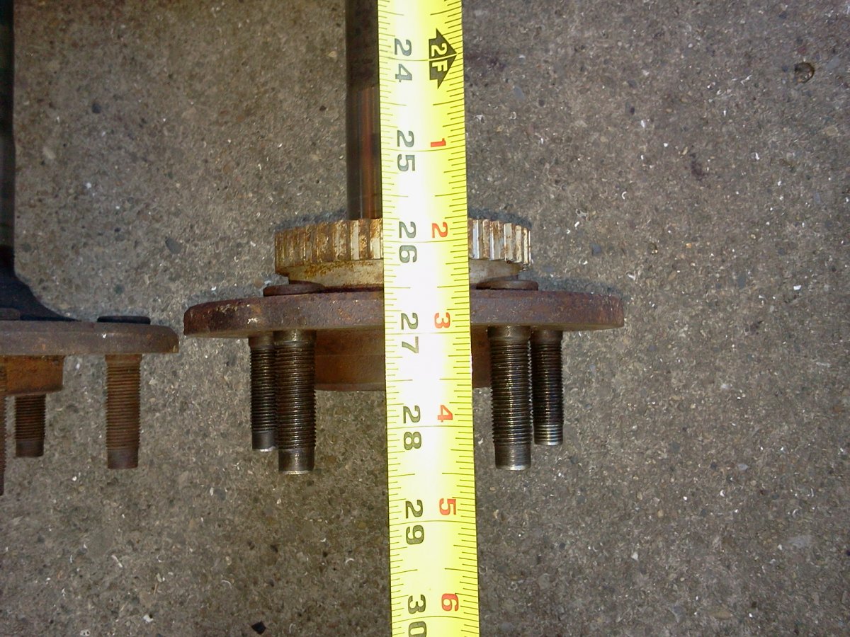

above 2010 short shaft at 26-15/16"
above 2010 flanges again

comparing a 2004 8.8 28 spline small bearing drum vs 2010 8.8 28 spline big bearing disk.
note the ends are very different, and the 2010 has no hole for ring gear tone ring.
the 2010 is 1/2"narrower. 57-1/2" flange to flange. put the disks on and it's 58-1/4" between wheel mount surfaces.

center of disk 2010, 3/8" thick

how I measured overall width, pin is inserted between shafts
41806
comparing the widths,,,the blue tape is where the bearing rides, that's the 2010 axle

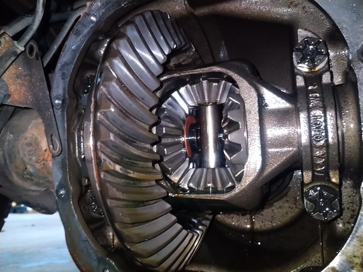

Just saw this. Need to replace my carrier in my 2011, so looking for axle info. Noticed @pjtoledo had info on 2wd, so I'll post what I have on 4wd.
Had my diff open the other night. Forgot to count splines. But, someone may see something that I do not. Will disassemble and post photos in the near future to see if the same as 2wd rear at 28 spline, or if heavier 31 spline.
Will say explorer axle swap u bolts and spring plates fit, though. Earlier hardware off a 2005 does not.
