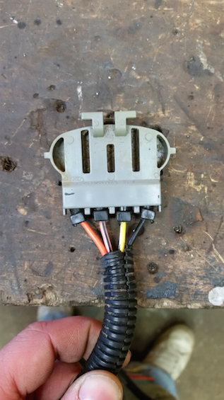

My truck is an '83 and was originally carbed and I'm doing a 2.3 turbo swap so now it will be fuel injected along with a turbo. The truck now has an '86 efi fuel tank along with the duel fuel pump set-up from the early efi rangers.
So, I grabbed the connector from the junkyard and cannot find a wiring diagram for it online. So does anyone have the wiring diagram for this connector?
fuel pump connector wiring diagram 1st gen.
Pink is power to the pump, yellow is fuel level signal, black is ground, I think orange is also a ground.
Yes ^^^, and Orange is Ground for pump
