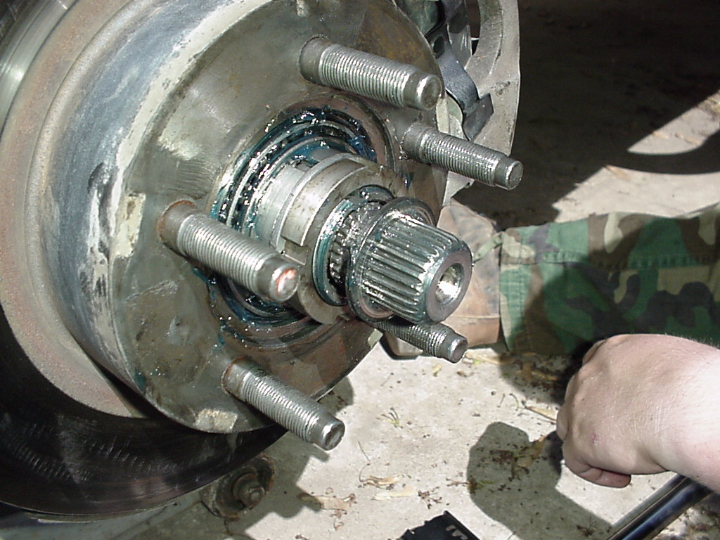

With the locking hub removed, you'd be able to tighten that allen head easily.
On the Dana 35, the hubs just slide over the top of the spindle and spindle nuts, and are held on by the wheel/lugnuts
