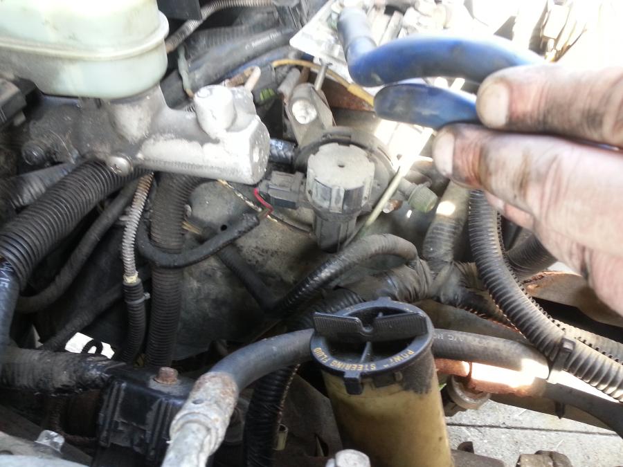

I've recently had a p0171 code pop up.
I can clear it and it's back within 10 minutes, whether the engine idles rough/surges or not.
I also have had p0442 ( I believe ), evap code, I didn't really care about finding it.
I haven't been able to do any checking on my crank sensor in regards to the ignition timing issue, however the more I read about it the more it seems to either work or it doesn't, but I will pursue this when I have some time.
So on to my question regarding the 2 codes above.
I've shot brake clean and carb cleaner all over the place with no change in idle.

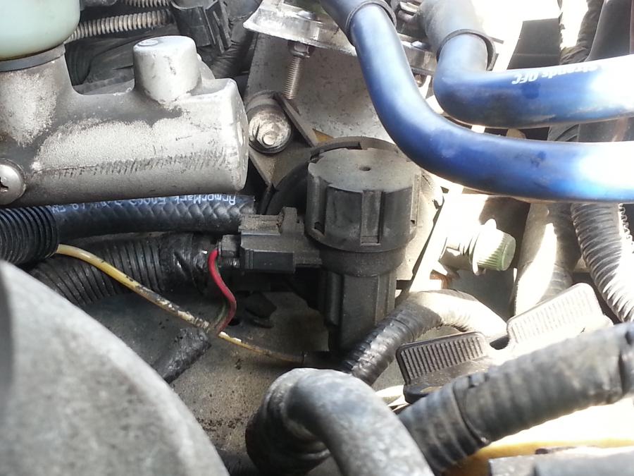

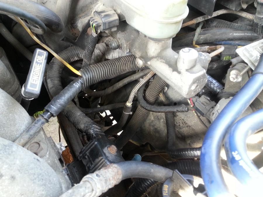

Today I went out and started the truck, went under the hood and proceeded to wiggle any vacuum line I could see.
When I got to the drivers side of the truck I found a bad vacuum line.
The line looks to come from the underside of the upper intake (metal tube) then to some type of a switch located on the wheel well between the battery and the master cylinder.
The switch has a much larger line that travels down the frame on the drivers side.
The switch has these 2 hoses and an electrical connector on it along with a cap and I assume a sponge under it to vent to atmosphere.
I don't know what this is, but I wonder if it is the cause of both codes.
I'll clear the codes again and see if either code shows back up.
Does anyone know what the switch I'm referring to is?
I can post a pic tomorrow if necessary.
Thanks.

Could be the vac leak causing too much air in the system...more common on carbs as far as really killing an engine...but if big enough the vac leak could cause your symptoms for sure...could be other things so maybe go over the list in the article just in case...
Thanks Mark.
I think this could be the cause of both codes as the hose appears to be a big leak into the intake after the throttle body.
The hose tht was leaking/half broken is directly above the pvc hose.
I'll take some pics and post them on thurs.
My time is very limited due to my moms health conditions, not life threatening, but mobility problems and very time consuming. So I find the time when I can.
I try not to leave people that are trying to help, hanging, that's just wrong in my mind.
I may be slow due to this, but I very much appreciate your help.
The 0442 code (popular) fix was to replace the gas cap and if it still appears take it to someone with a smoke machine to find the leak, I never did either as I'm a cheap bastard, LOL.
No problem, I know what health conditions can do to a schedule and things we take for granted. Take your time...I've been around long enough to see answers coming six months or longer...but always good to resolve things quickly when possible.
The gas cap was one of the things that I never suspected as being a problem...but fuel injected systems with too many sensors can be set off by the slightest things...as I learned when I borrowed a friends Pontiac Montana...the gas cap can throw codes on those things that are misleading...even just removing the cap and putting it back on can correct an otherwise scary code (Catalytic failure was one I saw on a Toyota)...
Anyway...hope that helped and gets you out of that error code!
Yesterday I cut the break out of the hose, it's a little short, but It's not pulling off.
Today after work I got some new 3/8" fuel hose to replace the bad hose. I'll replace it tomorrow and get some pics of the switch it connects to.
So far I have ~50 miles on it with no code shown.
The p0171 shows up pretty quick, but the p0442 takes a while before the CEL comes on.
So far so good.
Thanks again for the help Mark, I'll update if anything else happens or if I figure anything else out.
So far I still have no codes displayed.
This is the "switch" I was referring to, but don't know what it is.
Also the metal line coming from the intake manifold.
I also don't know why there's a capped fitting , like an AC fill connector on the right side of it.
