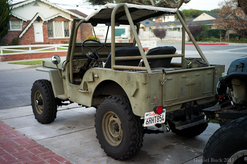

This is my little jeep, it's slowly and slowly becoming less and less original jeep, but it's a fun project :) Right now I'm working on the new steering, and 4 speed transmission swap.
Ooh, ahhh....nice details.
Digging the clamps.
