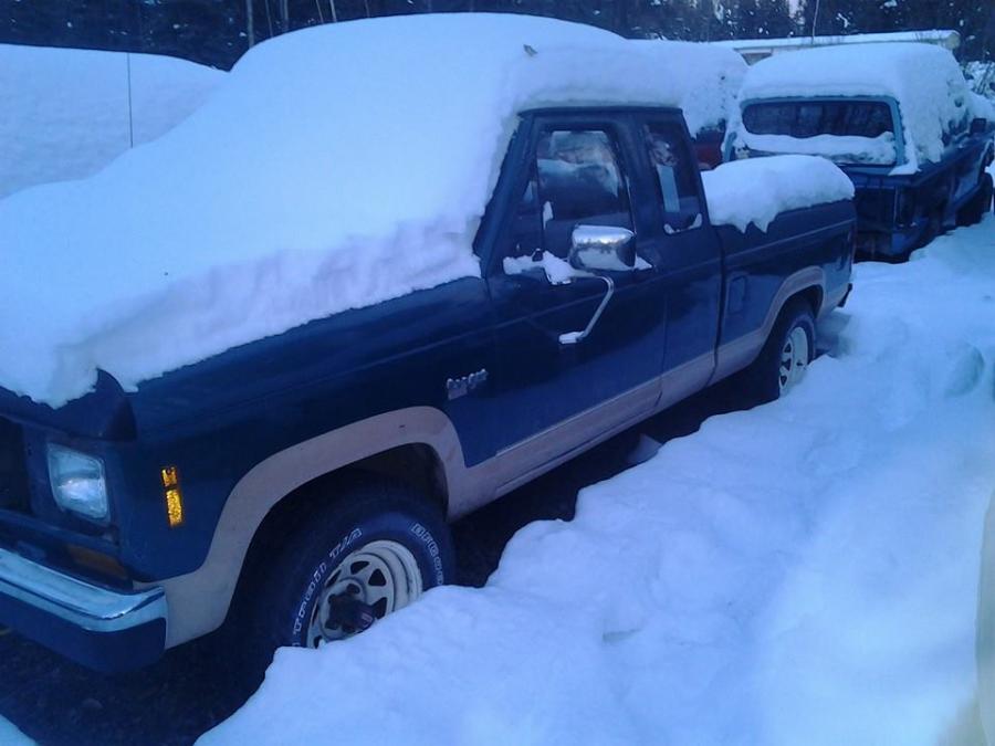

well this fall i got 20 rangers and bronco 2's from an estate settlement and i picked a 1988 Ranger ext-cab out to build. it's getting everything out of my 1993 explorer, the 5.5 lift ,4.0 engine plus manual trans & transfer case, both front and rear ends. the only things i need to add is a set of 64'' chevy rear springs and beltech 6400 rear shackles , extended radius arms and drive lines. hopefully i can come up with the money for a DD Machine doubler as well. 1st pic is new ranger 2nd is my explorer i'm gutting for this build.

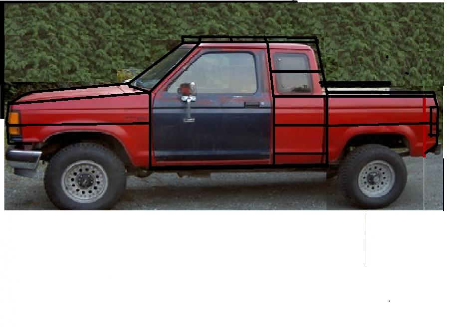

well i did a little photo shopping on direction i'm headed on my ranger once i'm healed up.

make tube fenders and integrated sliders for body protection.
the jungle gym thing is not for me.
your kinda stuck with exo on the majority of the cab with small trucks, but with a small amount of thought it can be done really well.
yeah the idea is to keep from pulverizing the body on some of our trails that are getting over grown. probably put my 38" TSL's on it with lots of drop and little up to keep center of gravity down. plus have a platform for a roof top tent i'm drawing up
if i did not go to full width axles i likely would have went to a full cab cage years ago.
bashing the body panels on these is not a big issue with heavy offset wheels on stock axles and large tires or full width axles. of course the bed when full length can get its ass kicked but your intention of decreasing wb will minimize that as well. front fenders are easy and cheap to replace...hoods are all over hell too. with your parts collection trucks not much of an issue for your in any case.
protection of the b pillars is something to be concerned with the most in my experience. and my tube doors have worked to that extent as intended.
i have mocked up some tube fender frames for the front wheels...actually made a set and sold them to a jeep owner... but i do plan to make another set for the front fenders as the rears work so well. simple straight cut design that will allow me to cover my tires due to the constant harrasement by the pa and ga police..... but simply painting the truck and slipping some 1/4 flaps has kept the cops off my ass. i really need sliders as well due to getting lucky so far. i just about destroyed my new doors last winter on a recovery operation after slipping off the trail and into the ravine......causing a triple recovery operation:D

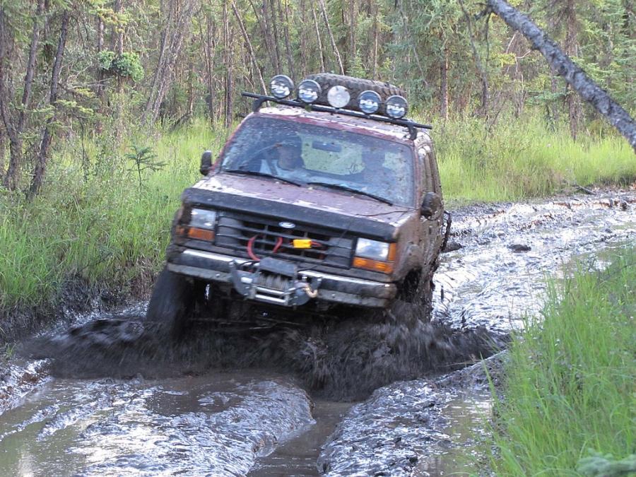

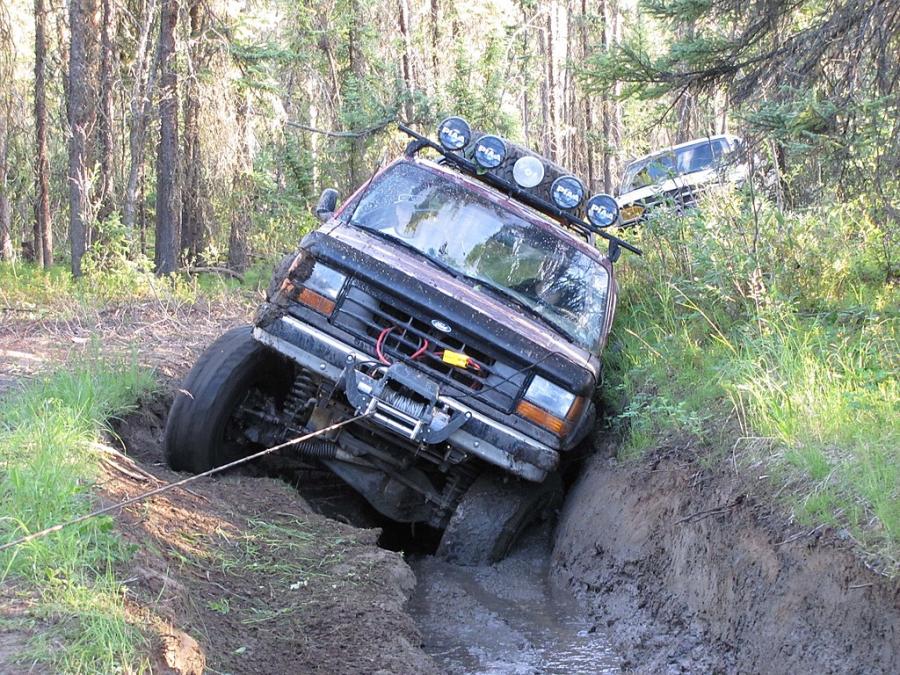

my other goal is to keep this truck streetable. we've got some trails here that Atvs and Utvs have torn up real bad. 2 years ago i had to crawl out my window to get out of truck.

streetable? subjective i guess. street legal is what i think your meaning.
your picture above is typical of my favorite places to go and things to do. usually only climb out of my window when on the side or roof....or the rear bumper and roof propping it in an undercut...
your truck as pictured...would be less "streetable" because it is so narrow.
fat tube fenders to widen it as far as track width to be "street legal" would also make it more streetable because it is wider...
i drive my truck all over.....
problem i had was the fenders got push in an packed full of dirt and mud.in front of the doors. they wouldn't open at all took 2 hrs at home and car wash to get them to open. Big Red(explorer) in currant form load rides great at 65mph.and a DD'D it last year.
