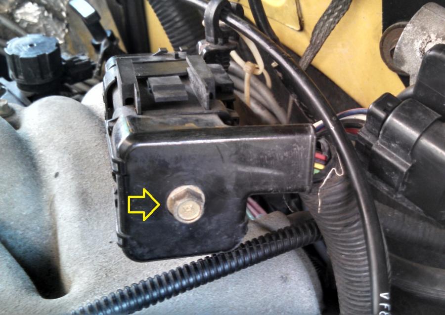

Step 1: Loosen the 10 mm bolt (yellow arrow) that holds the wiring harness connector together. The bolt will not come out of the connector, it's captured. Swing the harness away and let it rest to the driver's side of the intake.

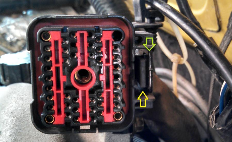

Step 2: Remove the female connector from the support bracket. The lime green arrow indicates the support bracket. Use the flat bladed screw driver to gently push the locking tab (yellow arrow) to the left (forward). At the same time, pull the connector body towards you (working from the driver's side front fender). Rest the harness above the passenger side valve cover.

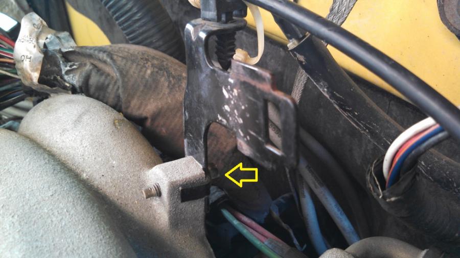

Step 3: Remove the 8 mm bolt (yellow arrow) that's holding the support bracket to the intake. Slide the bracket towards the passenger side while still retaining the throttle cable (if that plastic clip hasn't broken).

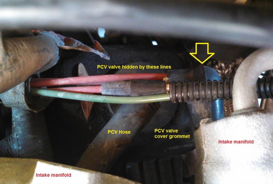

Step 4: The image shows the view from above, just aft of the intake manifold. Reach behind the intake and remove the vacuum line rubber elbow from the port on the intake manifold (yellow arrow). Be careful not to damage the rubber elbow. You should now have access to the PCV valve (from above). It is still obscured by the vacuum lines in this image.

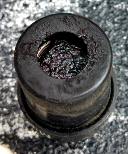

Step 5: Remove the PCV valve from the grommet in the driver's side valve cover. I was unable to remove the valve and plastic elbow from the vacuum hose. So, I simply removed the valve from the plastic elbow and then put the new valve into the old elbow. Replace the valve into the driver's side valve cover grommet.
Step 6: Replace the vacuum line rubber elbow onto the vacuum port (above the PCV valve). Yellow arrow indicates the location of the rubber elbow.

If I recall correctly, a PCV valve that still "rattles" should still be functional. However, they're pretty cheap and my old one had clearly seen better days.
