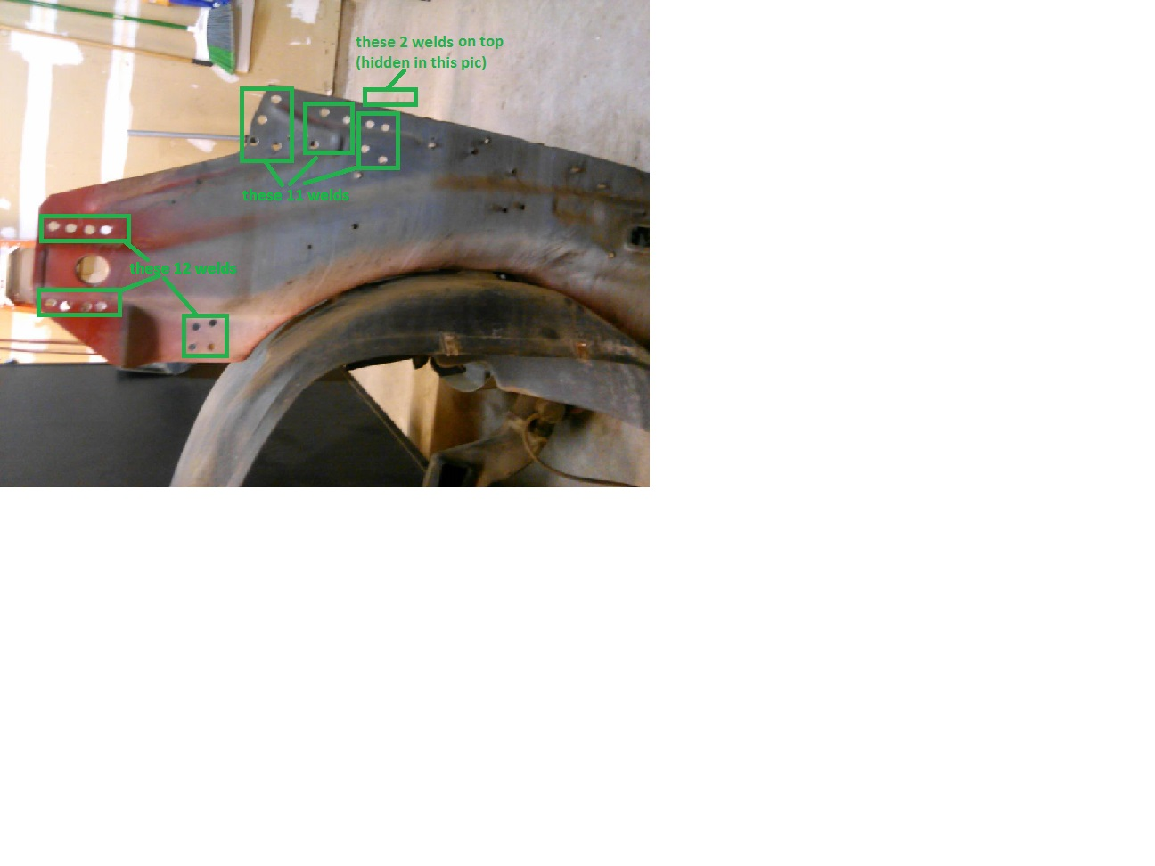

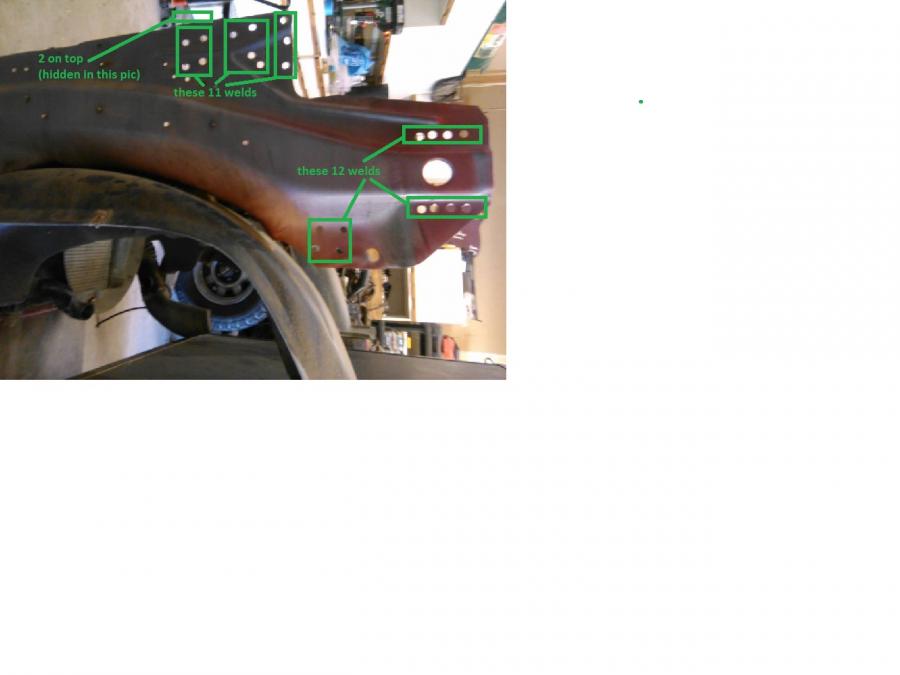

Locate the 50 spot welds on the outside of the inner fenders documented in the attached pictures. Put a divot in the center of each weld with a center punch.

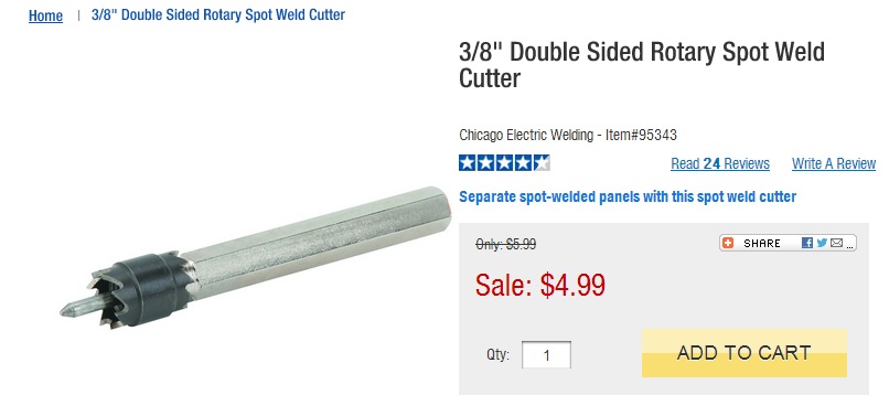

Use a spot weld cutter like the cheap one shown in the pic from hf to cut around the welds. ( take care to only cut through the first panel )

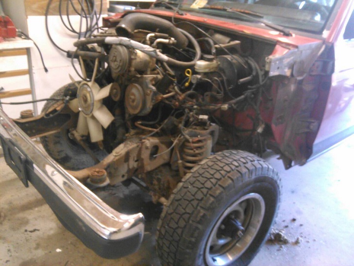

Have a buddy grab the other side and lift the front clip away from the truck.

I counted 27 spot welds per side when I did mine. I could have miss-counted.
I found the following bit much better than the one you posted and requires no pre-drilling;
Removing the front clip first gen ranger
[/URL][/IMG]
The bit is pricey at $14.00 each but I think worth it.
