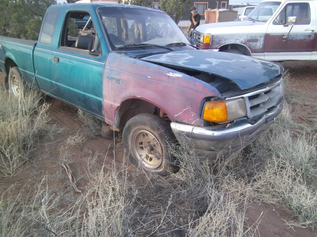

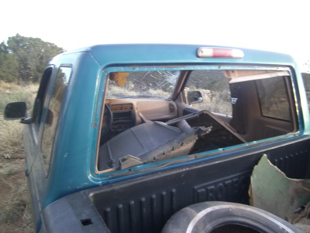

Ok so the truck wasn't really struck by a tornado but sure looks like it was.
Recently we picked up a 96 ranger 2wd 4 banger stick shift green with tan interior (well what was left of the interior.
Problems with this truck: Has quite a few dents but nothing some body work can't take care of, the interior is gutted minus dash, carpet, and a few interior trim pieces along with door panels, windshield is broken, left window is missing, back window is missing, it is green, the 3rd gen body style is not the best looking in my opinion, the truck's engine is missing and probably more.
Good: it was $250 with a tittle and was the same wheel base as my chassis I have.

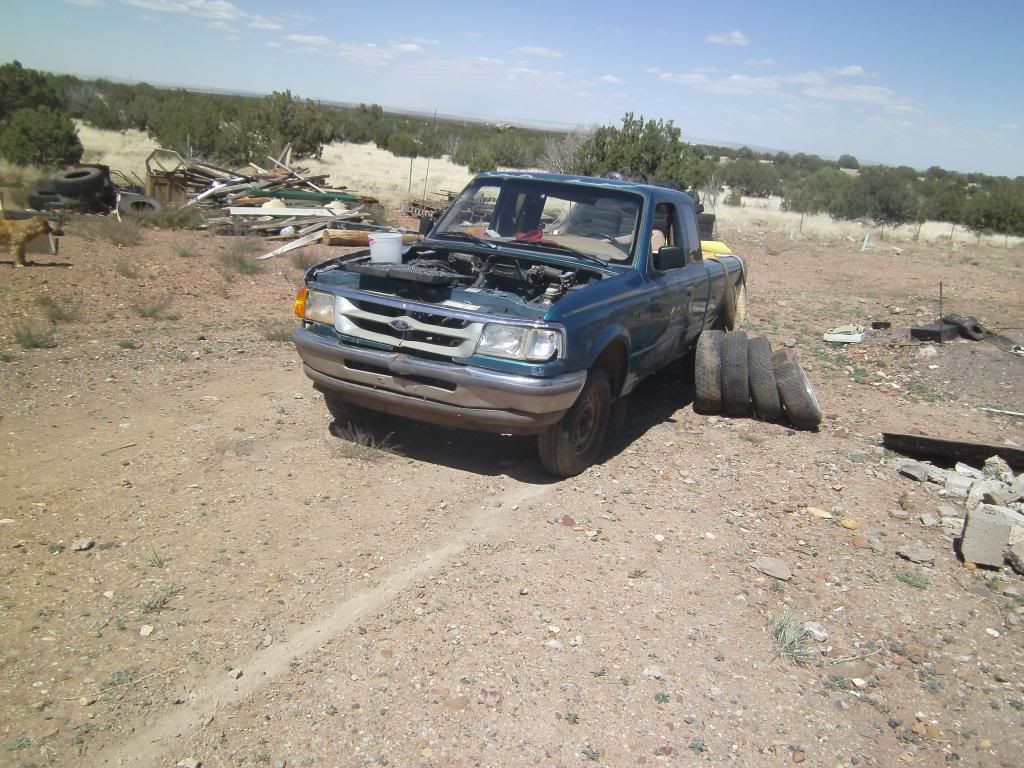

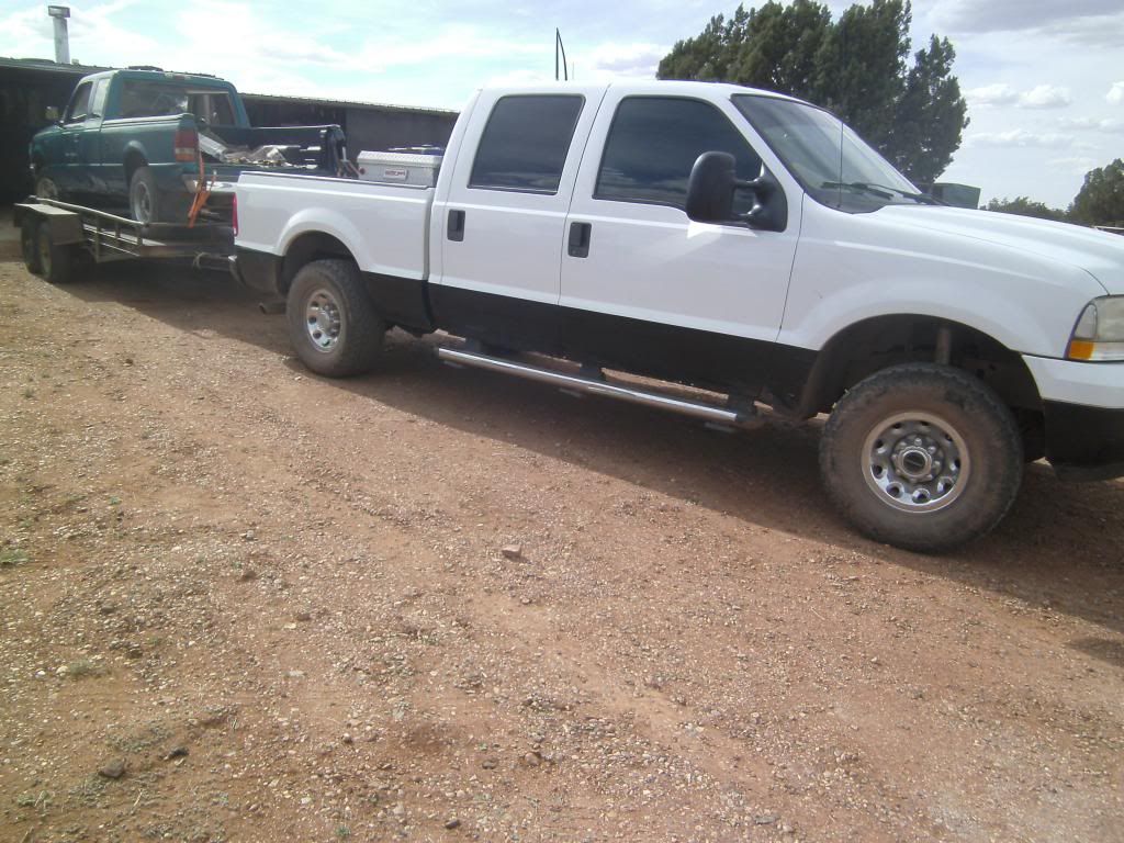

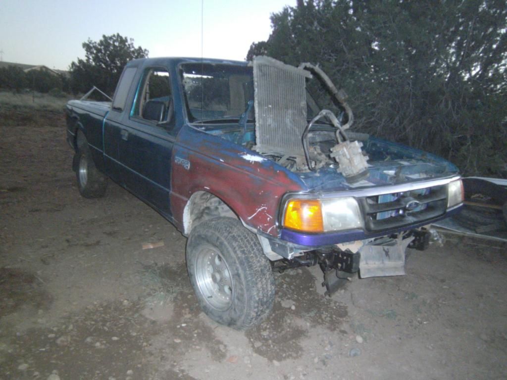

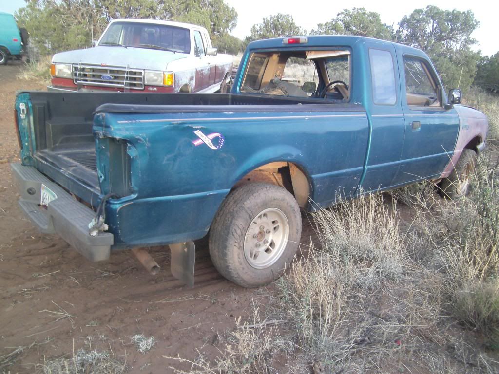

here are the pics of what it looks like right now.

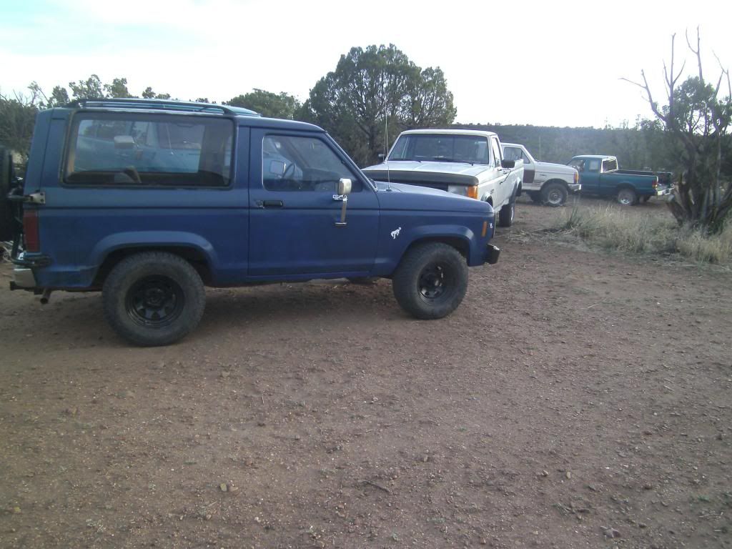

with the bronco 2, my F150, and my other brother's F250:

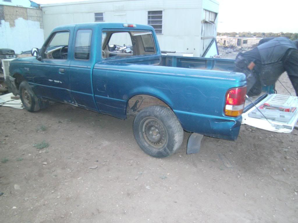

I did get the drop in bedliner out and the tailgate mounted:

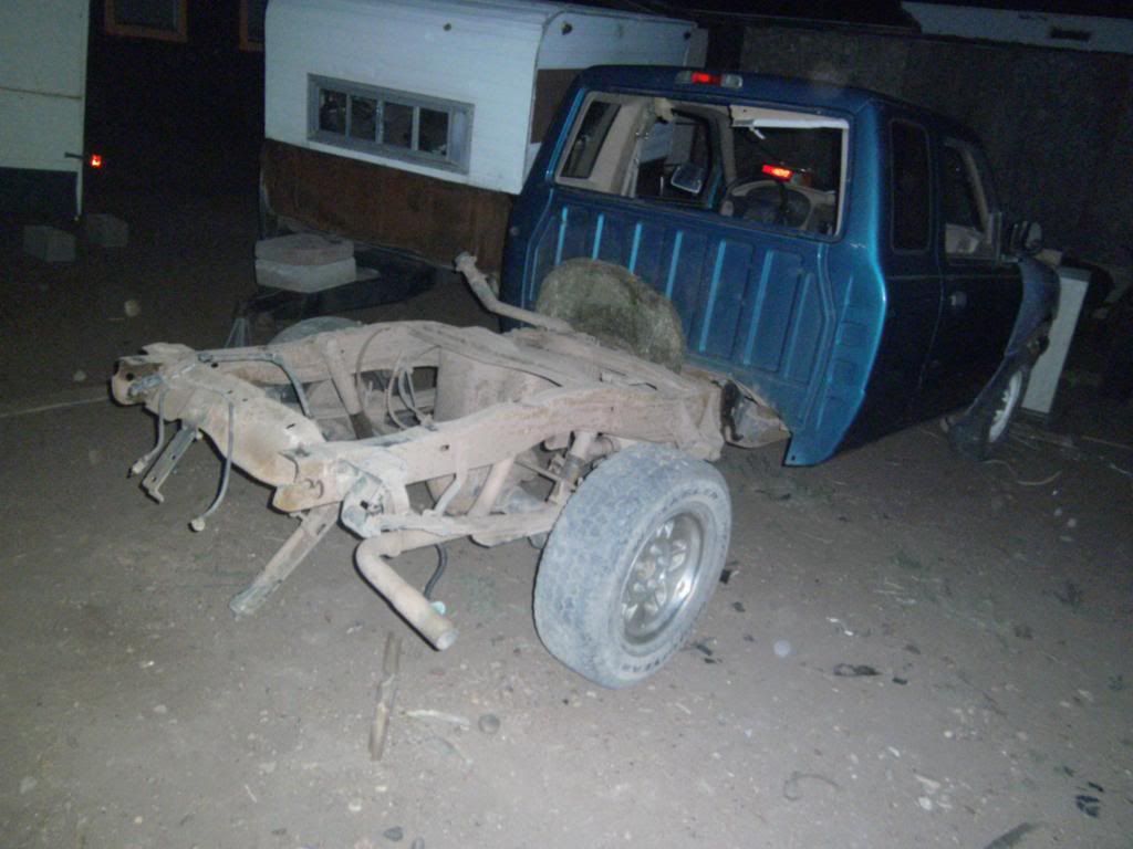

Ok finally got this party started and movin good.
Yesterday I knew having the 92 chassis one one side of the yard and having the 96 on the other was going to be a huge hassle so I went around looking for 3 5 on 4.5 wheels with pumped up tires. Found all 3 of them (2 off a trailer and 1 off our parts bronco 2 we no longer have) and got them on the truck. My dad decided he would use his truck so I don't have to mess up the explorer and since the Bronco 2 wouldn't start.

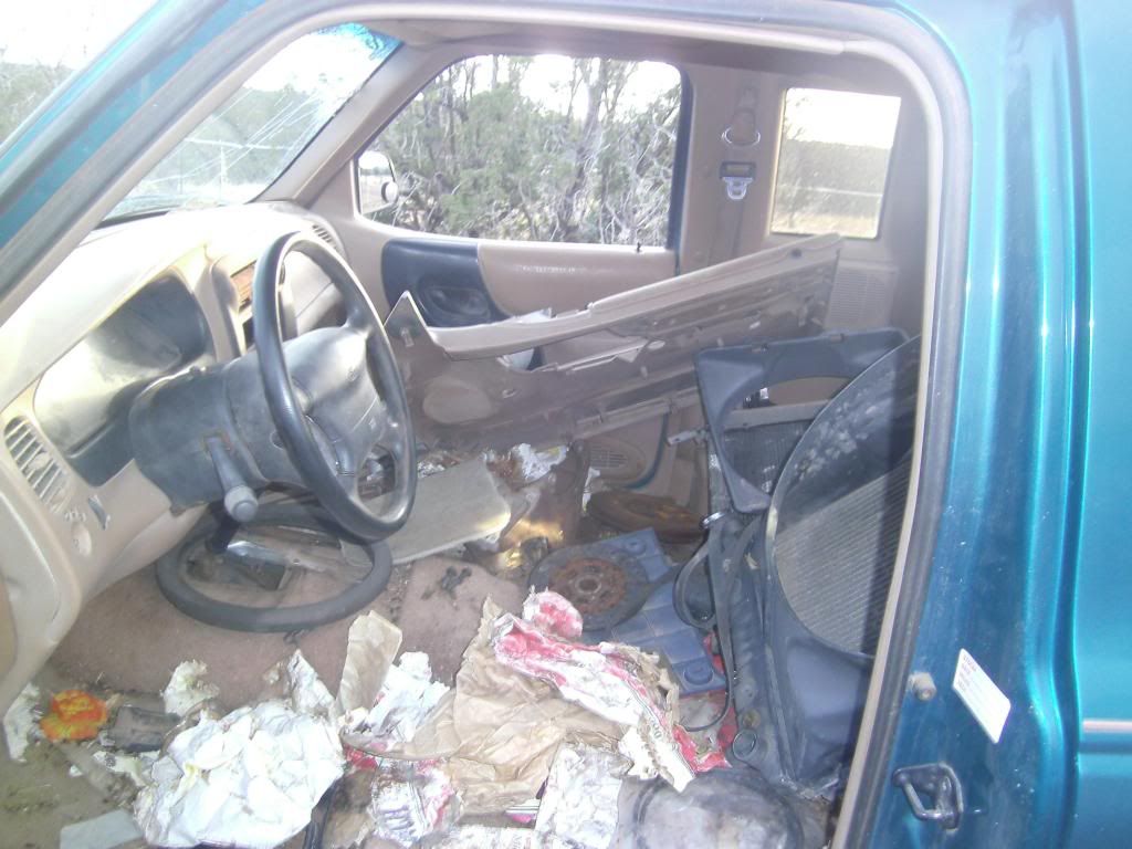

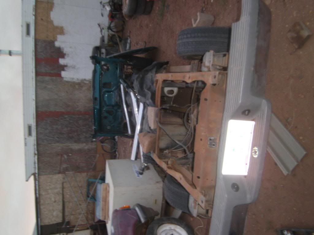

Dad backed his 89 F250 4x4 ZF5 351W truck up to the ranger hooked a tow strap up and I threw my youngest brother (the one whom the truck is going to) in the truck to steer it). Dad started pulling and next thing you know the left front wheel wasn't spinning I didn't care to much being the 89 was pulling it fine so I left it be automatically assuming it was the caliper stuck. So we pulled the ranger down to the back by the trash to clean out the interior. Got all the trash out and swept the carpet up well. Unfortunately I won't be using the 96s carpet being it is a stick shift. So once we got it cleaned out pulled it up front again by the ranger chassis. I wanted both side by side problem was I couldn't get the 89 in their so I unhooked the tow strap and my family of 6 (10 year old sister, mom, me, 2 brothers, and dad) all tried pushing it with the left front wheel not spinning. After I decided it wasn't going to work I decided I would see if maybe I could mess with the caliper to get it unstuck. Well turns out caliper was fine it was actually the wheel was a negative off set so the wheel was hitting the caliper not letting it spin. So I grabbed my star wrench loosened the lug nuts some and we pushed and sure enough it came free and we got it where we wanted it.

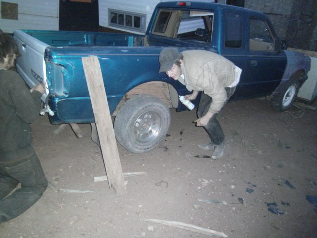

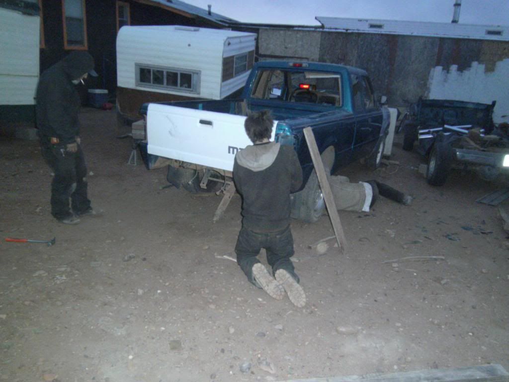

After that we had about an hour worth of work we got done:
first I pulled the rear bumper and mounted it on the 92 chassis since this bumper was perfectly straight. Then I pulled the tail light so it wouldn't get broken any more. Then I had my brother start pulling the bolts to the bed while me and my dad started some body work. Got most of the dents out but not all got to look today to see what we can do.
Also got the bed off the truck and sat it aside.
Before I install the bed I need to pull the 96 fuel pump make sure it is good if so drop it into the 92 tank since I tore apart the 92 pump for my explorer. Also have to paint the frame just going to rattle can it black but that is fine for where I am. Also going to swap the wiring that I need over to that frame and pull a few more dents from the bed then drop it on and install the tail lights.
Next will be the cab part of the truck.

Down in the back cleaning it out:

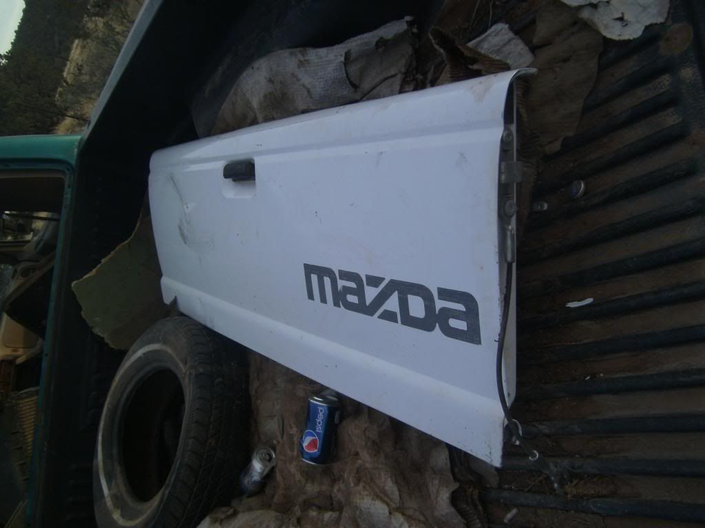

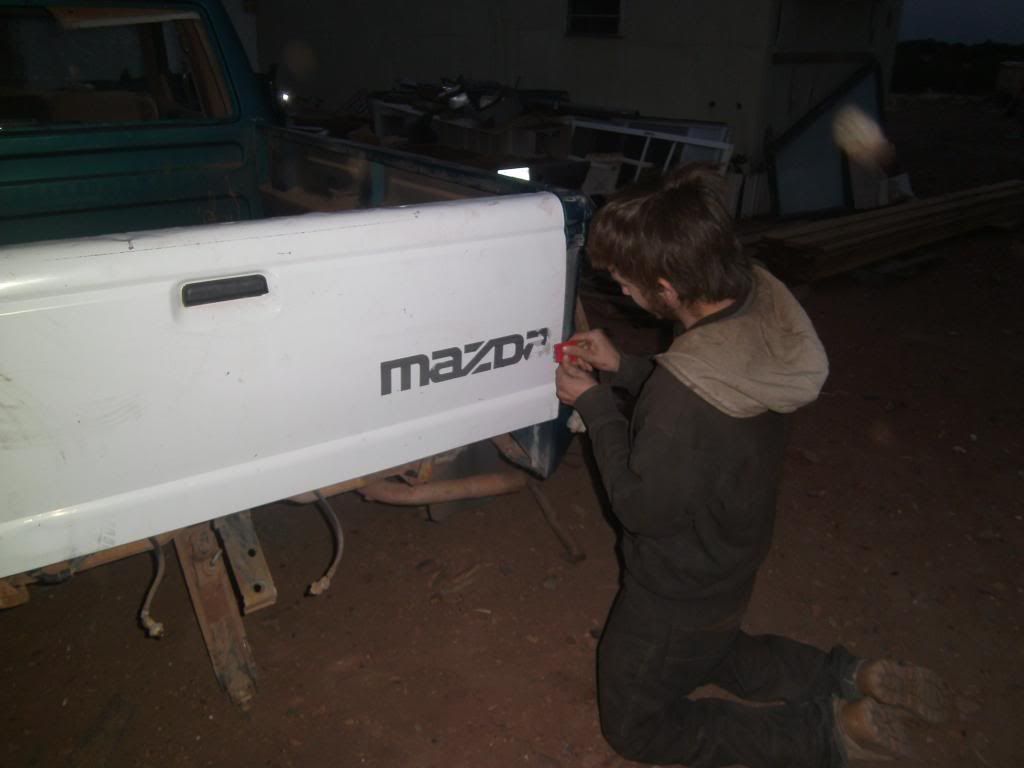

Youngest brother under the truck PB blasting the bed bolts, other brother with a razor blade removing the Mazda sticker, and dad examining to see what needs done next on the body:
not sure how much of the mazda he got off but I think he got most off:
Brother getting up from under the truck:

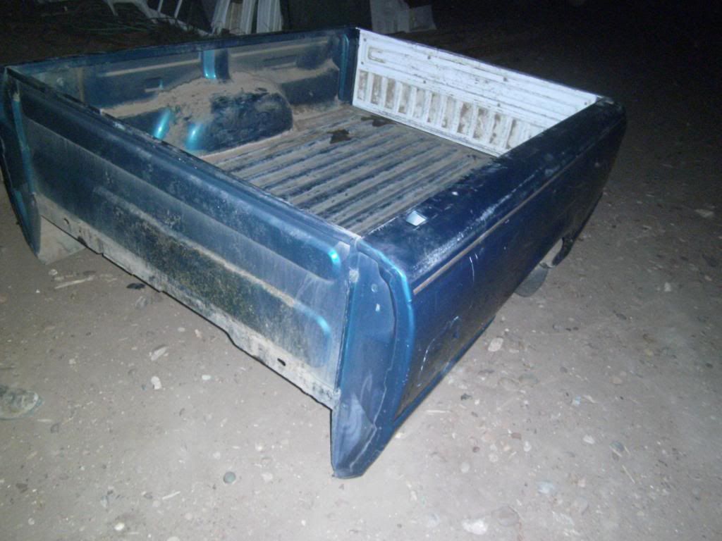

Bed removed (never knew Ford put hay between the cab and bed to stop rattling LOL)
Hopefully will clean the bed before I put it back on the truck:
Well a few updates.
Got the cab off the truck the other day right now it is sitting on a few pallets and mobile home tires sitting about to my waist height. LOL We are waiting for a decent day to paint the frame and start transferring what wiring we need to over.
Got the 96 chassis completely stripped and scrapped the frame. All I have left is the 3.08 or 3.55 open diff 7.5 rear axle for parts for the Bronco 2 and the 2wd front end along with 2wd trans.
also got what we needed minus the dash out of the cab. Once the truck is on the chassis I will start stripping the 96 interior that I don't want and dropping in the 92 dash.

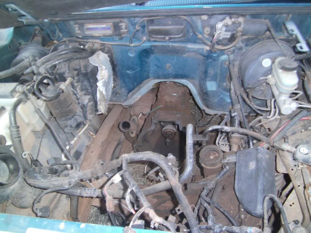

Took the firewall and cut what I didn't need out and welded in what I did need. Installed the A/C box from the 92.
Got the cab on.
Laid out the cab harness and installed it.

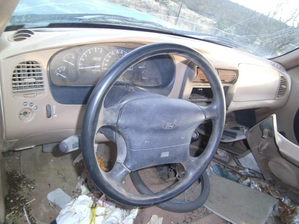

Got another dash from the parts truck and just waiting to install it (needs modifications)

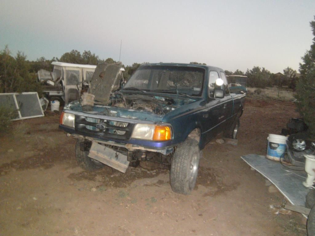

Got most of a new front clip mostly for a cheap price and installed it painting the grille black leaving the upper chrome.
