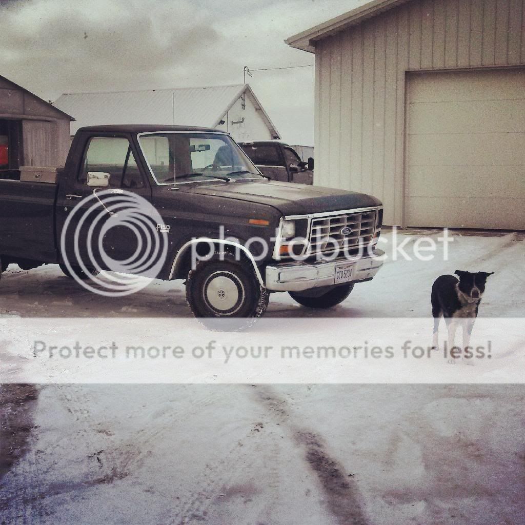

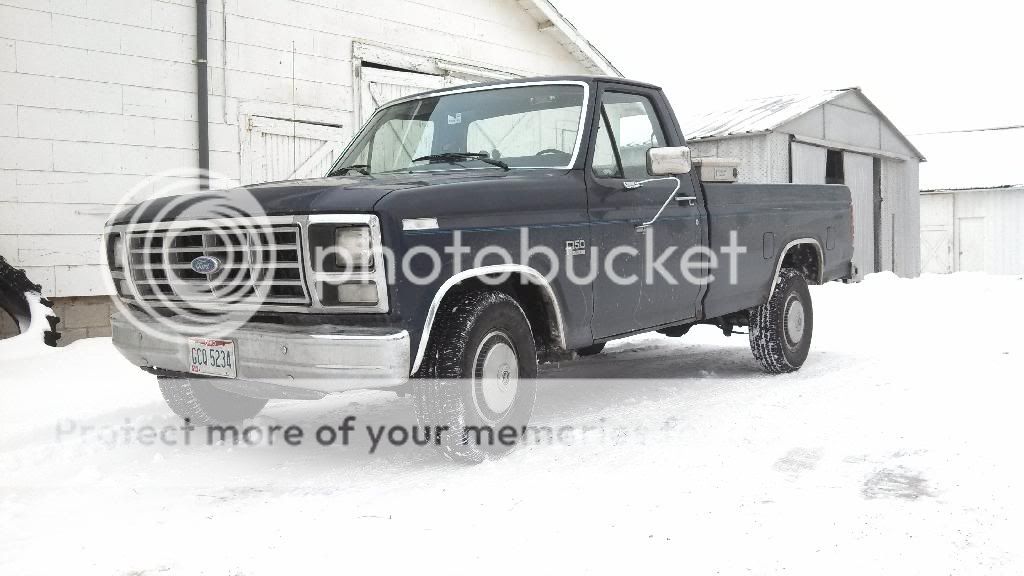

1986 F-150 XL, 5.0/C6 2wd. Just a tick over 70K on the odo. Factory cruise, A/C, crank windows, and tilt wheel

Overall the truck was pretty clean, a few spots of cancer on the surface that are not visible on the backside, and the damage to the pass front corner that includes the bumper, fender, and filler panel.

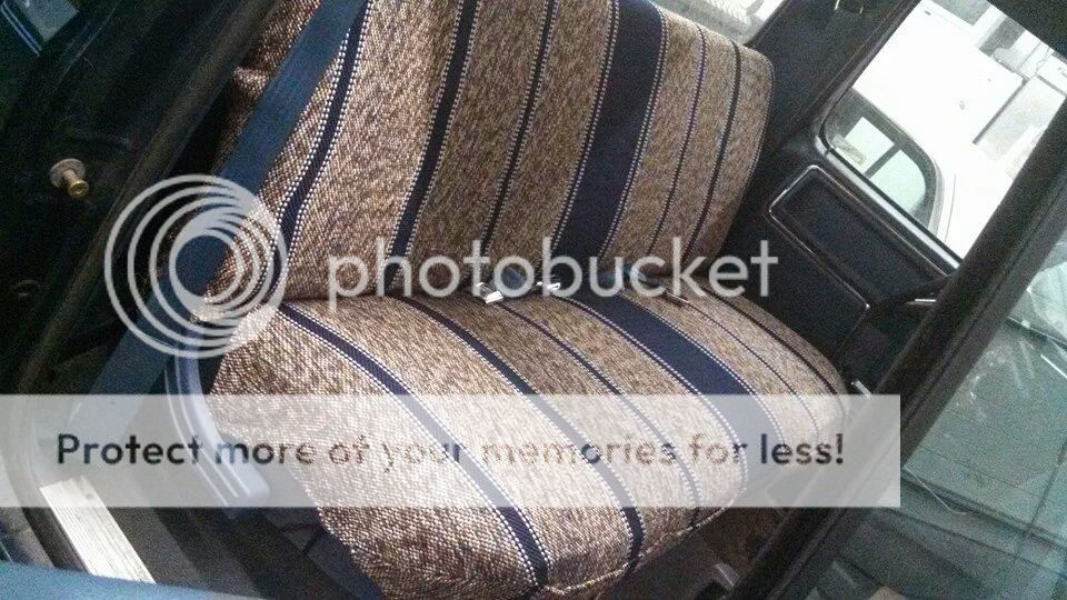

Next was making sure the minty fresh bench stayed just that. So I picked up a nice hideous saddle blanket seat cover...

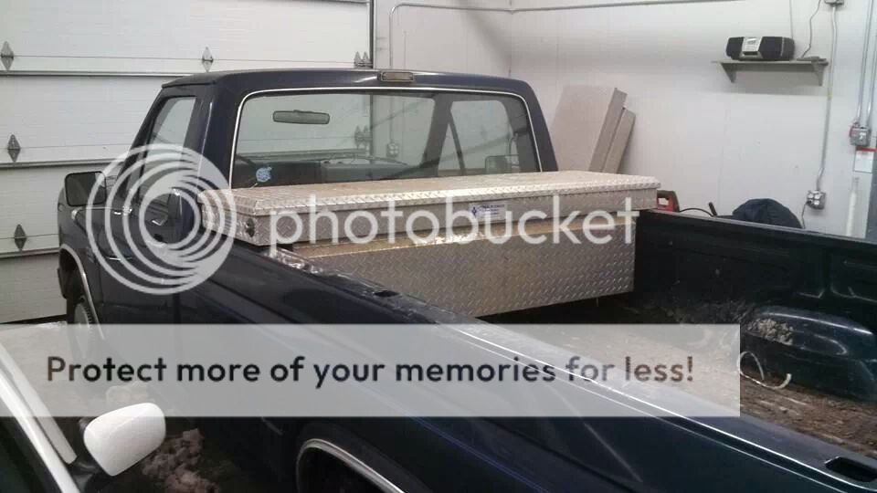

I swapped out the shallow dual lid box for deep single lid I had stashed in the barn.

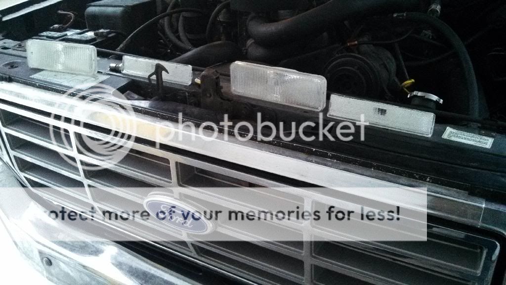

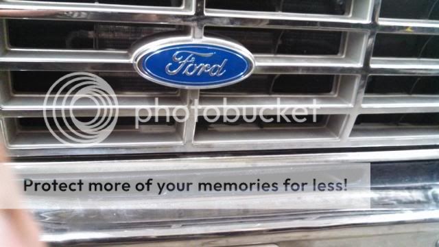

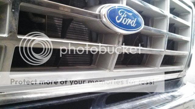

After a little searching and asking around I found a place that still sold clear front and side markers so I could ditch the awful amber...
PlumCrazy's F-1Fiddy Build
I also used chromed amber bulbs, so there is not a hint of color when the lights are off.

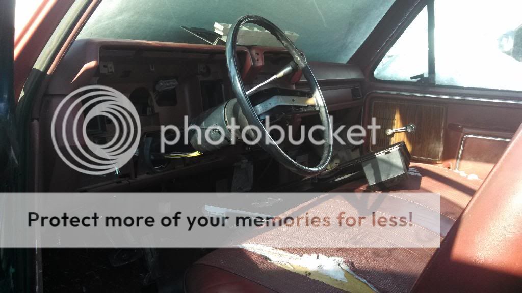

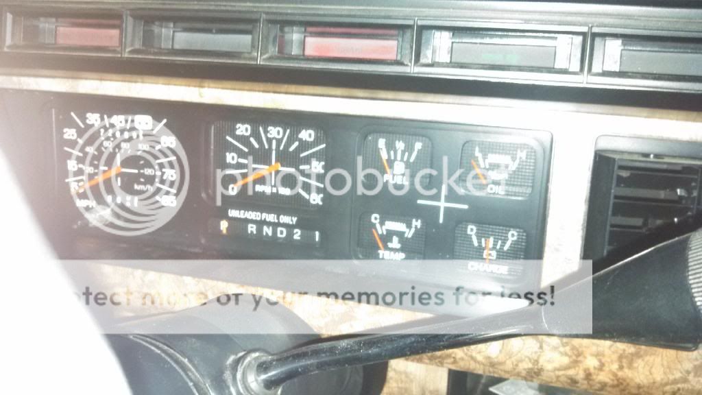

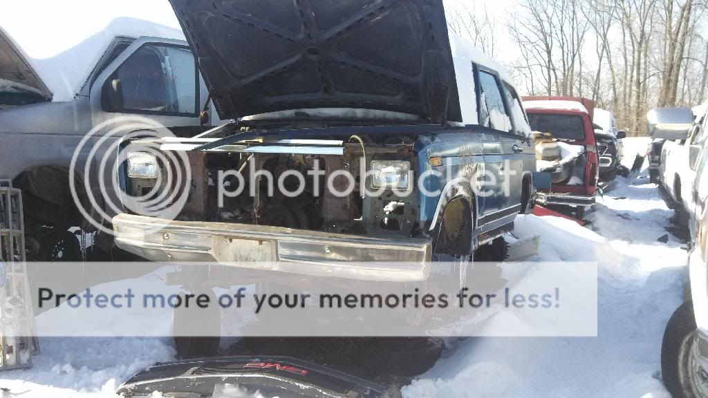

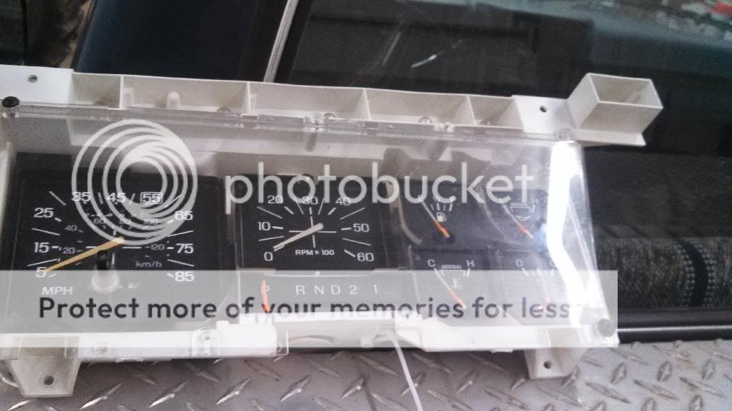

I made a trip to the local Pull-a-Part and was pleasantly surprised when I found a Bullnose 150 and a Bronco. The 150 had a nice cluster with both a tach and trip meter (both options my truck didn't have).

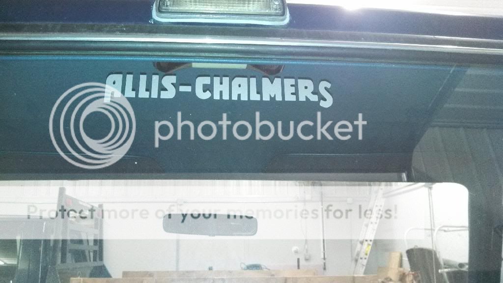

The needles were bleached out pretty bad, so I used a little Allis Chalmers Corporate Orange to bring them back to life.

The Bronco was two toned baby blue and the same dark blue as my truck. So I pulled the filler panel since it was straight, rust free, and my color. I throw it on the shelf until I find a bumper and fender.

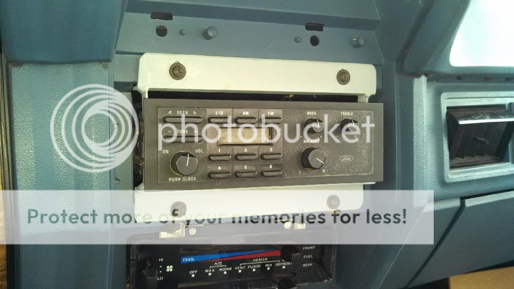

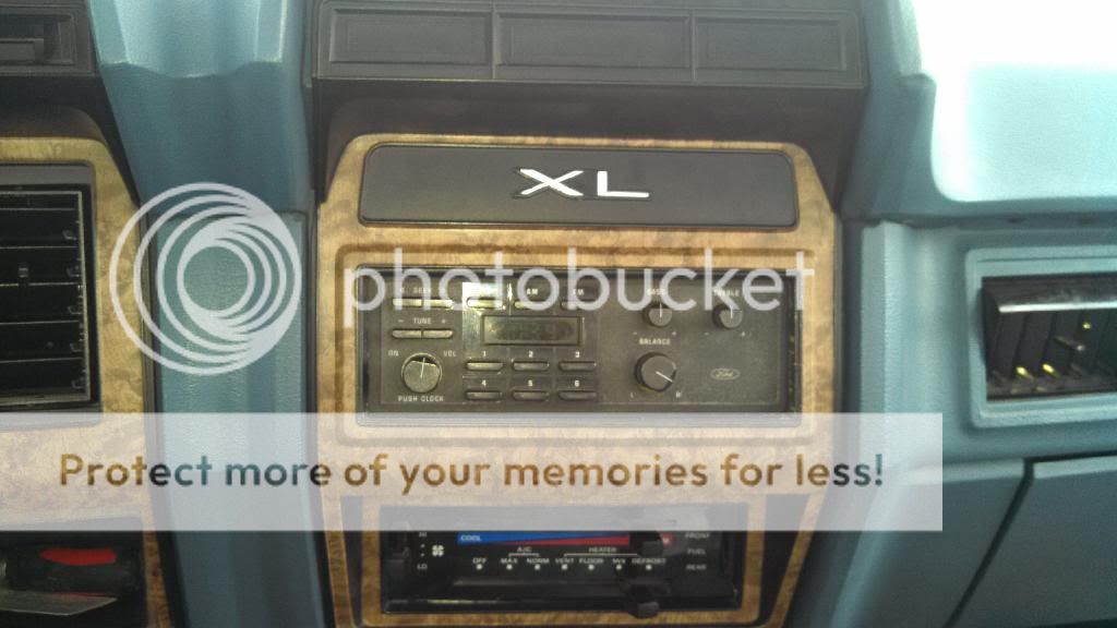

The truck came with a cheesy Dual radio that was not mounted or wired right. I looked for a factory 86 radio with FM, but they are few and far between. I decided to bump to factory 87-91 radio since they have a clock (80-86 radios didn't have this feature) and because I could find one setup for my two speaker system and not have an unneeded fade knob. I had to make a bracket to mount it and use an adapter harness as well as 87+ pigtails to make a harness to make it plug in.

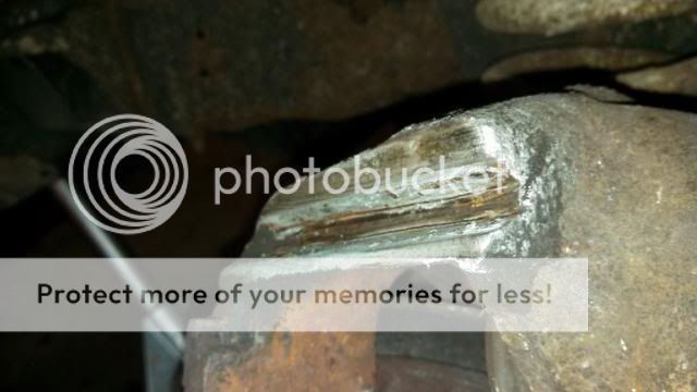

I was replacing the shocks and discovered the driver side caliper pins were half froze and caused the outer pad to gouge the rotor...so ordered rotors, pads, big piston calipers, 1 Ton master, bearings, seals, belts, hardware, hoses, and HYDROBOOST!

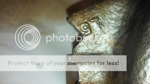

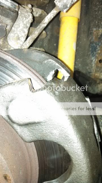

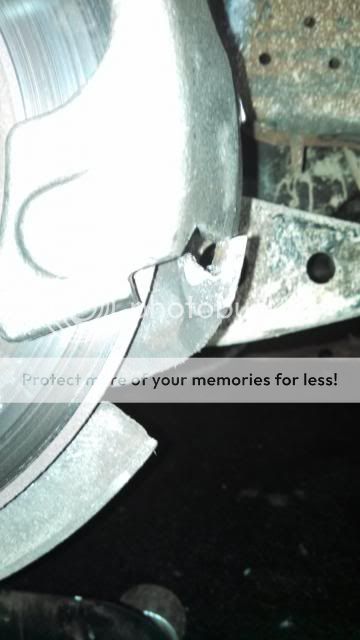

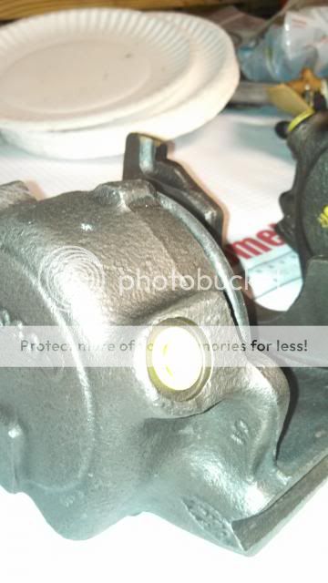

The Big piston Thunderbird calipers are not as easy to throw on these 2wd trucks as they were on my D44. The caliper hose ends must be drilled to 7/16 and 7/16 banjo bolts used. The shoulder around the inlet has to be ground down a hair as well. The big difference is when it comes to mounting them up...
There is a big lip that must be removed to fit the 2wd bracket...
before

after

comparison

Shoulder that needs ground down.

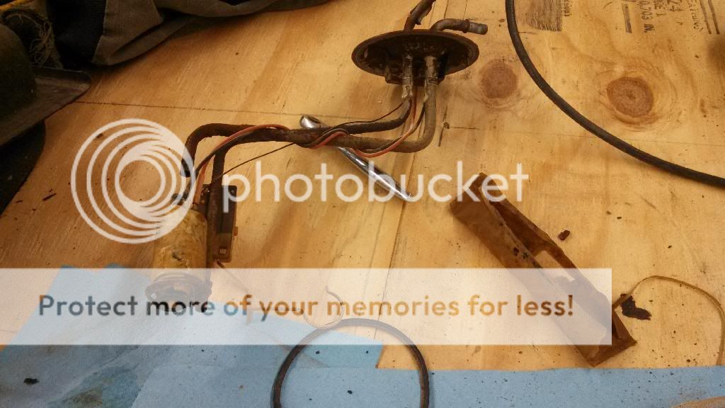

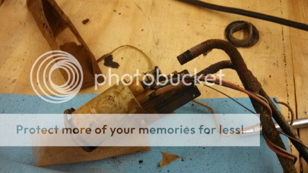

I pulled the pump and found the issue....:(

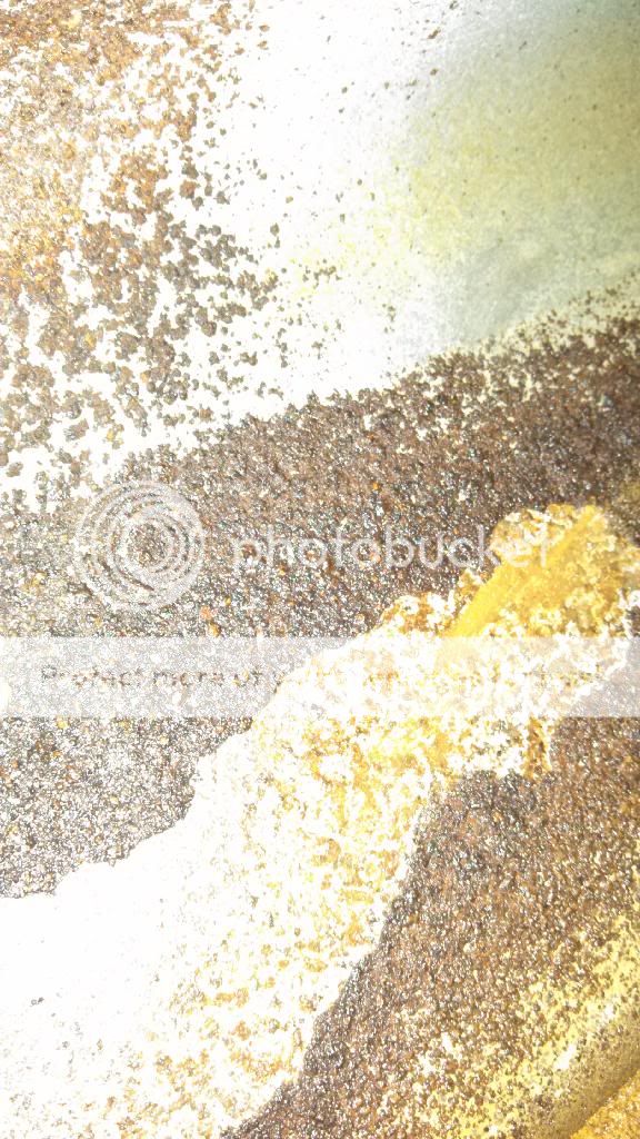

The junk gas had taken on moisture and rusted up inside of the tank as well as eaten the rubber hose off the pump, the float itself, and killed the pump.
Inside of tank

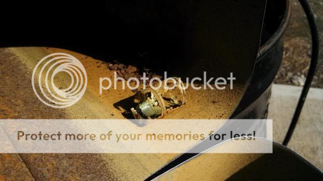

Sending unit. The float and hose were 100% dissolved

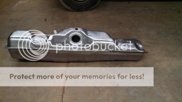

New tank, sending unit, pump, strainer, and lock ring are on the way.

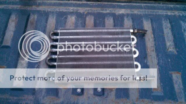

Tranny cooler.

Got the cooler mounted up and plumbed in.

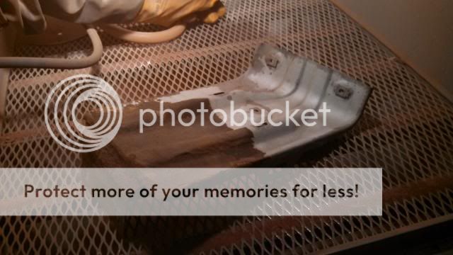

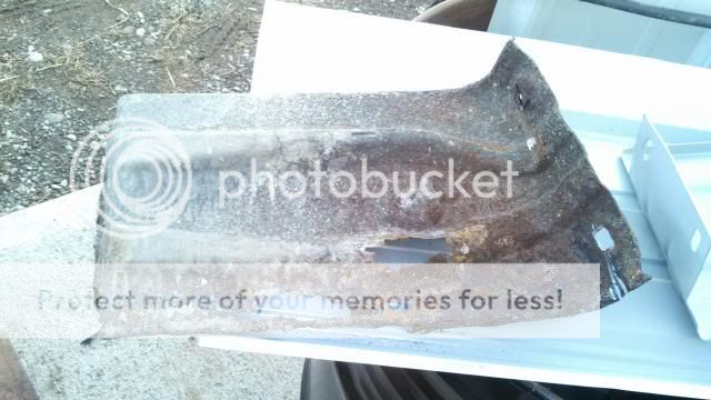

I was going to build a new battery tray, but I lucked out and found a not rusted out one. Kind of a piss poor design to have the metal tray under the inner fender to catch all the mud, crud, and salt and rot out.
Sand blasted it down and painted it with some zinc based paint

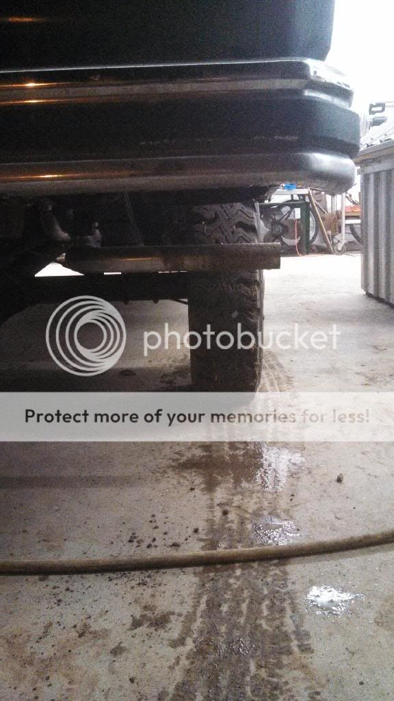

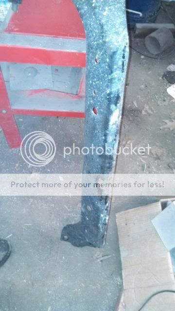

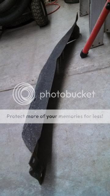

I noticed the front cross member was bent from what looks to be a recovery attempt at some point.lol
Any who... I straightened it out in the press.

I found the old float in the tank..

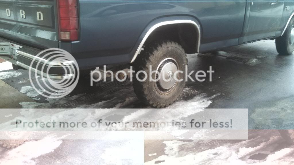

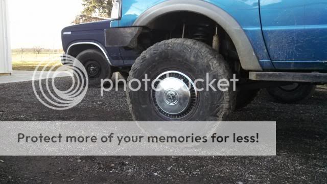

I also got the Ranger out let it stretch its legs now that the roads here are salt free for a few days.
Not so sure hubbies look right on the 35's

New tank and pump showed up and I got everything buttoned back up. Now I can go fill up both tanks to the tune if 120 bucks...
