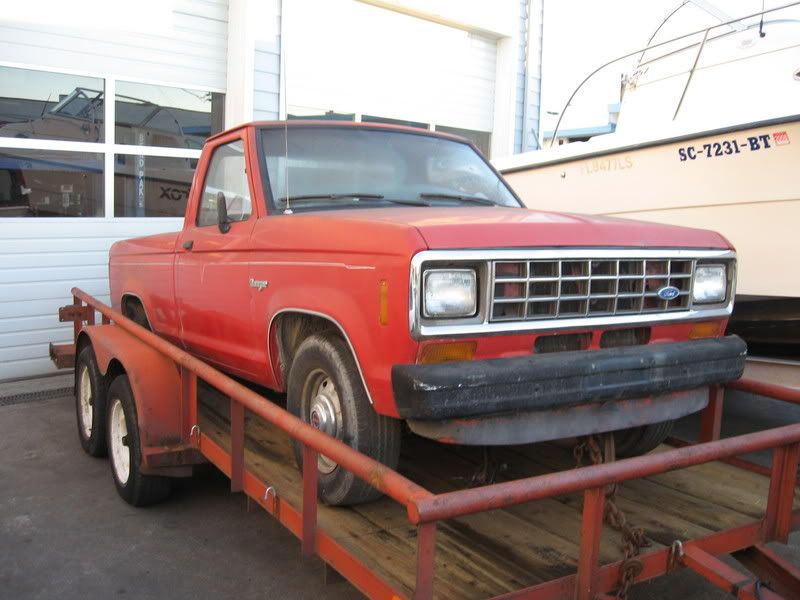

Some of you may remember that I started this build on the other board. The project had about six months of down time and then the old board was taken over and I lost my thread. The project is now on the chopping block once again. Here's a run down of the build and parts so far:
85 BII frame
87 Ranger body
3" wheelbase stretch
Refreshed 2.9 with 58MM TB and Pacesetter headers
Rebuilt/beefed C5 with shift kit and new torque converter
4.0 radiator with SPAL electric fan
Narrowed D44, 0.5" tubes, Cryod 4.88's, Grizzly locker, Ruffstuff cover
Narrowed 9", trussed, Yukon 3.25" Pro-N case, Chromoly spool, Daytona pinion support, Dutchman 35 spline axles, Forged 1350 yoke
Bronco Graveyard (Deaver) 3.5" superflex 190 lbs per inch coils
Trail Gear Toyota 3" 235 lbs per inch leafs
36" TSL's on 15X8 Pro Comp steelies with 2.5" BS
D.D. Machine doubler
RuffStuff 1 ton steering

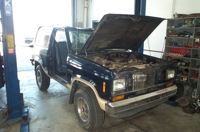

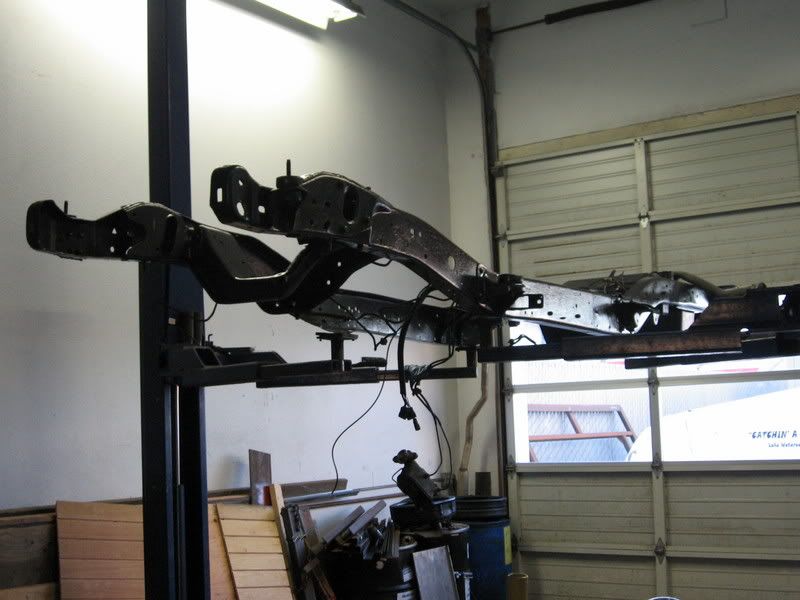

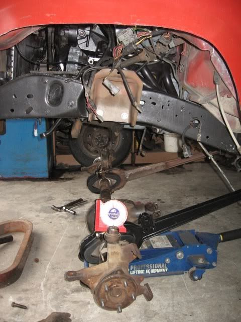

Here's a few pics of how it started:
Project B2R
Project B2R
Project B2R
Project B2R
Project B2R
Project B2R
Project B2R
Project B2R

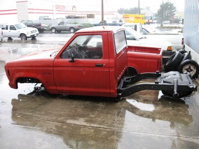

Here's how it sits this afternoon, ready to start throwing the suspension under it:
Project B2R

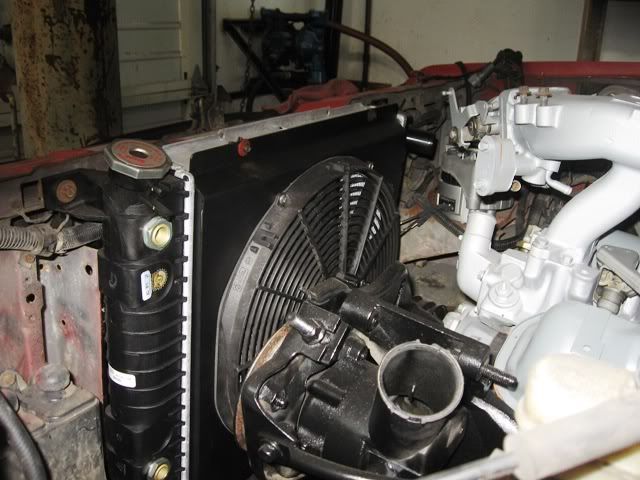

Fan mounted on a shroud that my buddy fabbed up for me:
Project B2R

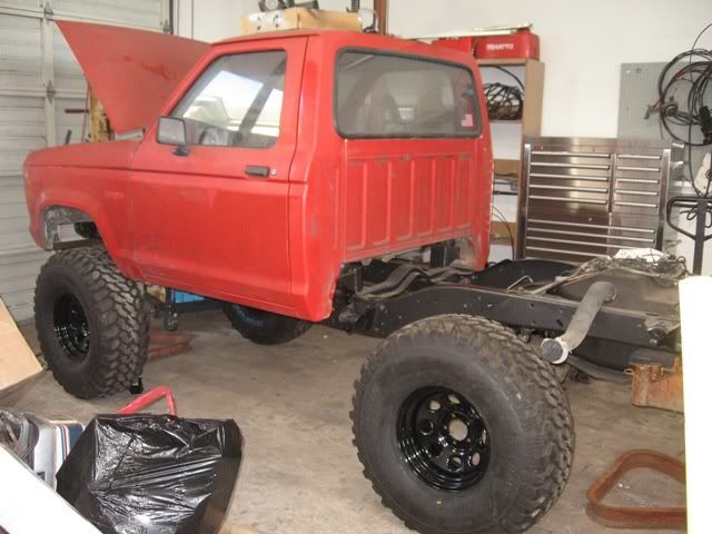

Some pics to keep things interesting. One things for sure, I dont see the need for extended arms or heims unless your're running some long coils.
Project B2R
Project B2R
