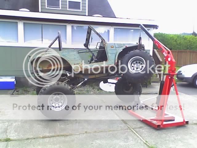

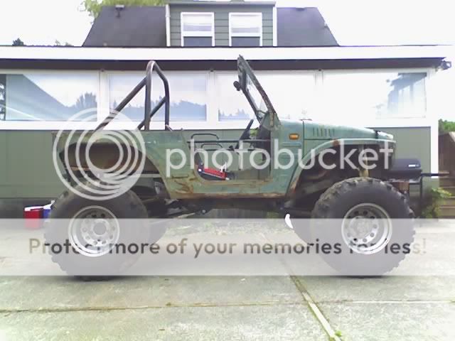

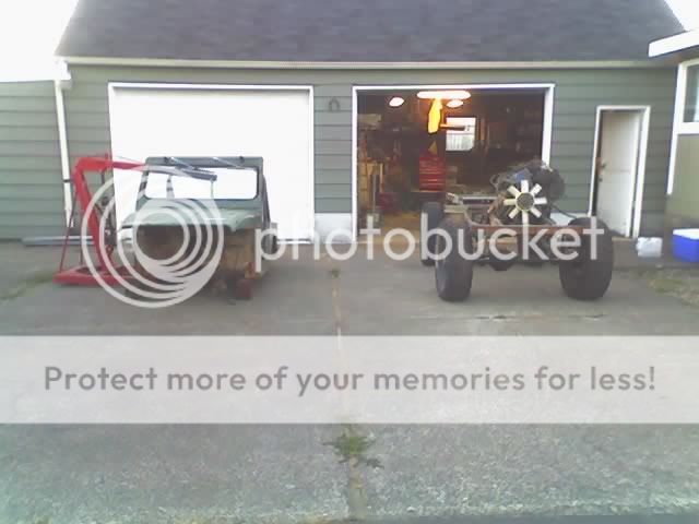

Well, here's my frankenstein. It started out as a '72 Suzuki LJ20. I picked up an '83 Ford Ranger 2wd longbed regular cab, which was a good running little truck till I got to it. Muahaha. So basically I started with a bone stock Suzuki, and stripped everything down. The only things left from the original rig are basically the body and frame. The first things I picked up were a Samurai transfercase and axles. Now, I know what you're thinking. Where does the Ranger come in? Well, I needed a good running motor and decent tranny to put in front of the samurai transfercase. A buddy of mine was at the time trying to sell his '83 Ranger, and I knew it ran and drove good, so I payed a whopping $200 for it. Well, actually $100, because my dad needed some body parts for his ranger, and so we split the cost. I got the little ranger home and immediately went to work yanking the running gear and was soon on my way to fitting it into the LJ.

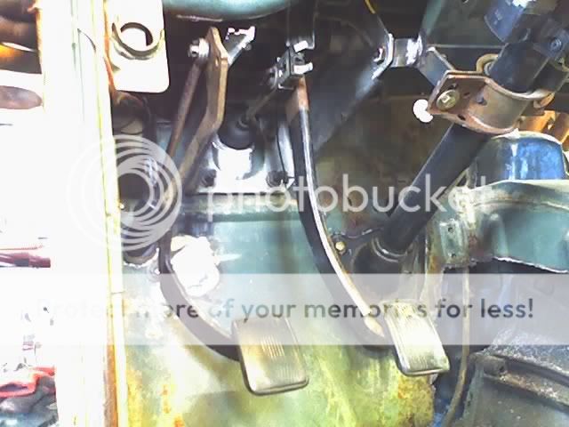

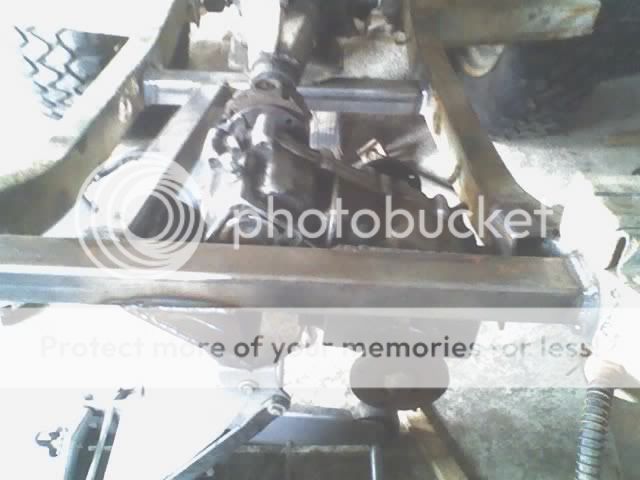

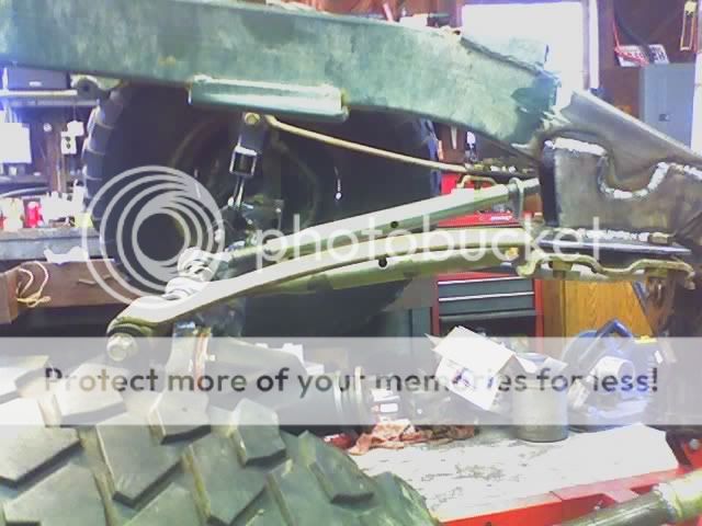

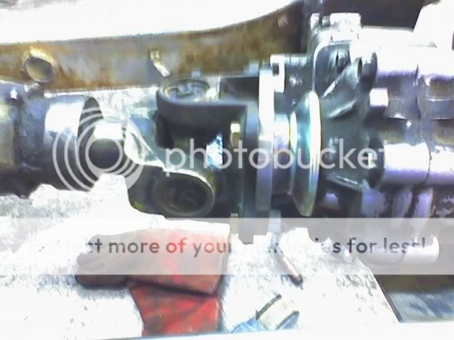

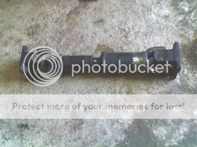

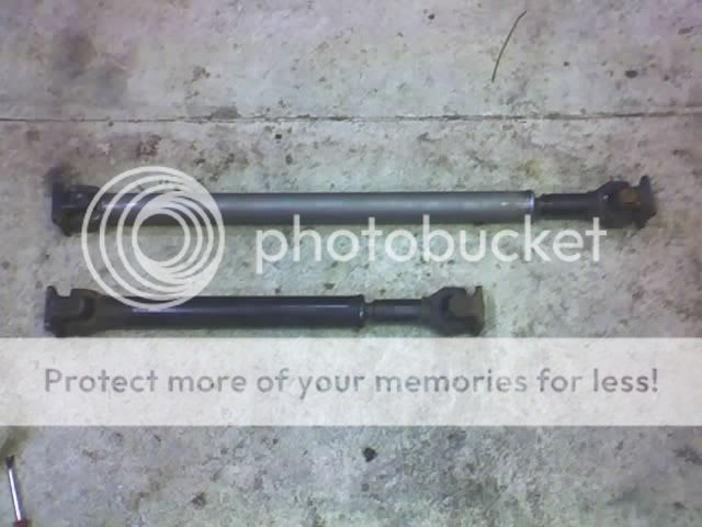

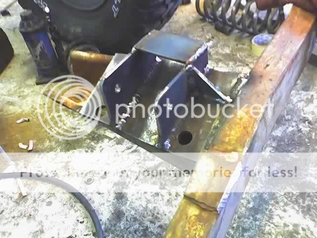

So for about the last 4 months, I've been cutting and welding, making a crazy little rockcrawler. The ford parts in it include the 2.3 liter 4 banger with a Weber on it, the stock 4 speed, all the wiring and the steering column, the brake and clutch pedals with aluminum bracket, the master cylinders for the brakes and clutch, the rear springs (which were cut in half and used just the main leafs for 1/4 eliptical rear) and the slipyoke into the tranny and the rearmost flange of the driveline. The non ford parts include samurai axles, transfercase, and modified drivelines (the rear is shortened and the front is lengthened due to the length of the drivetrain), Datsun 620 rear leafs up front, outboarded on the frame, toyota IFS steering box with modified pitman arm to accept a custom samurai z-link, john deere tractor toplinks for the rear triangulated 4-link (the bottoms were cut and welded around D44 axleshafts to strengthen), and a whole bunch of 3/16ths steel plate.
As of right now, I need to get some calipers for the front axle, run my brakelines, run the wiring, install a fuel tank and fuel lines, and either find a small enough radiator to fit in the front and still keep it cool, or run some tube to the back and run the ranger radiator with electric fans.

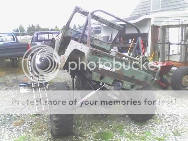

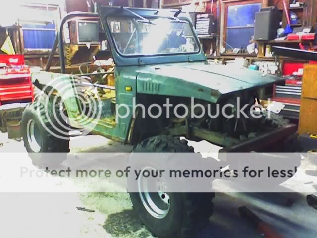

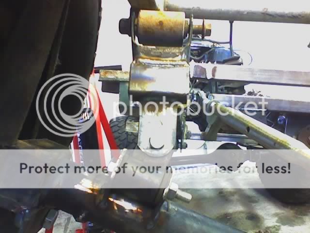

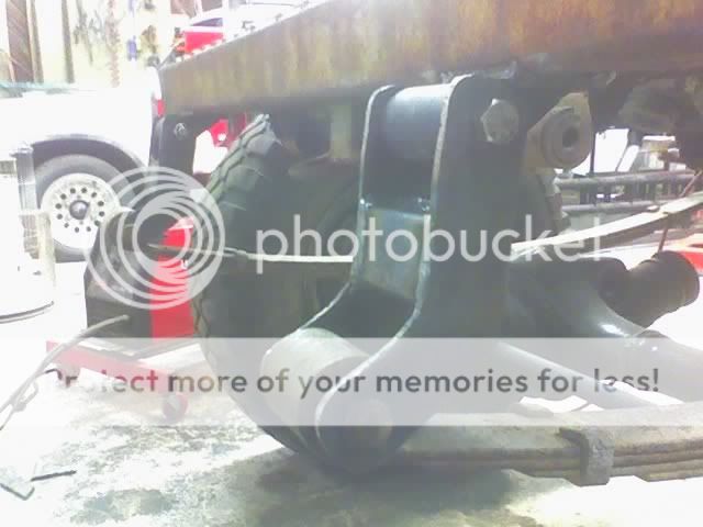

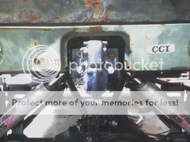

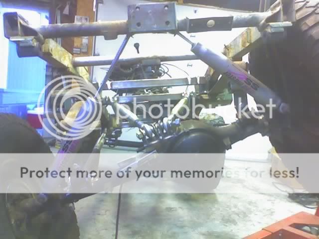

Here's some pics of the build.

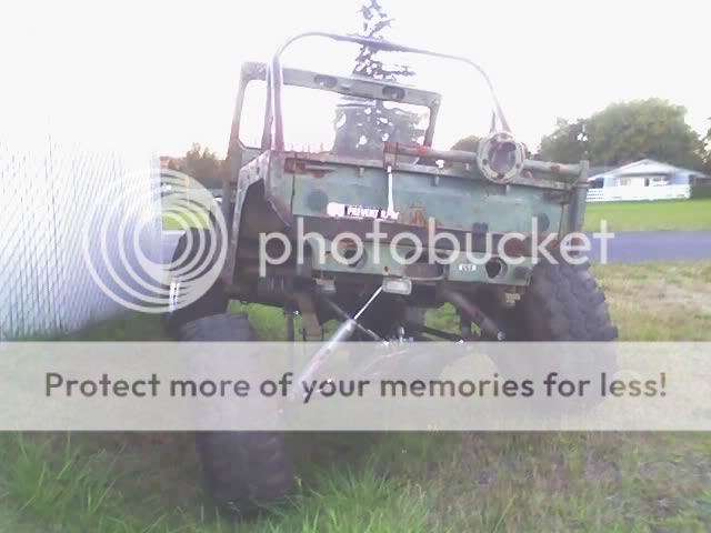

Thanks guys, tonight I got home and UPS finally brought my ream, so I reamed out the pitman arm and assembled the steering. This was the last thing needed for the steering. I also finished up my drivers side shock tower, so both shocks are in. This wraps up the suspension, so now all I need is brakes, fuel, wiring and the radiator. I'll probably start disassembling everything soon, back down to a bare frame, so I can finish some of the welding that is inaccessable with the components bolted in. Then the frame can get a nice coat of primer and paint, and I can put it all back together.

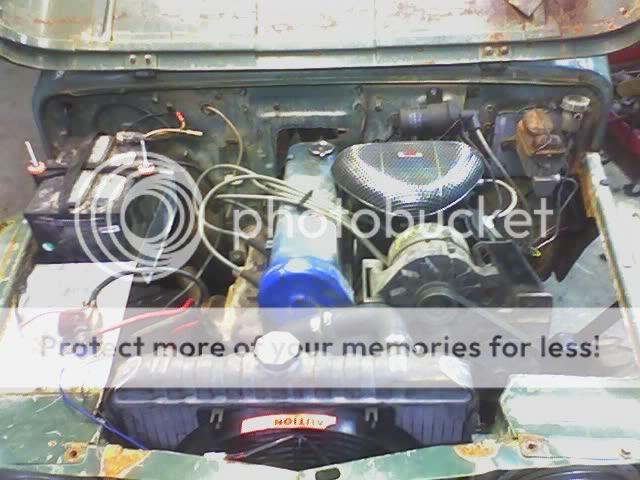

Well, thanks again everyone, just an update, I ended up using a Datsun radiator and got that installed today, I removed the stock clutch fan, and will be running an electric. I got the battery tray/ passenger side apron built also, this will hold the battery and starter relay. Pictures to follow.

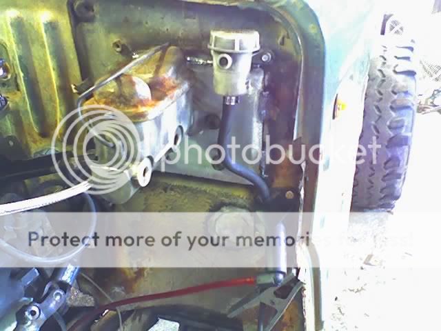

Well, I got a little antsy with the radiator in, I filled it up, plugged all my wiring harnesses in and decided to take it for a spin. I still have no brakes or fuel system, so I took an empty oil jug, popped a hole in the cap and used a brass fitting stuffed through it. I hooked this up to the fuel line, which is currently running no fuel pump. The mechanical one got in the way of the steering shaft, so I had to cut out a blockoff plate with the plasma cutter and I'll have to get an electric one. For now I ziptied the oil jug to the master cylinder, which is higher than the carb, and surprisingly it ran quite well on just gravity. I was able to run around in the field for a couple minutes, and play in the ditch a little too. Here's a pic and a short video. I realized when I got back in the garage that I had the hubs unlocked the whole time.

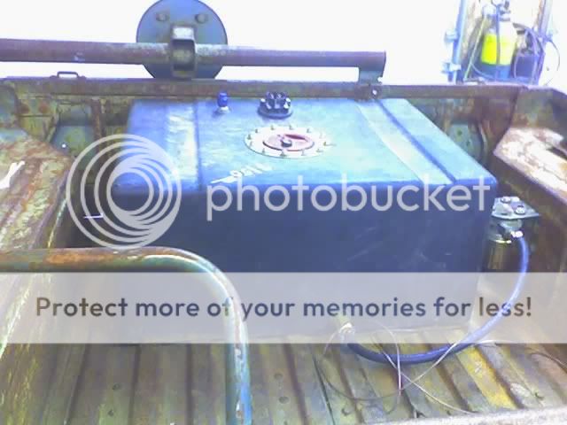

Well, it's getting close, I got a fuel cell and electric fuel pump and so the fuel system is complete, buttoned up some of the loose ends like wiring, guages, extended diff breathers, electric fan, and of course the pintle hitch. =)
The fuel cell and pump
Underhood

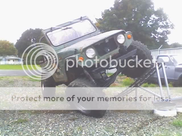

First test on the ramp
Rear shot on the ramp
