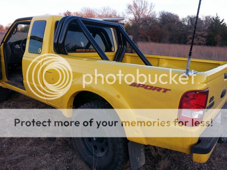

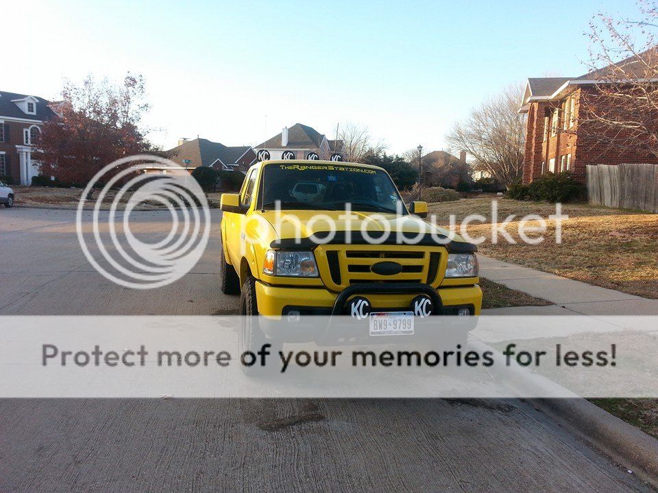

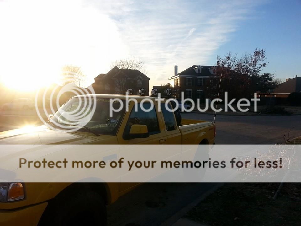

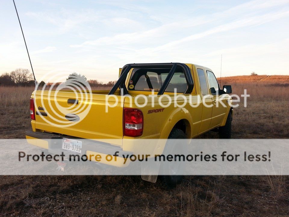

On the front of my truck I have some long range driving lights from kc, they work great but really didn't give me the higher up lighting. So recently I added a roll bar and today I got the lights mounted, I'm going to wire them up tomorrow since it's cold as crap today. But these are long range kc's and should do well, my only concern is that they sit to low, but I think they will be fine. I also have to modify the roll bars a bit since they are garbage thanks to go rhino not assembling them right.
Roll bar
With lights

The lights look good! What watt are they?

55W, the AT2's are great, my truck is only 2WD but with those tires they get me where I need to go. There really quiet on the road, and great traction off-road because they are so wide and flat, and I got a really good price on them. They are some durable tires, rocks, cactus, branches, and even curbs don't phase them.

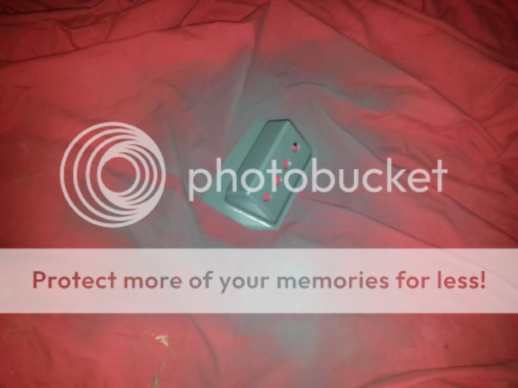

The harness that came with them are non relay, but I have a separate switch running to each 2 sets of lights. I did end up melting my interior lights switch but the light was annoying anyways, but I'm replacing that one with a kc hilites switch.

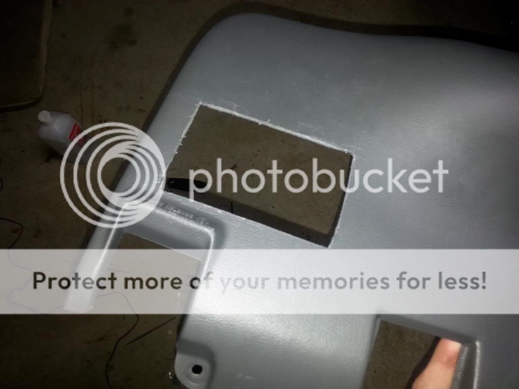

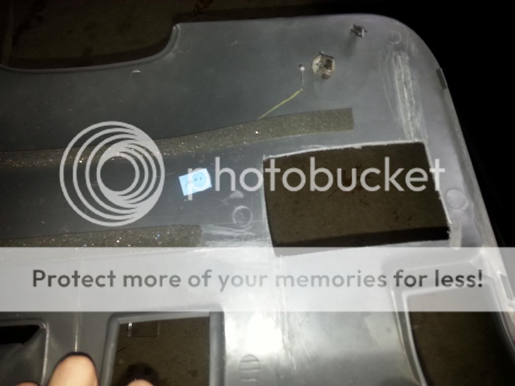

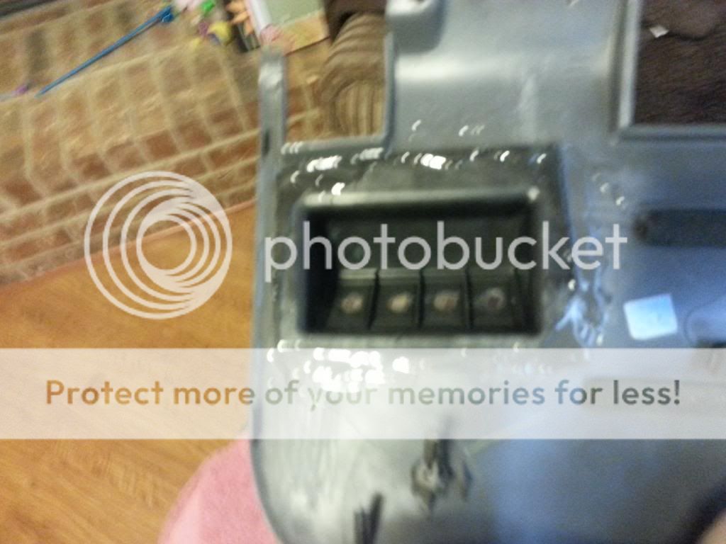

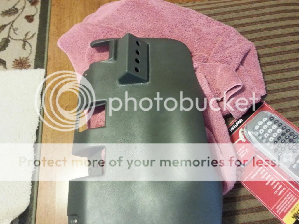

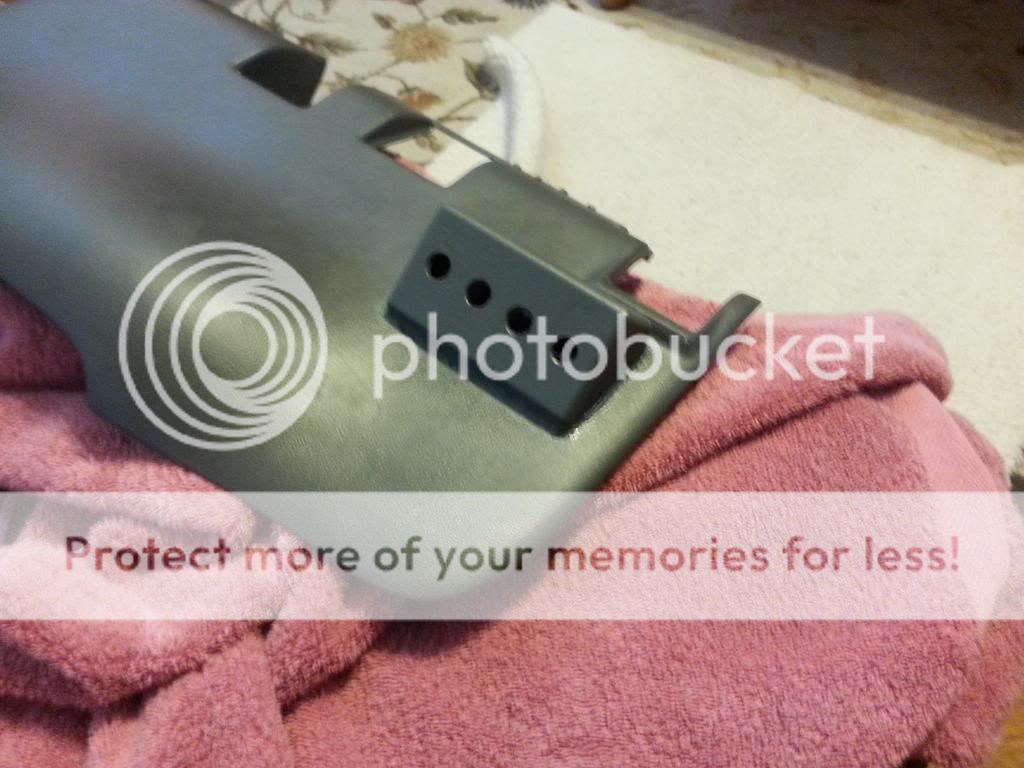

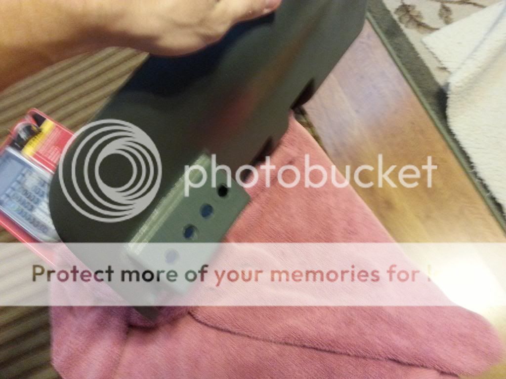

So today I got the new switch panel cut and painted, and also cut a hole in my dash for it.

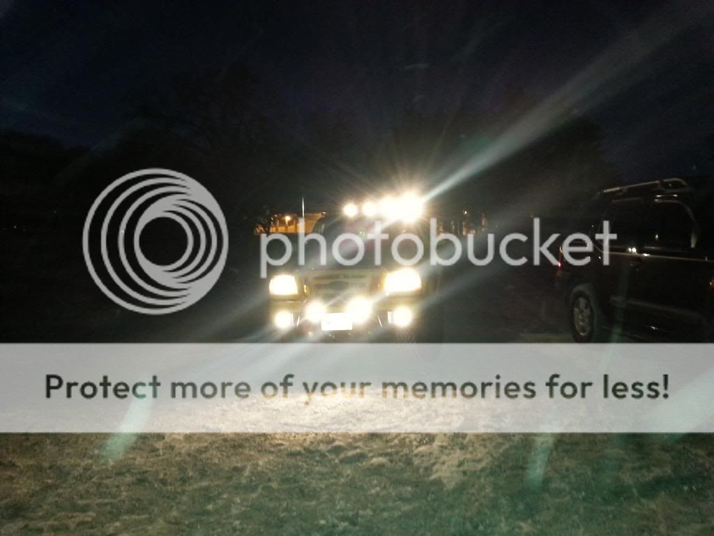

Oh yeah, here's them all on when I went off roading.

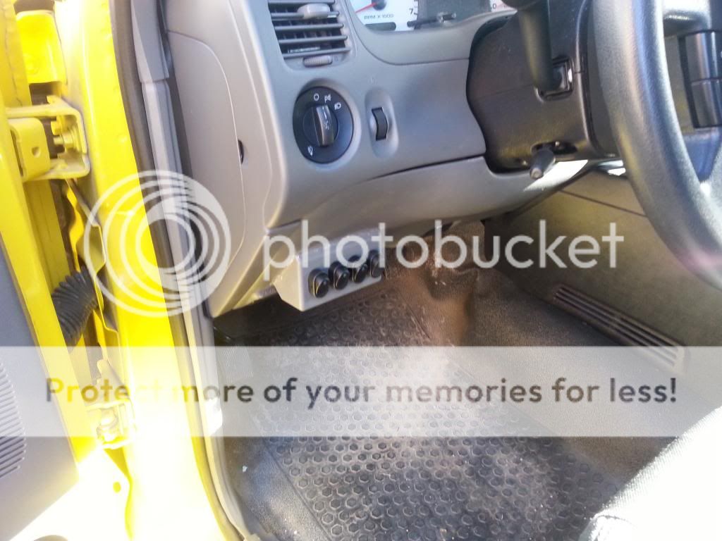

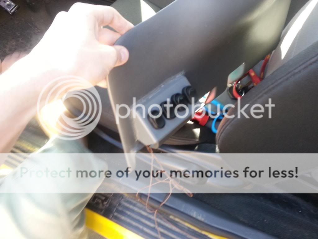

So today I got my glue on and got everything wired and installed.
My dad helped me sort out the catastrophe of wires...
TA DA!
