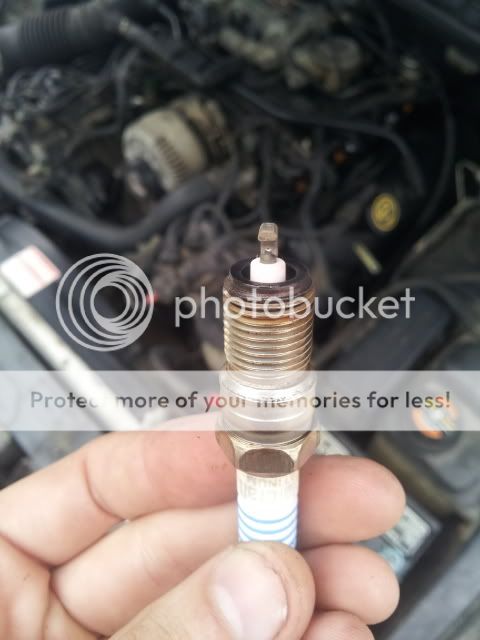

Have random hesitation so I got some codes pulled despite no CEL and got my temp sensors, evap solenoid and o2 sensor. Checked the plugs and they are all new motorcraft platinums so that's not a problem.

Did you pull all the plugs or just the one? After spending a night broadside to a blizzard it took about 2 weeks for me short out a coilpack from the snow that accumulated in #7. You might check that to make sure you don't have a hole with coolant in it.
Also if they ran the plugs too long they can kill coilpacks too, I think the unipacks like what you have are more durable than the COP coils that I have though. Either way more plug gap = more load.
I have the coil packs and they are worse then the COP, give why Ford went to them.
I have the factory intake, all plastic and it had a slow leak so PI intake well happen since they cost about the same to replace plus 10-15rwhp gain too.
I pulled them all and a clean bill of health.

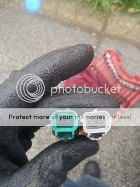

Whoever changed out the coolant temp sensor last put the wrong one for the computer/cooling fan in, they instead put one for the dash gauge in and forced the harness connector on it, same with the dash gauge but didn't fix that one. This did now fix the problem of my cooling fan running non stop, it now turn on only when it needs to.

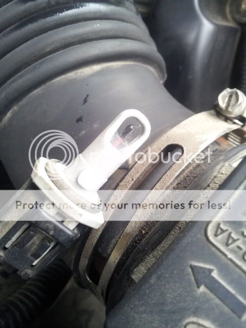

Also the air charge temp sensor had spider web all over, got that and the MAF cleaned. Seems to run better now.

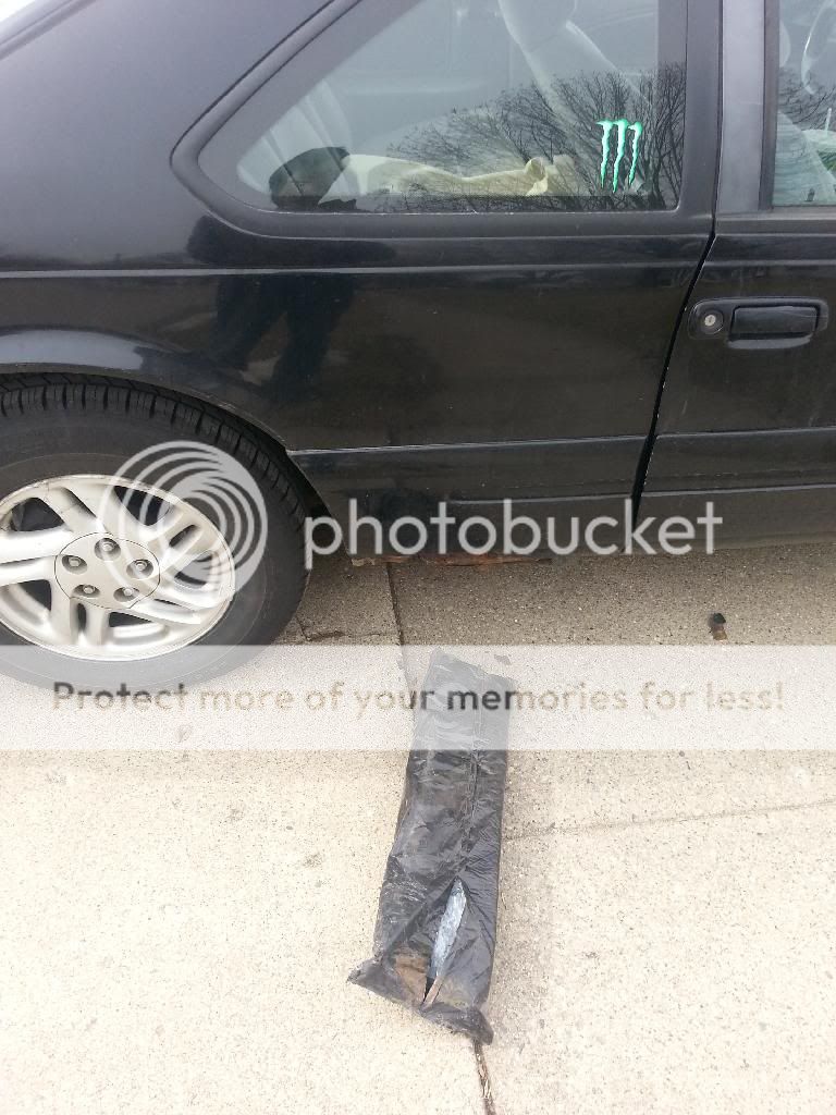

Well finally got the money to get front tires put on it along with getting the front runs turned around. No more steering wheel wobble, hard turning while stopped, etc.... Also pulled out a bag of sound deadening out of the quarter panel that is known to cause them to root out like mine has started to do. At first it looked like a bag of drugs.

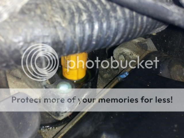

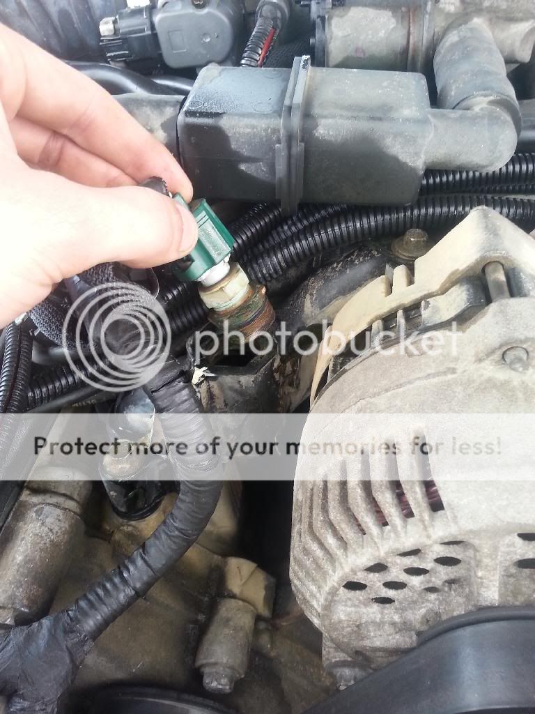

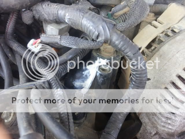

Well went to a ranger meet yesturday but didn't make it but istead got stranded on I69 brcause the temp sensor fitting popped out of the intake. Got rescued by Lonnie Smith and can't thank him enough.
dangerranger83's 97 T-bird
Have a line on one for $75 but it has the metal coolant crossover.
