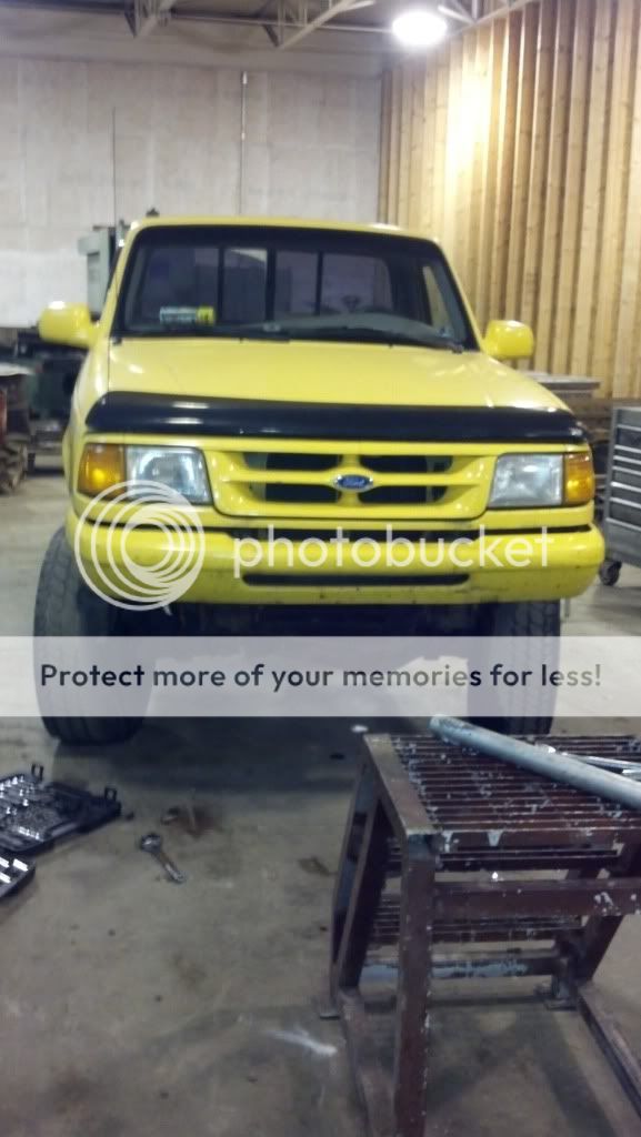

Super Rad instagram bro photo at my dad's shop

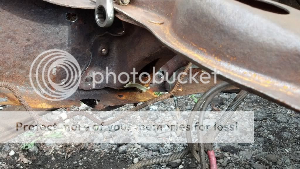

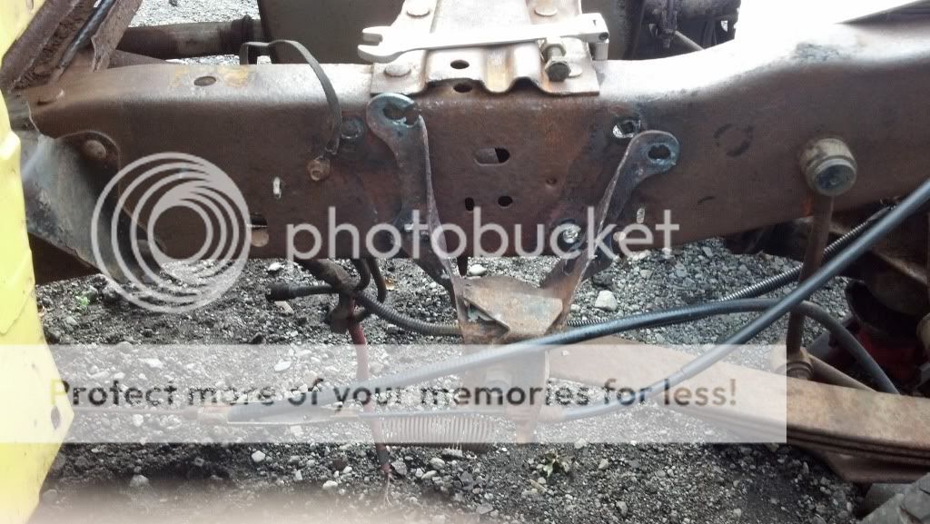

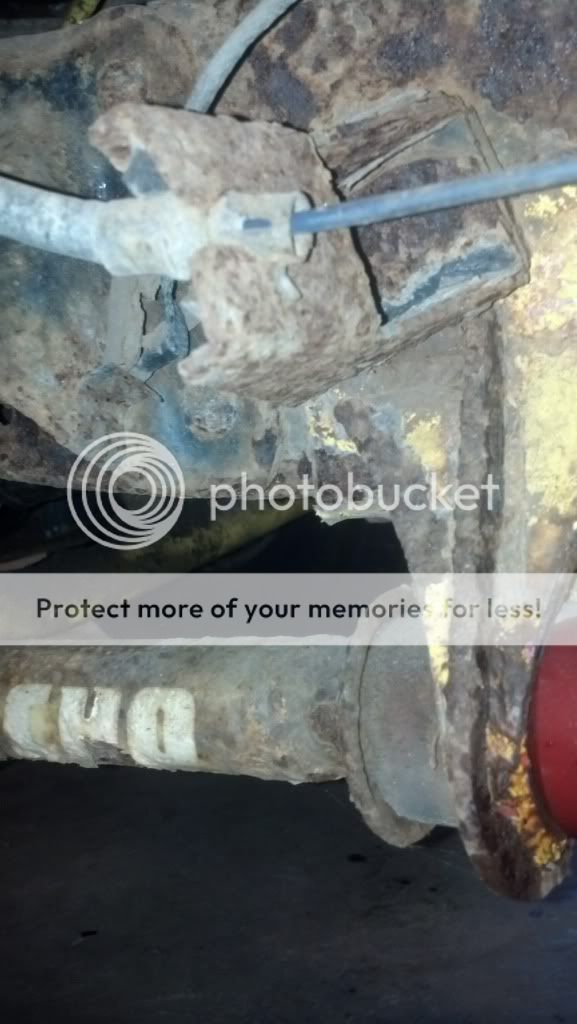

Finally, It was time to clean up the frame, It all pretty much looked like this:
95 Big yellow mallcrawler

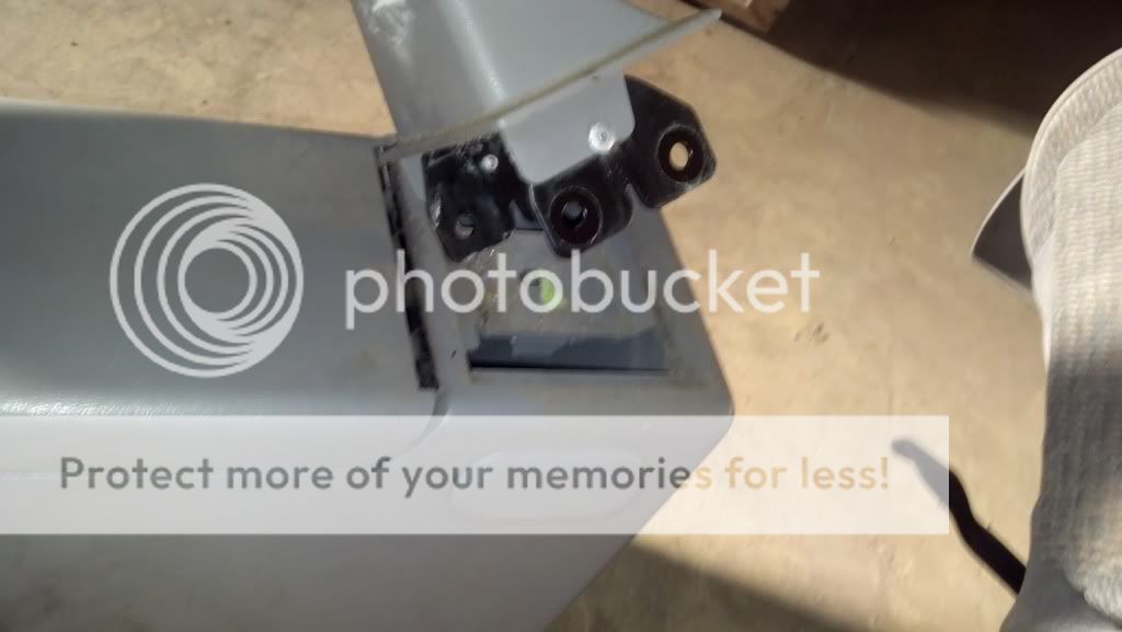

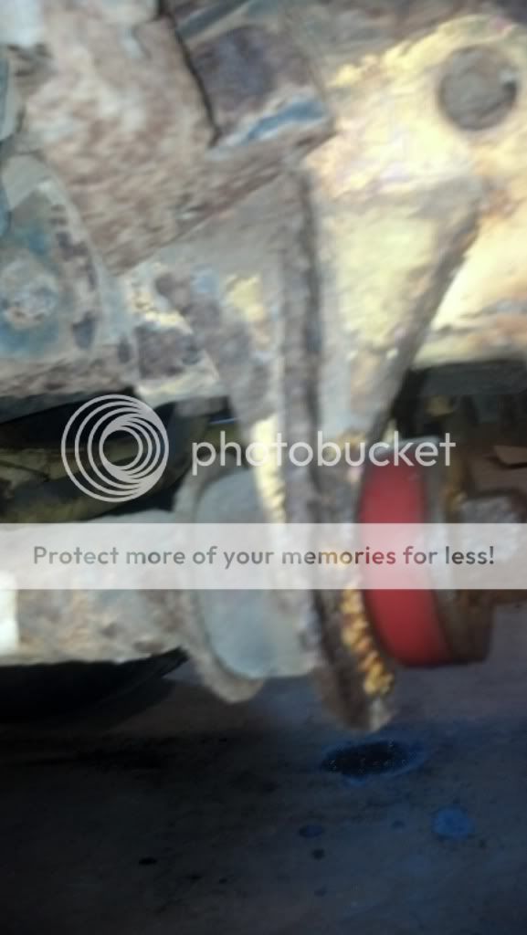

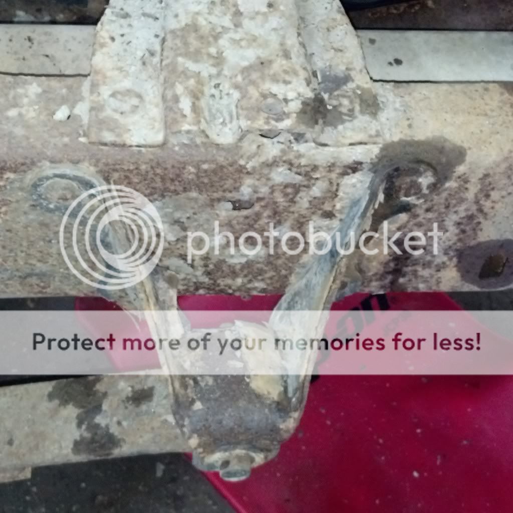

After some needle scaling the hell out of the frame for a couple evenings and possibly giving myself arthritis, I had this:
and this..... :l
This has pretty much been the determining factor along with another hole on the rear passenger section right under the shackle hangers that's put me on hold, but now that my truck isn't outside and I have a space the size of the shop it was at to work and keep all my shit, as well as a machine shop, presses and welders a walk away, things are going to get real pretty soon. I'm still afraid to weld the heat treated metal and did find a new frame for a 94 online from a ford dealership for $850

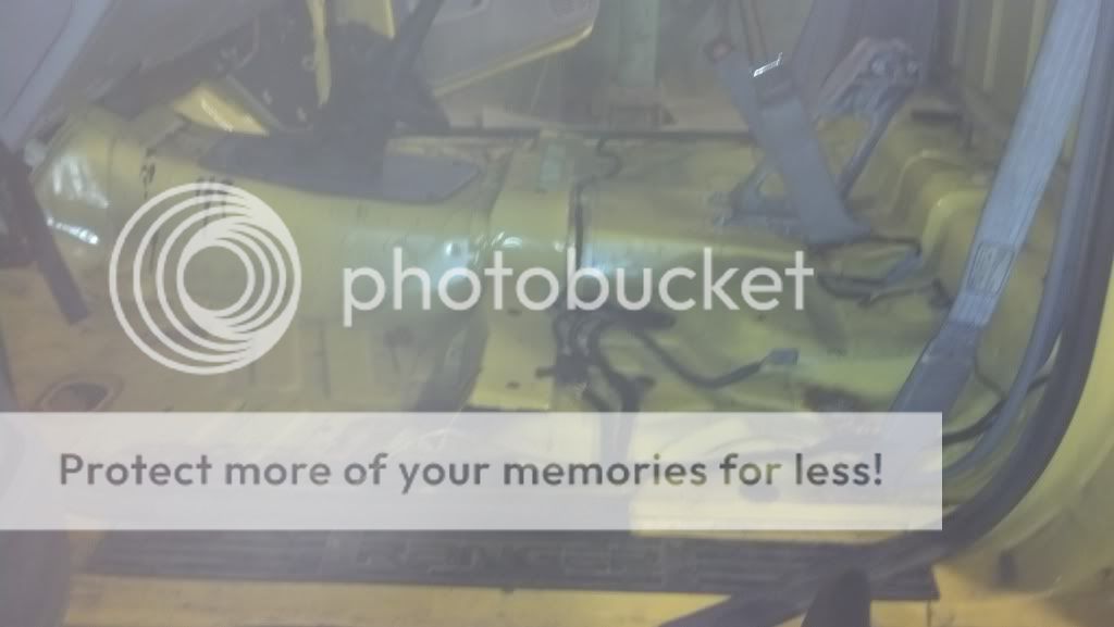

So, the next step really is to get the cab off, I got the interior out for the most part a few hours ago, and boy did I find shit below the carpet.
Lighter stuffed in the crease on the back wall, nuts under the carpet, 10 year old receipts, change, and I think a rat lived under the arm rest for a little bit considering what looked like a nest was there.

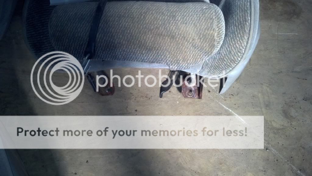

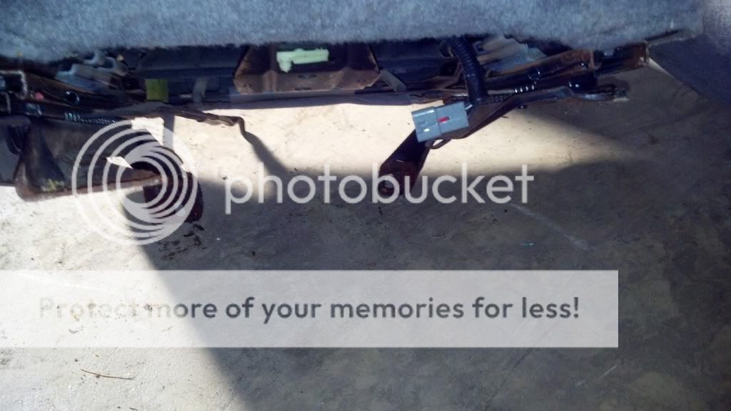

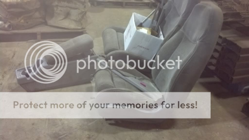

Removal: Seats
The seats come out fairly easily, there was just four 13mm bolts, one on each corner that needed to come out of each seat, as well as a wiring connector that needed to be disconnected after the seat was unbolted.
Back with connector:

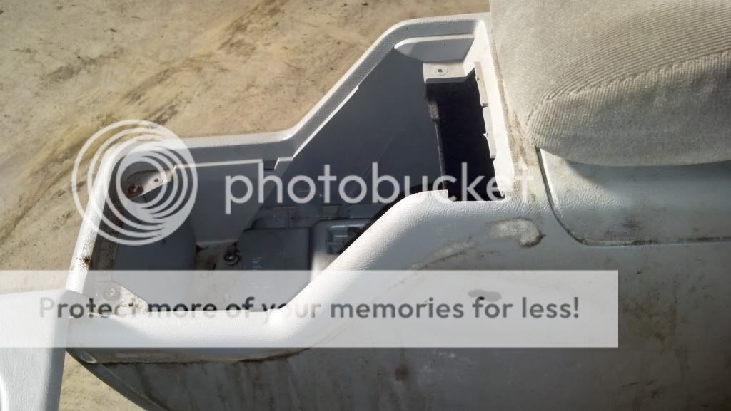

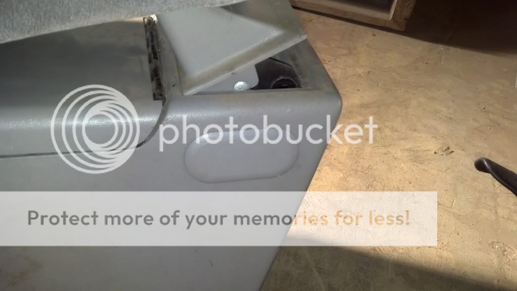

I set them aside and began working on the arm wrest.

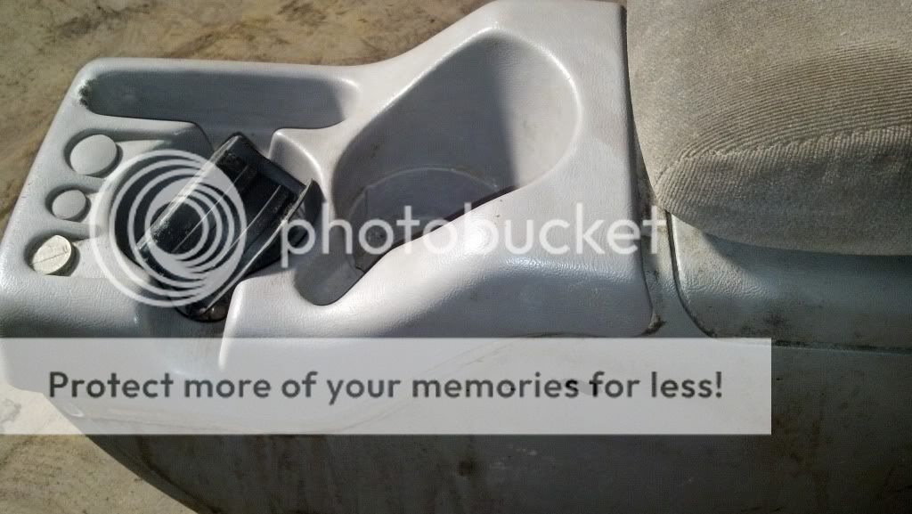

To remove the arm rest you need to pull the cup holder piece out:95 Big yellow mallcrawler
remove 4 screws, two are longer then the others:
then remove the plastic panel on the rear of the arm wrest assembly, and remove 4 5/16" bolts, then pull the arm wrest off, and the assembly off of the substructure.
You're now left with carpet, seat belt clips, and the aluminum structure.

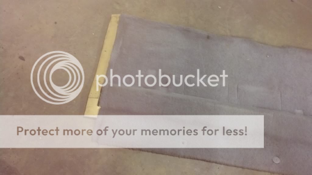

I then proceeded to remove the carpet and vacuum out everything, I can't give an accurate writeup of that because most of my trim panels are broken and it's straightforward, but it should end up looking like this
Oh, and why the hell is the back panel made out of cardboard?

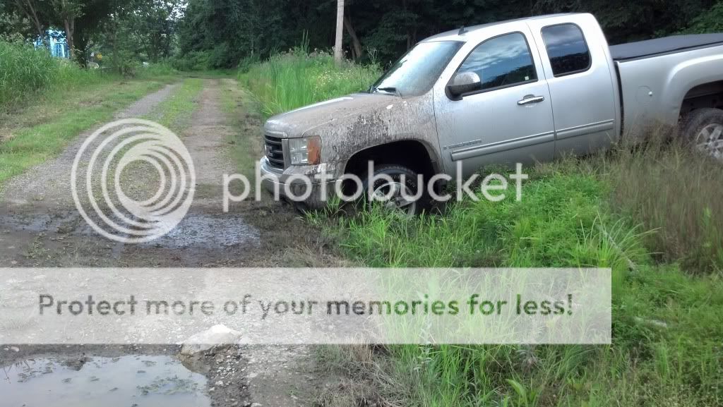

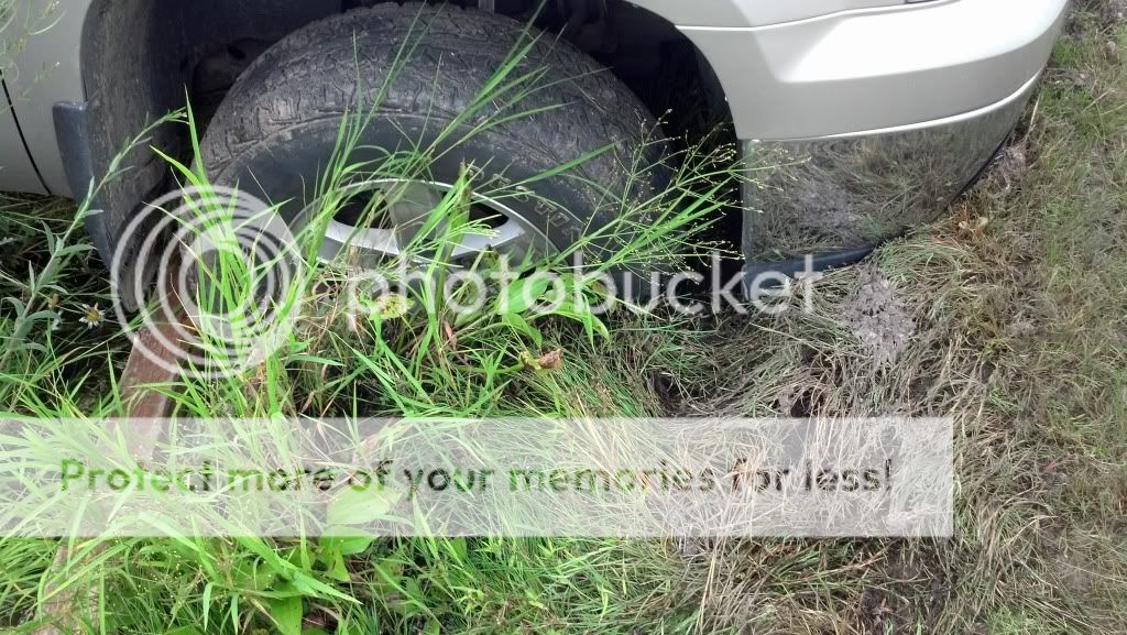

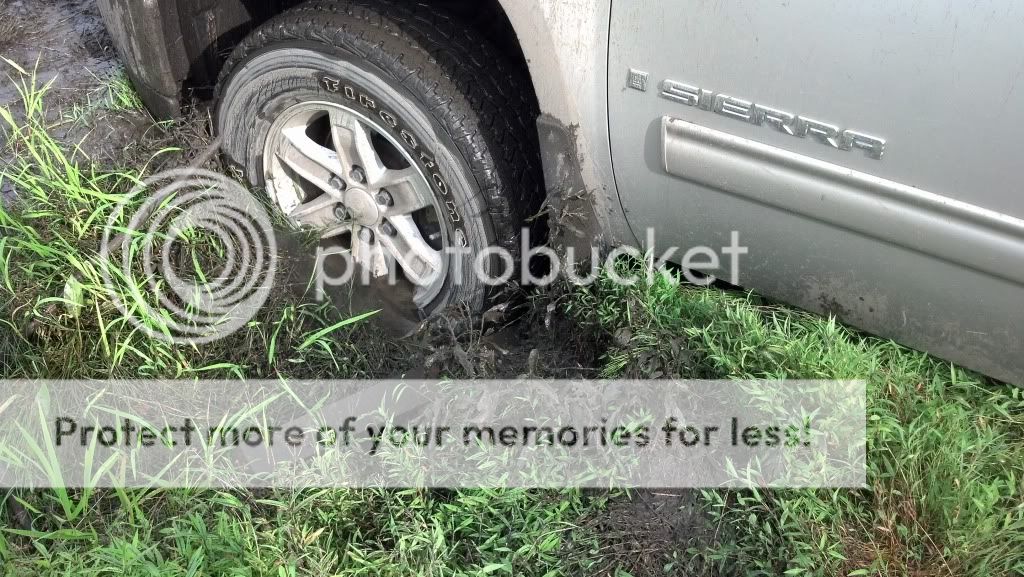

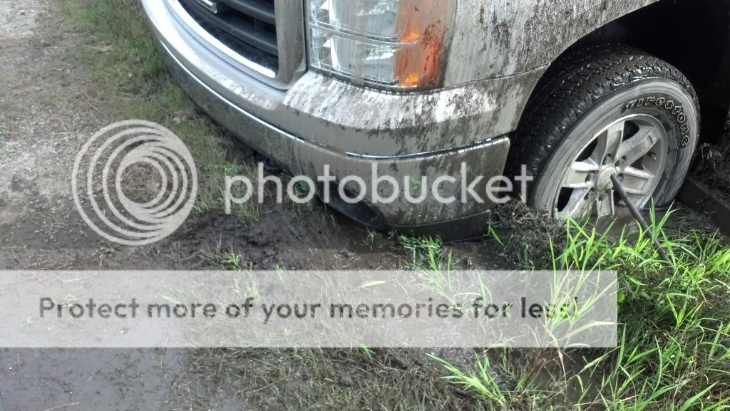

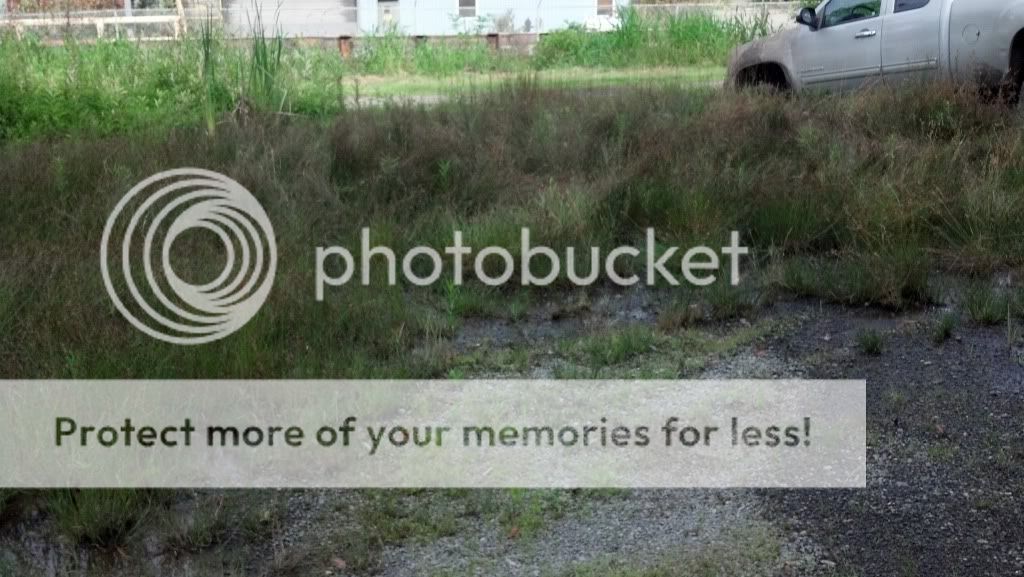

Didn't get to work on the truck, left a friends house and went on a little joy ride exploring. I was going to head back home and work on the truck, but I ended up getting my truck stuck for an hour and having to get AAA to pull me out.
Thought I was just driving over a flat patch of grass and weeds and needed to make a U turn because there was no street left.
But What I didnt realize was that there was a ditch at the end, and nose dived into the ground and got stuck.
4 wheel low and hi didn't do shit even with boards under the tires and I just ended up burning rubber.
And the way I was sitting I almost ran out of gas, my quarter tank became empty on my fuel gauge.

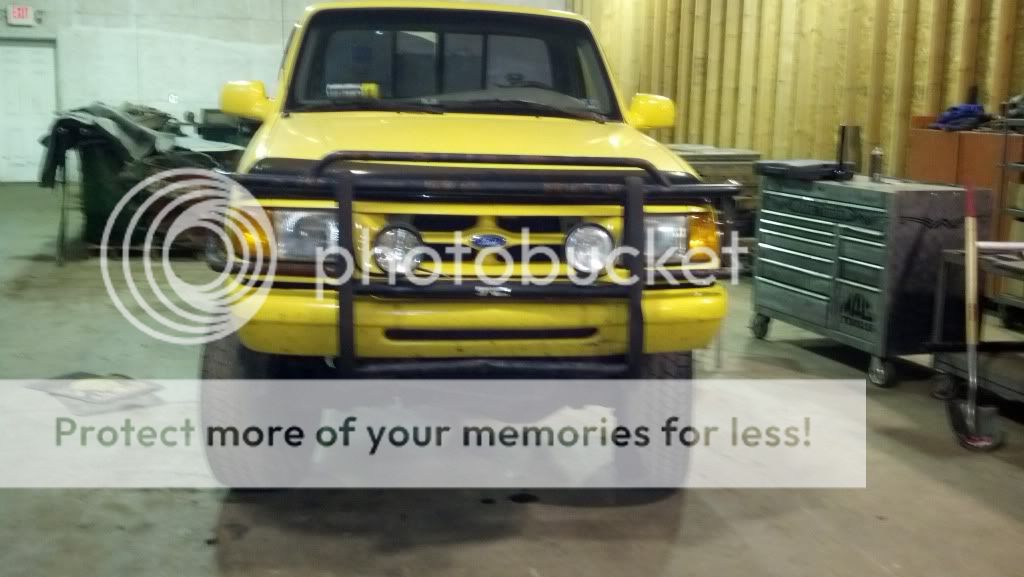

I did manage to get some work done tonight, after a long sweaty fight with 6 rusted bolts I got the bull bar off,sprayed them with PB Blaster friday and had to use a breaker bar and a massive socket wrench and could still barely get them off, they snapped and I almost burnt my hand on them when I pulled em out.
Went from this:
To this:
I also got most of the bolts off of the passenger fender, but the one by the bumper had the head rounded off so I'll have to get the torch out next time and heat it up.

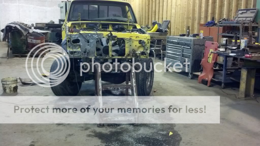

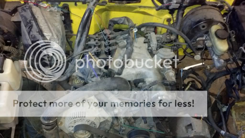

Getting some work done:
Pulled the front end, fenders, doors, and drive shaft off, the core support is going to need a bit of tlc and basically everything in the engine bay and cab is going to get sanded down and primed before it goes back together.
Basically planning to pull the cab off so I can send the frame out to be sand blasted and finally get the frame fixed and run new brake and fuel lines.
