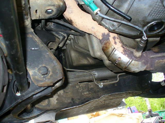

So many voyeurs out there but no speakers.. I suppose I'll throw up some pics to illustrate.
**Note**
These are not my pics. These are pics from various threads I have been reading and off hand I do not know who originally posted them. On that note, BIG THANKS!!
front diff in
front diff torque arm mount fabrication
front diff out
You can see where the rear mount for the front diff is here in the pic above and the rear torque arm in the pic below.
front diff
You can see what I am talking about by comparing the pics of the front diff placement. I want to have the front and rear drivetrain stuff installed before I before I put the 5.0 and 4r70w in.
Can anyone confirm that I can just attach the front diff "without" CV axles and knuckles on my 3.0?
