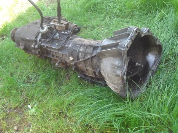

Here's some of the new transmission (1987) they're from the Craigslist ad, so can't really look at plugs unless you zoom in.

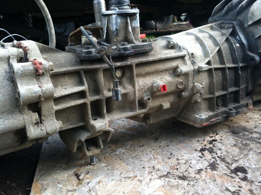

Here's a corresponding picture of the old one. The red plug is what I am worried about. About the overall length is also about 3" longer. But hopefully I can bolt my shaft on and not have axle fall too much.

The 87 and 88 used similar but different transmissions. The 87's trans will be shorter and has a different hookup for the clutch. The shifter is also different and in the wrong position.
It can work with some modification. You need both driveshafts, and the rear has to be the right one for your body truck. The clutch line needs changed, and some floor trimming may be required. For the most part all the parts you need are probably on the truck you bought.

You need both drive shafts and a clutch line. And shifter boots, those are different too.
