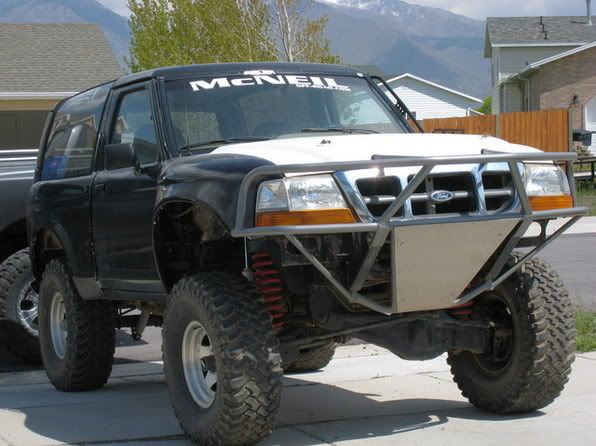

also i think that the one you posted BLACKB2 was fiberglass, pre-runner style fenders that either a guy, or company made to specifically fit the 1st gen, while using a 3rd gen hood (because the hood lines up, even the hinges)
+1 on it being an explorer.
yeah it is an explorer....never said it was a ranger clip. it is 3rd gen RBV, onto a 1st gen RBV

Yes, that pic above is from Utah, the guy was in Pleasant Grove. I don't know what ever happened to that prerunner BII.

Saw a swap done, check out the link in post #4 in this thread.
I read that link, looks like he used a 3rd gen fender to begin with, and then just spliced in the explorer front 6" to use that header panel
so i wouldn't say "swap done" he didn't put a 3rd gen front-end onto a 1st gen.....he put a 3rd gen front end onto a different 3rd gen
