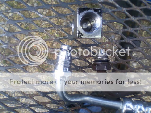

So ive searched around and saw how other people have connected there p/s lines to the gm P style saginaw pumps but they all had this adapter block.
the trouble with the gm pump is it is an inverted flare connection, while my pressure line is not. it screws in just fine, but it doesnt seat, so it leaks like an Em Effer.
I looked around for a 14mm inverted flare male to 3/8 x 18 female adapter so I could screw the 2 together but alas, no such luck.
i was informed through other threads that the 1st gen ranger ps line is the one I want, but you also need that square block. ( shiny one is 1st gen) that is another type of adapter I could not source out. its a banjo bolt connection to a ranger inverted flare connection. I bought it that line and will soon be returning that line. I have the other type of connection shown in the picture.
91 ranger p/s line to 85 gm saginaw pump
so what did I do? I put to use my welding skills, thats what.
I unscrewed the female end from my seized ranger ps pump and cut the threads off were the tiny little hole is. and beveled the lip just a tad. then I unscrewed the saginaw connection and cleaned off every trace of oil from everywhere relevant. the ford connection sat perfectly in the threaded female portion of the gm fitting. I screwed the spare male end of the ranger line into the female and stuck them both in the hole, giggity.
then I tig'd everything up slowly as to not add too much heat and eff up the threads on the gm side. jobs done.
I now have an inverted flare gm connection that will accept the ford male end of my ps line. now we will see how well it holds.

Awesome job but seems like a lot of work. I just took the 2 ends down to the local Hose Barn and had them make me a line the length I wanted for $20.
I'd love to be able to TIG like that though.
thanks. start to finish was about 20 min. most of that time was waiting for it to cool down enough to weld more. total cost, nearly free. I did have to buy the pump, but everything else was laying around gathering dust.

Why...? Guess you didn't come across my posts...
85 F-150 302 4x4 high pressure line.
Most parts stores have it in stock.
You have to tweek the bend on one of the steel lines, but it fits perfectly.
You know, I did read your post, but after I bought the 1st gen ps line and found it didn't work with out the adapter. I guess I thought eff it, I'll just build it to suit my needs now, instead of trying something else. Thanks for the info, hope it helps out some one else when they research this topic, and they aren't has impatient as me lol.
