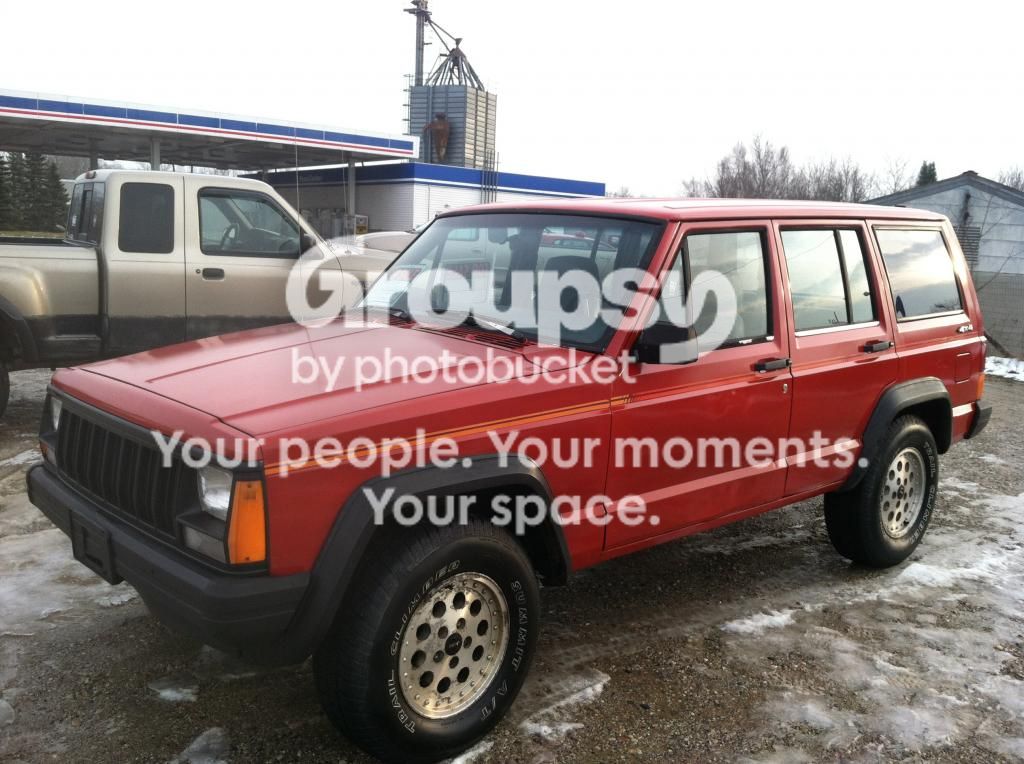

So here is the project Cherokee i picked up back in December. I decided that i wanted a wheeling rig with higher (more comfortable) passenger capacity then my ranger had to offer. I originally wanted to track down a 2-door gen 1 exploder (with the shorter wheelbase) but it was too hard to try and track down a semi-clean gen 1 explorer deep in the rust belt. I got tipped off that there was a clean XJ (out of state rig) so i went for a test drive and then had to own it.
First inspection
The day it came home. Specs: 4.0 H.O., AW4, NP231, Non-ABS D30 front, 8.25 rear end, and 3.55 gears.

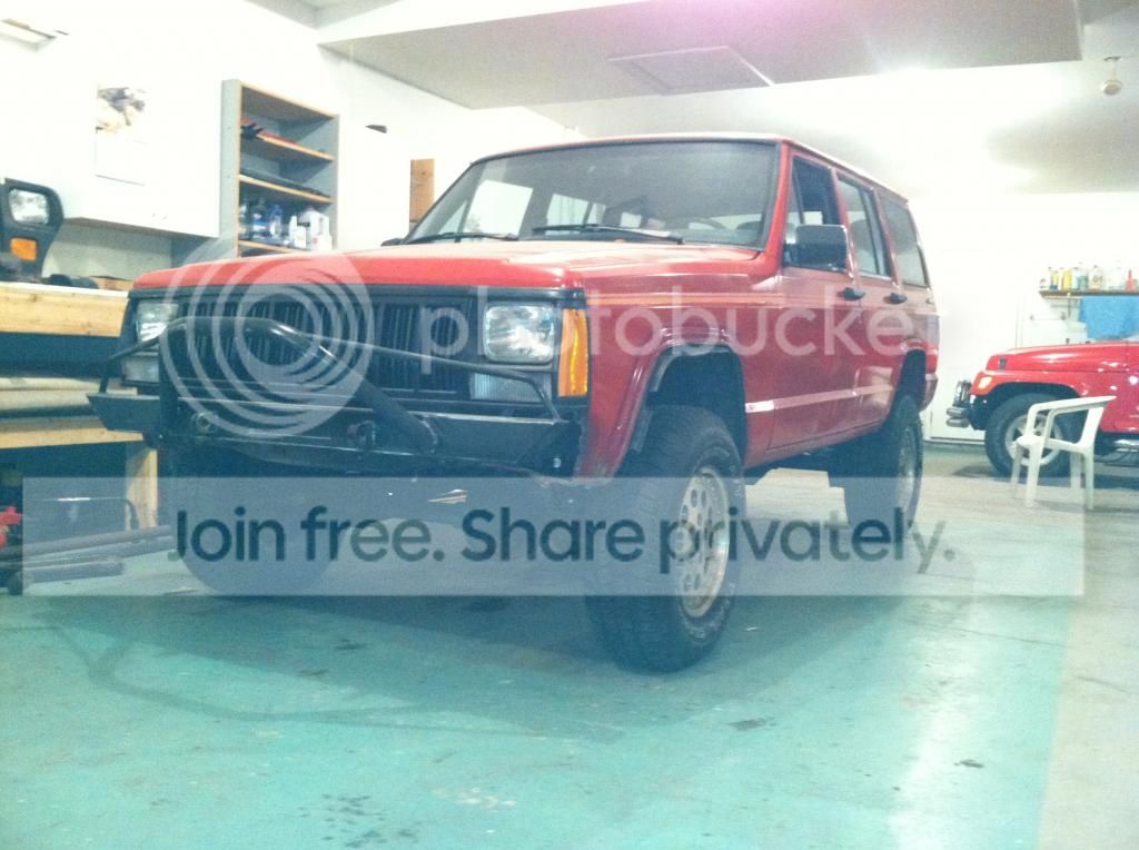

Soon after i found a pair of homebrew bumpers on craigslist for $150 so i nabbed em.
So after some time with a wire wheel and some sandpaper i repainted the rear and tried it on.
I got the front on as well-but im going to take my time strengthening it and welding in support for a winch mount.

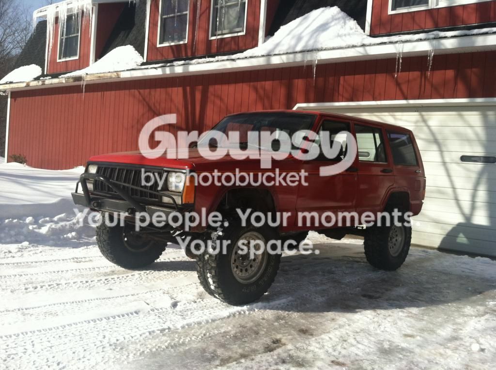

Back on the ground
Once set back on the ground i noticed it had a pretty serious rake. Partially due to new springs not being broke in yet, and partially due to a mostly empty fuel tank....either way i didnt like it. So i ordered new 3/4" lift pucks for the front.

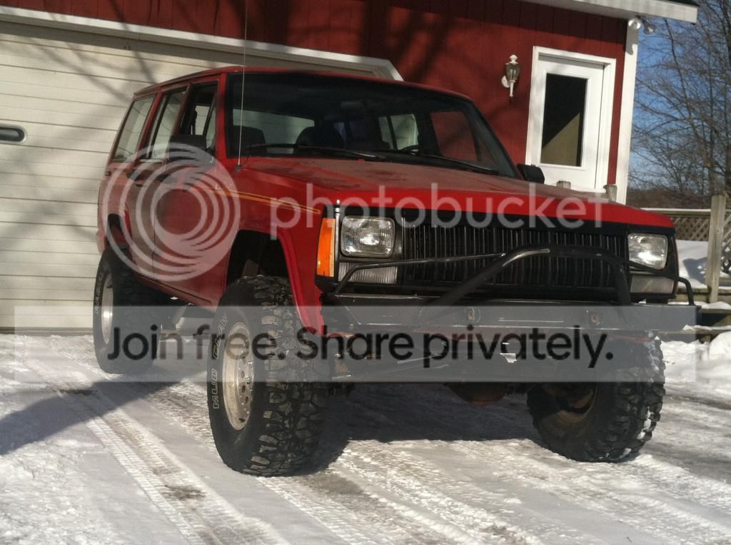

new/used craigslist rubbers. 32x11.5 "Mud Claws". I got the set of 4 for $100, so not entirely perfect-but it was a good-cheap starting point.
While I was tearing apart the front to install the coil spacers, I installed some new break hoses for extended travel (stock ones were maxed) As it turns out a stock YJ break hose will give an XJ 3-4" of extra hose while maintaining a nice sub- $20 price tag.
Then i got the New/used tires mounted up on some freebie 15" aluminum Ranger rims (slight offset on a jeep).
Up on the new tires.
