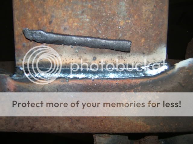

looking for criticism, welding
One of the best things you could do for your welding skills is take a night school class. You may be able to use your welder at class if it's portable. The pics I saw look alright but it is hard to tell from here. Cut some plate 2"x4" and weld them together. Then put them in a vice and hammer them back and forth, bending at the weld. When it breaks;
At the weld-no good
Beside the weld- good
You want to look closely at your welds for signs of under cutting, especially when welding two pieces at right angles.

I'm not much of a welder either but the 2nd set of welds on the 2nd steel plate don't look too bad. The thing to do is go slow, you'll have to play with the settings on the welder for feed and amperage rates until you get it dialed in and get perfect welds. I let someone borrow my welder who promptly moved and took it with them luckily it was a harbor freight model LOL, still I am without a welder.

Now that I have an idea (through your comments and others), I'm going to cut through my welds some time soon and see if I got good enough penetration. I actually have my doubts.

You will get better with practice, I see a lot of potential with what you took pictures of. 7014 is a drag-rod that doesn't get oscillation. Point it back at the start (nominally 60* angle or so), and drag in a smooth, slow, straight line. The weld shouldn't be more than 2-3x wider than the diameter of the rod (not including the flux coating). Just let it burn itself and keep pushing it into the weld pool. You will get a lot of spatter and have defects if the arc length gets too long.
You know when 7014/7024 is welding right when you can set the stinger down on a plate, and the rod will burn itself into a damn good weld, then a few minutes later the slag will peel off in one big chunk.
This is why I loved using 7014 rods. I loved just being able to drag them and there is no better feeling than when that slag starts to peel itself off a perfectly-laid weld.
^ That is exactly what happened here:
I used to impress people in school doing that. Little trick i found on the internet. Also, if you buy 7024 for whatever reason, tge 2 means it is a flat-only rod. It CAN be ran downhill (i've done it) but the welds dont penetrate. For a 70k rod, you'll find better use of 7018. But... they must be kept sealed, or in an oven. They can be ran uphill, and get oscillated. I prefer a CCCC motion.
