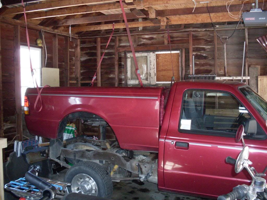

I just did this two weeks ago. I did it myself with no help. I used some tie down straps up over my rafters in my garage to hold the bed up. The hardest part for me was one of the bolts was so tight I had to take it to work and use an impact on it.

I've always done what Dune Runner mentioned. Just strap it up and drive away. It's so easy to take the bed off that I tend to take that approach more times than not. Hank, notice the new fuel filler hose in the bottom left. 1 hose clamp at the tank and 3 screws connecting it to the bed.
That's a clever hoist! I gotta do that, over here. I was expecting a block & tackle or perhaps a comealong.
