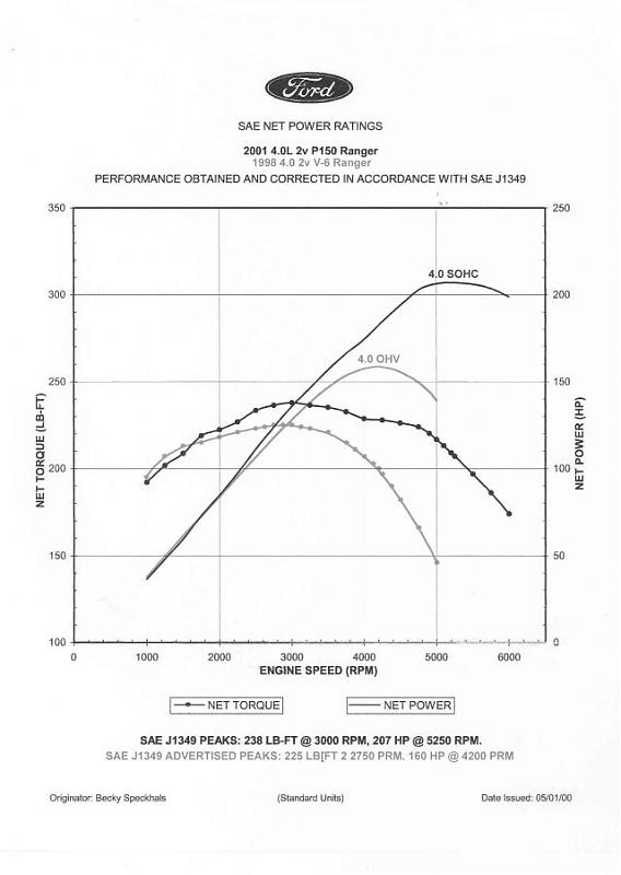

You can do some head work, swap cams, add headers etc. It depends on your application. An OHV will work better in a towing or offroad situation as it developes it's torque at a lower RPM. The SOHC makes high RPM horsepower thats helpful for daily driving, racing etc. Buddy of mine on RPS runs 14.3 Na, 13.4 w/ nitrous with a 4.0L OHV in a 91' ranger in the 1/4 mile.

Well, if you look at the comparison--really the curves cross at 1600rpm, are parallel to 2000 and the SOHC leaves the pushrod motor in the dust. Below 1600, there's not much difference. If you tow at the Pushrod's torque peak of 2400--the Cammer makes 10ft# more torque there than the pushrod motor does. If you are pulling up to the next shift, you are revving it to 4,000 and the Cammer makes 20ft# more at 4,000. The Cammer is a better towing motor too. And the Cammer is just getting warmed up at 4000. The Pushrod plummets to its death and the Cammer goes like dammit for another 2000rpm. I like the Cammer better. Except, it's too big and too complicated for field overhauls. The Pushrod gets the job done but with much less zing.
