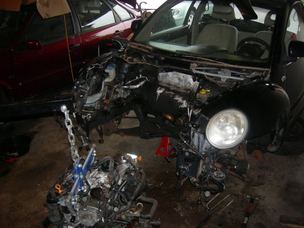

So I'll combine this truck with a 2000 New Beetle that I purchased from a fellow tdiclub member. It was in a front end accident a year prior and also thought it would be a good idea to provide a home to some field mice - I did not have a fun time removing the nest out of the dash to get at the wiring and ecu. I think I removed 3 full grocery store bags worth of carcasses, nest, feces...yuck. I unfortunately do not have a shot of the car in its natural habitat but it was stored up in the pines on the back 40acres of a friend of a friend.
Here it is during the drivetrain removal:
The front end accident did a number to the car destroying the header panel, radiator, fans, condensor, power steering pump, accessory bracket, passenger motor mount. Because of this last one it actually shoved the engine into the firewall so hard that it snapped off the intake and of course the little mount ear off the back of the block. No big deal as I'm not using that for my mounts. The car also donated a number of parts to the Passat sitting next to it.
